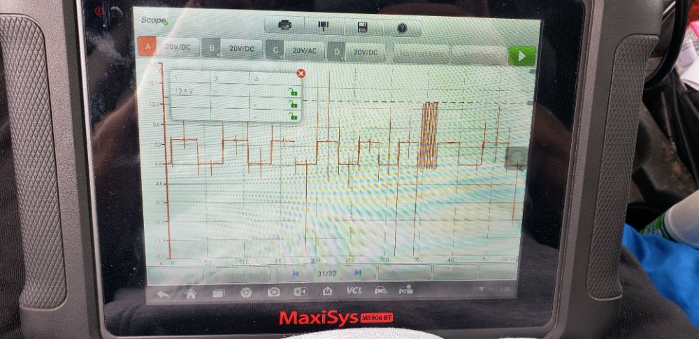

The vehicle would only 1st die in drive or neutral when it is actually moving. I did a software update to address the P0335 (CKP) and it will not die anymore. However, I keep getting a P0344 (Camshaft Position Sensor Bank 1 Sensor 1) code. There is only 3 wires: 5vdc, ground, & signal wire. I keep getting a 13.4vdc spike in this circuit while only the vehicle is in motion and I rev the engine up. I will have to check for a short to voltage. Very weird that it only happens while the vehicles is only in motion.

Cam picture.
