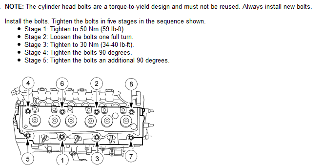

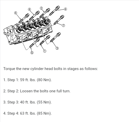

Does anyone have torque spec for the cylinder heads? And order to torque them

4 years 10 months ago - 4 years 10 months ago #52040
by juergen.scholl
Replied by juergen.scholl on topic 2000 ranger 3.0 manual transmission
There is an error in the FSM, step one should read 80 Nm instead of 50 and step three 55 Nm. Number 4 and number 6 seem o be inverted as well, for the tightening sequence you may better refer to the second picture.

4 years 10 months ago #52049
by Matt T
Replied by Matt T on topic 2000 ranger 3.0 manual transmission
There is obviously something wrong with the torque figures. Nm should be higher than ft lb not lower. Tightening sequence also looks suspect.How'd you find that, Juergen?
- Posts: 6129
- Thank you received: 1545
4 years 10 months ago #52050
Replied by Tyler on topic 2000 ranger 3.0 manual transmission
Right, I got that. :silly: I was more interested in knowing the sources for both specifications. As in, was one from Mitchell, another from AllData?There is obviously something wrong with the torque figures. Nm should be higher than ft lb not lower. Tightening sequence also looks suspect.
