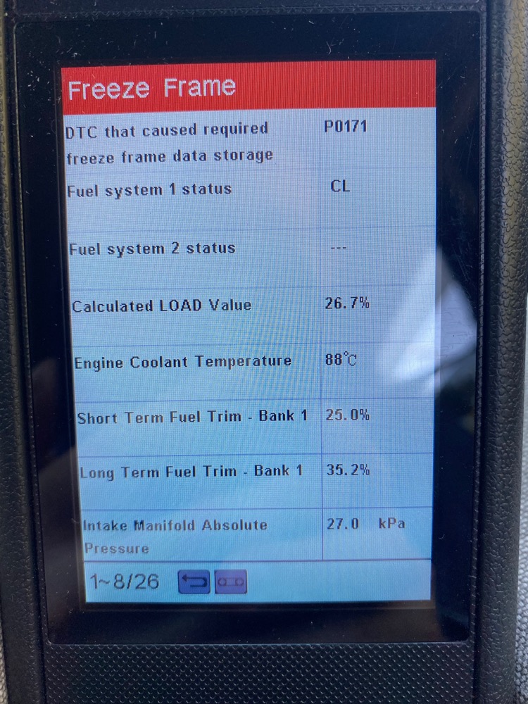

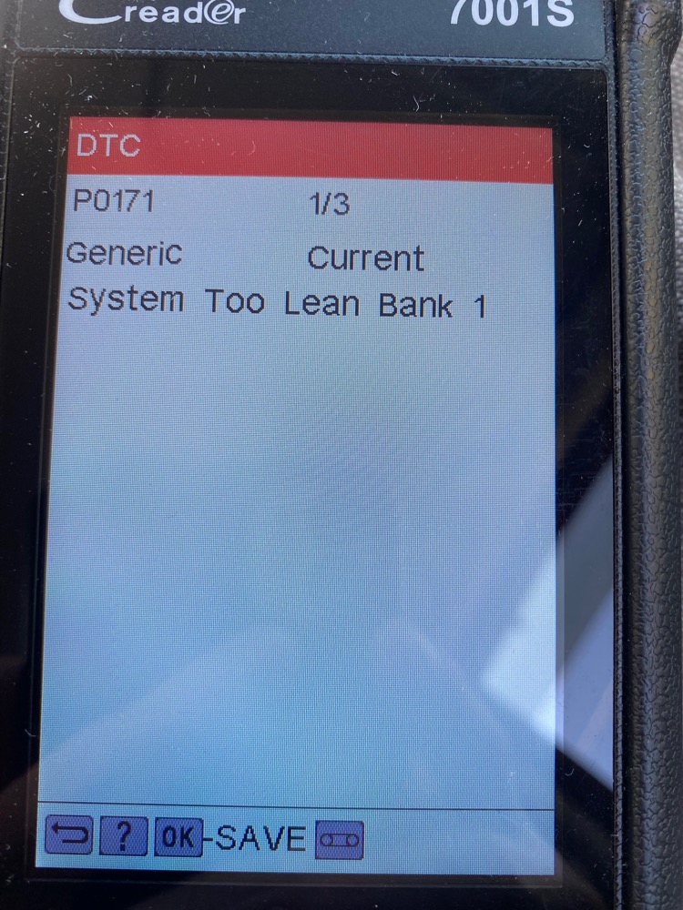

Hello All
I have a 2010 Honda CR-V (4 cylinder 2.4L engine) and I am having a lean code on the car, short term fuel trim is 25% on bank 1 and long term fuel trim is 35.2%.
I would like to know from you guys what I should test first. Vaccum Leaks or Fuel Pressure? (I don't have a fancy OBD2 that can give me the fuel pressure from the rail)
Let me know your thoughts.
Thanks

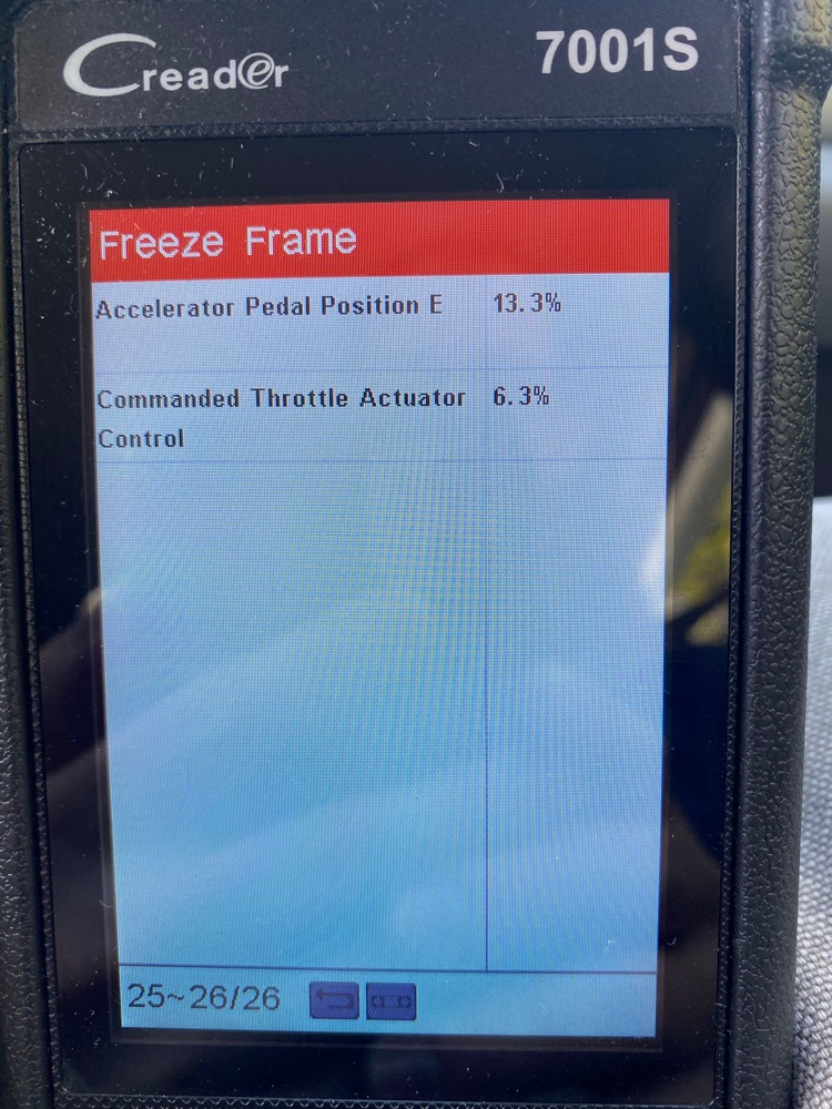

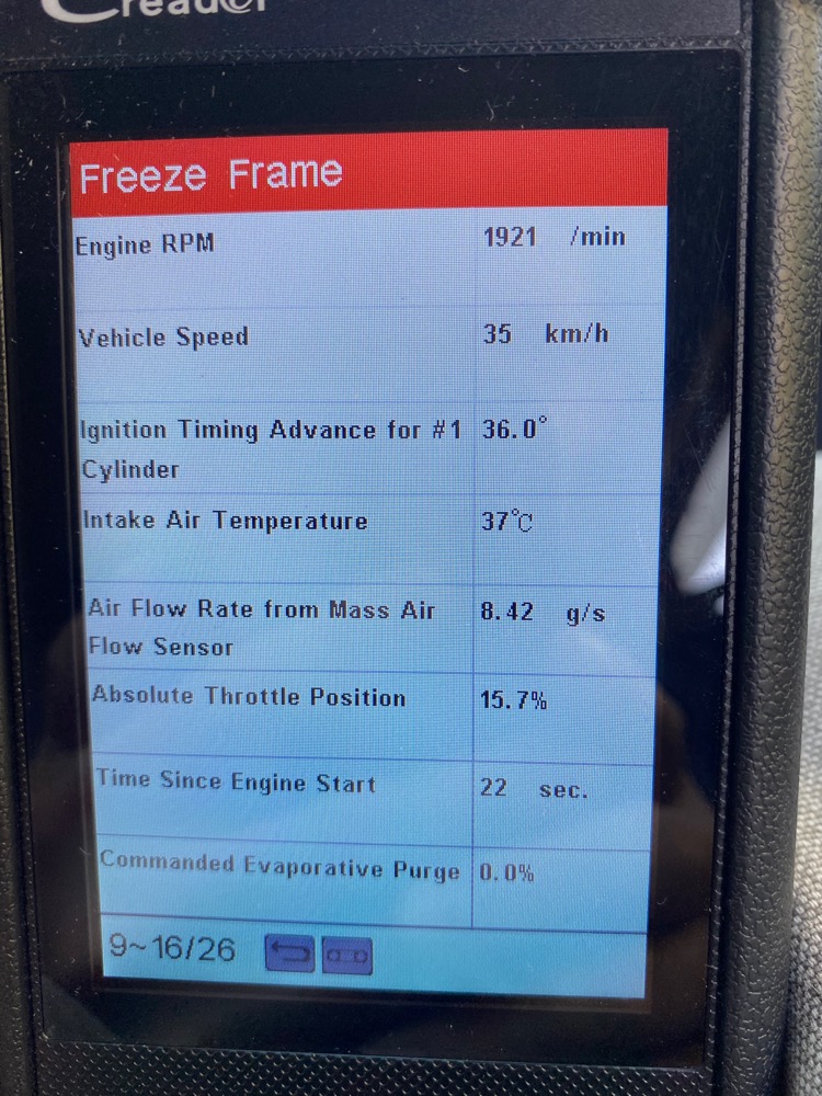

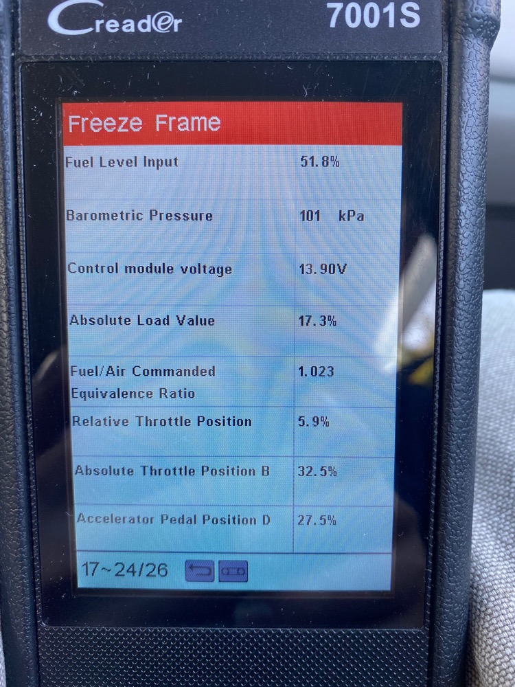

Thanks for providing the freeze frame data.
Shouldn't need a fancy scan tool for this one - your C-reader will likely be just fine.
Given that the code set off idle while driving down the road, I wouldn't immediately suspect a vacuum leak. I can count on one hand the number of Honda/Acura vehicles I've seen with bad fuel pumps.
Doesn't mean it can't have a fuel pressure problem! It just isn't very high on my list of suspects.
I'd be more suspicious of a torn intake boot or debris on the MAF sensor. Both can be checked visually with a little disassembly.
If you're interested in learning some fuel trim diagnostics, I'd suggest watching engine speed, MAF g/s, MAP, short and long trims and Absolute Load. Do this while idling, driving down the road and during a WOT run from a stop into second gear. The trim behavior, MAF and Load readings will help you narrow your list of suspects.
