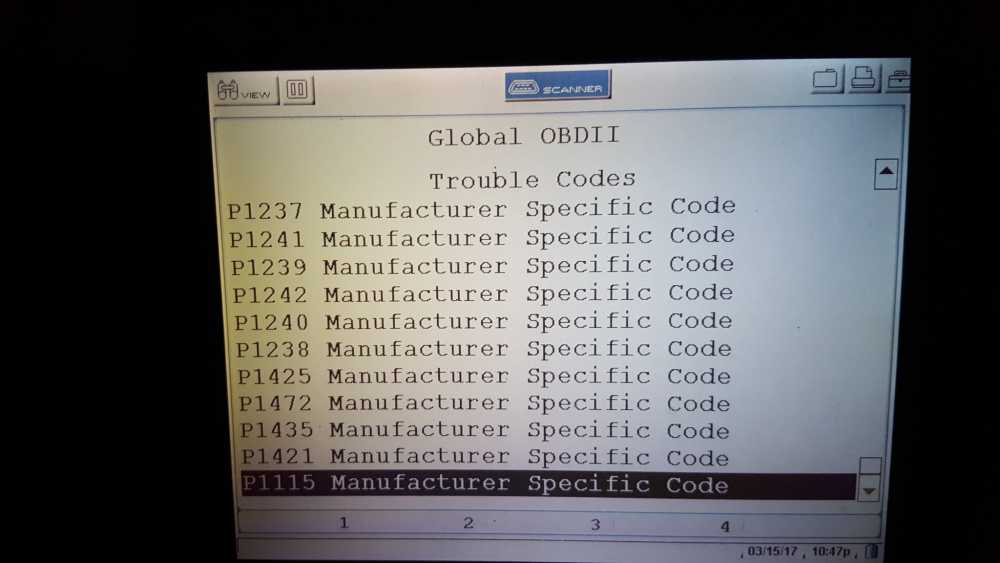

Where to start? Rough Idle.

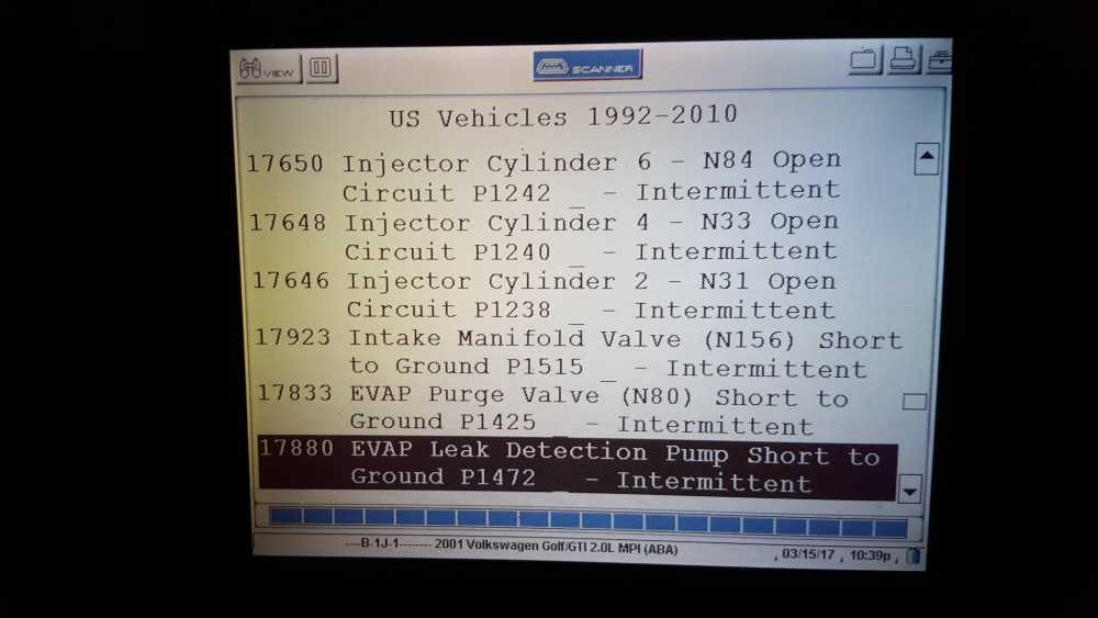

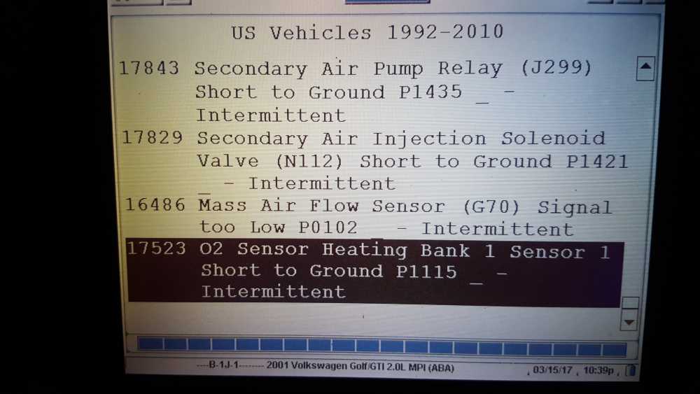

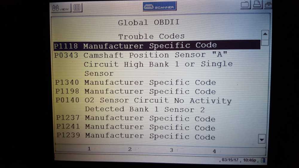

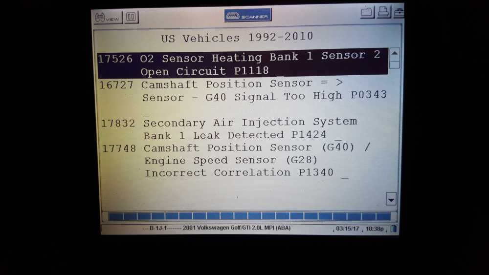

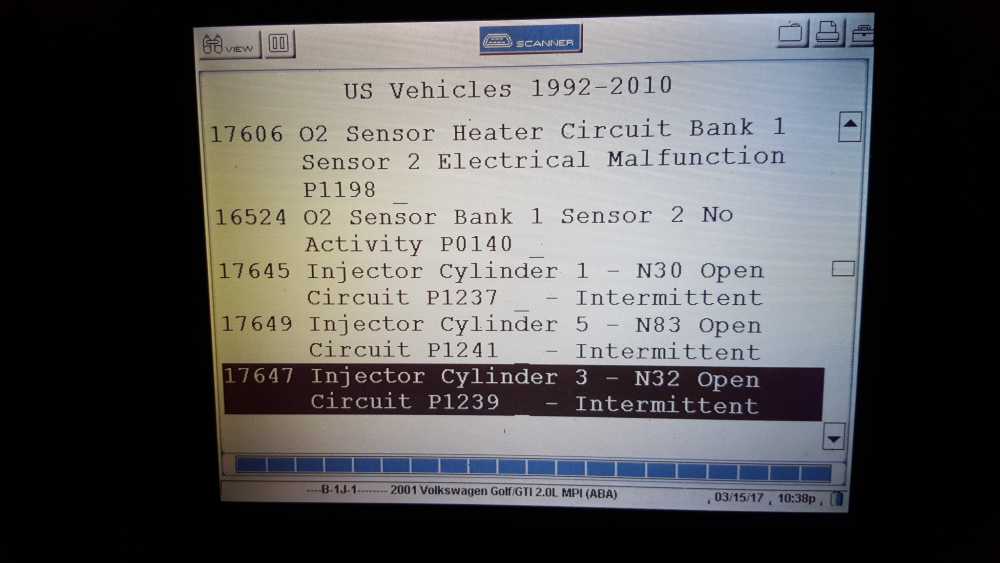

Wow you have about every code in the book! I would look into that timing correlation code may just be a faulty sensor but if you do have real timing issues you'd be wasting your time doing anything else . I would ignore your injector codes for now. And I would also look for a vacuum leak and I would guess that's your idle problem as well as your maf code . Can you view live data ? Data would be more helpful then codes for this if you can capture all the data your scanner will show at idle after engine has ran for atleast 15 minutes

Since you have all the codes stored (attached here) clear all dtc's and see what reappears. You could be reading dtc's from the past.
