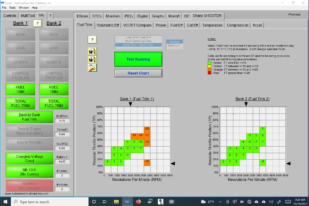

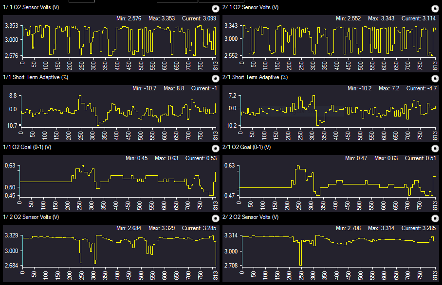

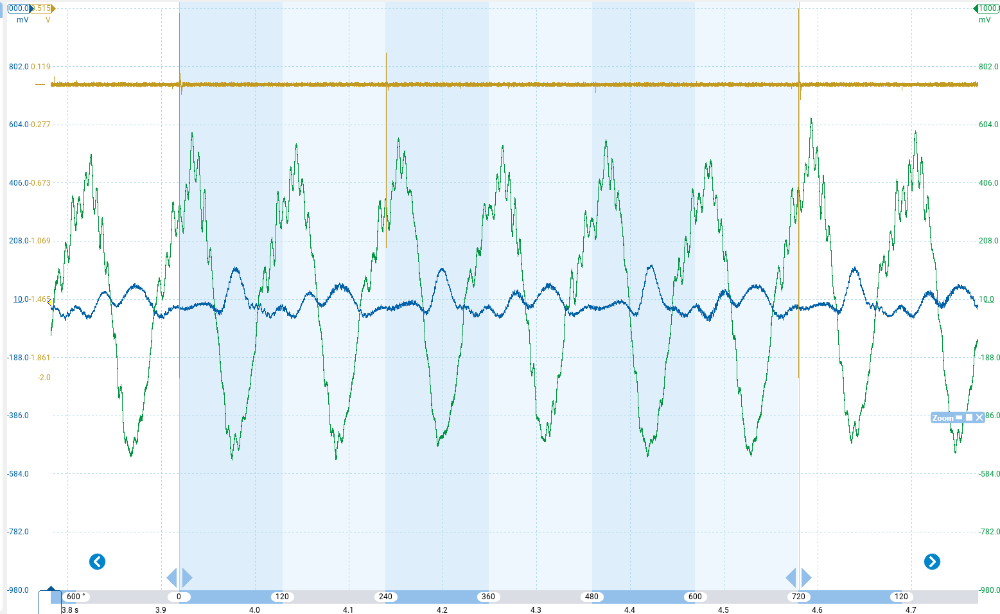

I have a 2012 Chrysler 300 3.6L. Customer complaint is CEL and a fuel smell during acceleration. Only codes are P0420 and P0128. This car came from a local muffler/brake shop. New Catalytic converters were installed "about a year ago". Could a Cam/Crank variance of 4° to 5° (4° by pids, up to 5° by waveform) cause an extremely rich condition, on one bank, during heavy accel?

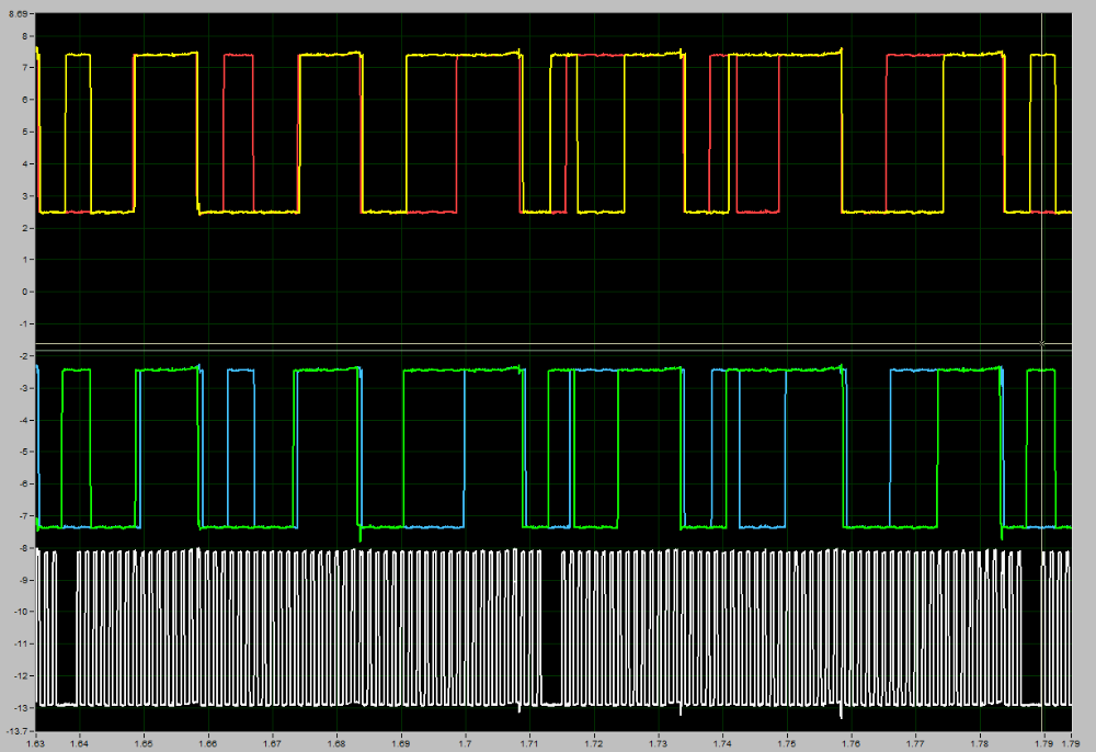

3 out of 4 cam/crank difference/variation pids show -3° to -4°, at idle. Bank 2 exhaust is close to 0°. All cams seem to phase, as they should during a test drive. I observed the Bank 1 Upstream sensor hanging around 750mv to 850mv, at idle. It looks like it is trying to switch, but is stuck in the RICH range.
Bank 1 Yellow is Upstream. Red is Downstream.

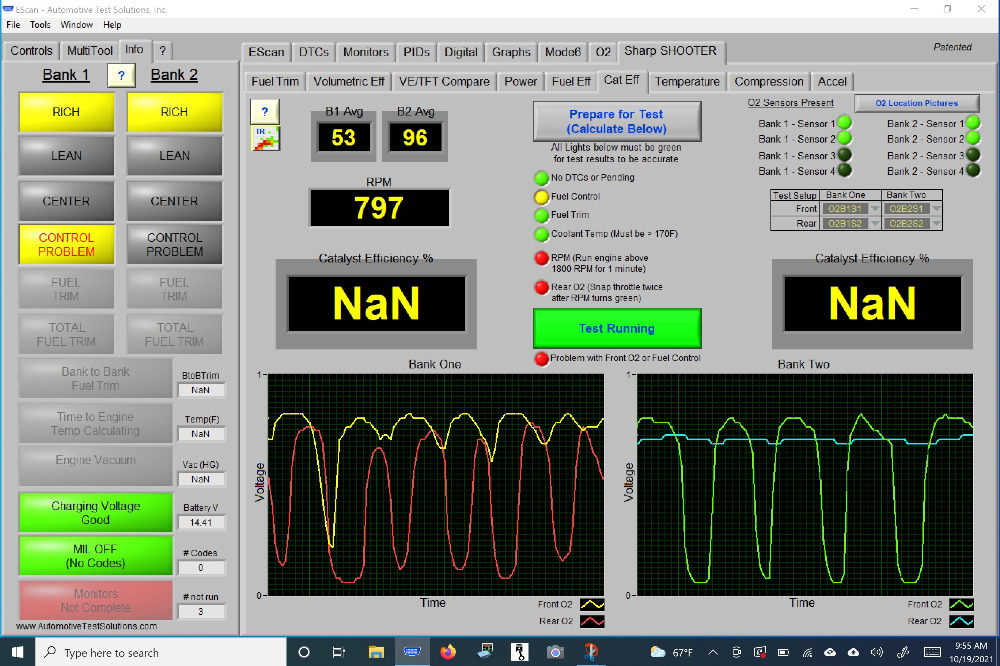

The Bank 1 Downstream sensor will begin to cycle like you would expect the upstream sensor to cycle, while the Upstream sensor is stuck RICH. I checked and the connectors are not reversed. Inducing a vacuum leak drives the sensor lean, momentarily. I called the Upstream sensor "lazy" and shotgunned a new sensor at it. No difference (re-installed old sensor). I stuck a pulse sensor in the tail-pipe and intake. I can see a distinct Bank-to-Bank issue in the exhaust waveform.
I compared Cams and Crank to a Known Good. They match up pretty well, I think. Only a few degrees of differences. I have seen worse. RC looks good, in my opinion. This vehicle runs great, with the exception of the fuel smell during accel and poor fuel mileage. No chain slap/rattle noise. I would recommend new chains, just based off of mileage (157,000) but, I want to be sure I get to the bottom of the P0420. Exhaust back pressure is 1 1/2 psi @ 3000 rpm.
Last edit: 4 years 10 months ago by Chad.

Chad,
I don't think a 4 or 5 degree deviation on cam timing is possibly the root cause of the P0420.
From your description I understand that the upstream sensor on bank one is reporting a truly rich condition. The O2 sensor detects the condition, nevertheles at higher rpm/loads the pcm isn't in fuel control anymore.
While running "a year or so" with this issue the replacement cat got damaged. Do you know why the previous converter(s) was changed, same reason? The underlying cause was rich running and was left unaddressed so it repeated itself?
If the scan/scope data shows similar injection on times for both banks you may want to compare the pressure drop of the injectors from bank 1 to bank 2 or switch them bankwise. They may have different flow rates.
Your pressure pulse reading seems to be taken cranking, do you observe the same difference in exhaust pulses at idle as well? Could the design of the exhaust system contribute to the bank to bank difference?

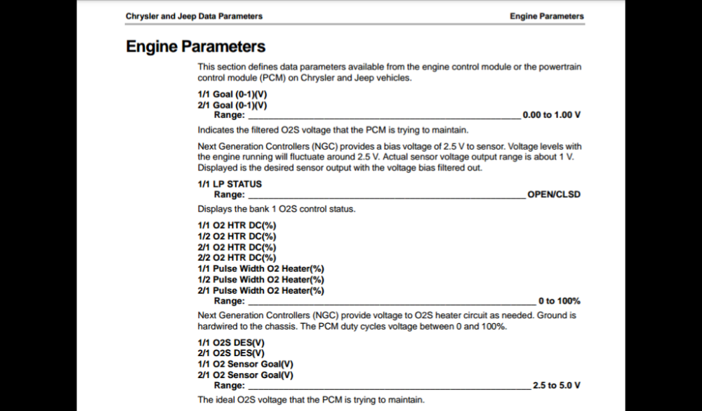

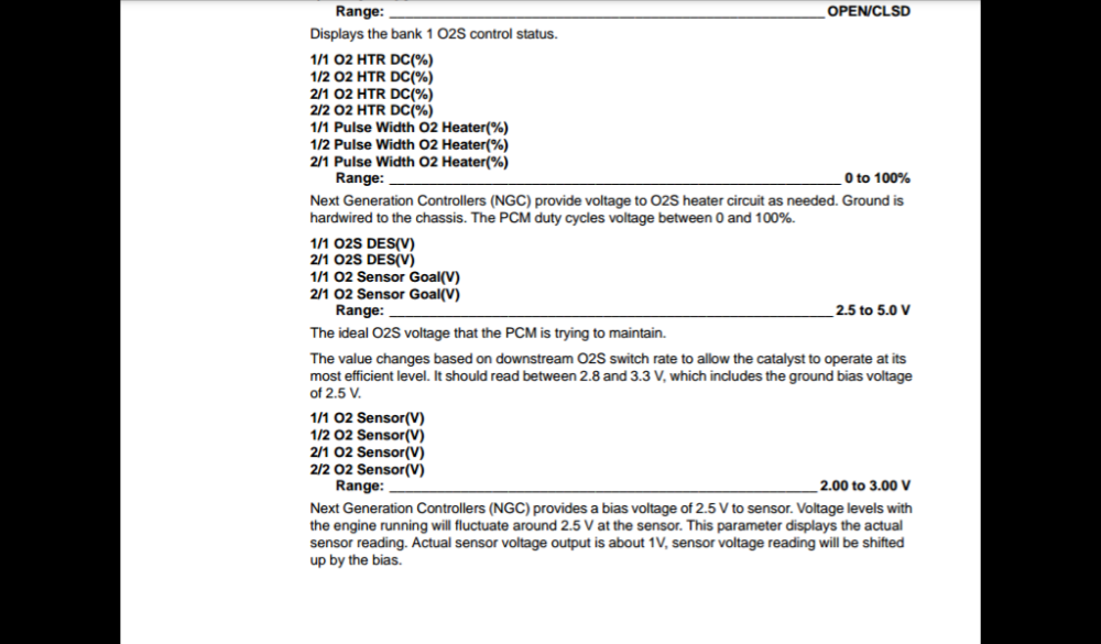

When I see CDJR O2's behaving the way yours are, I immediately suspect an exhaust leak and/or a malfunctioning downstream O2 sensor.

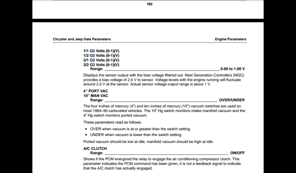

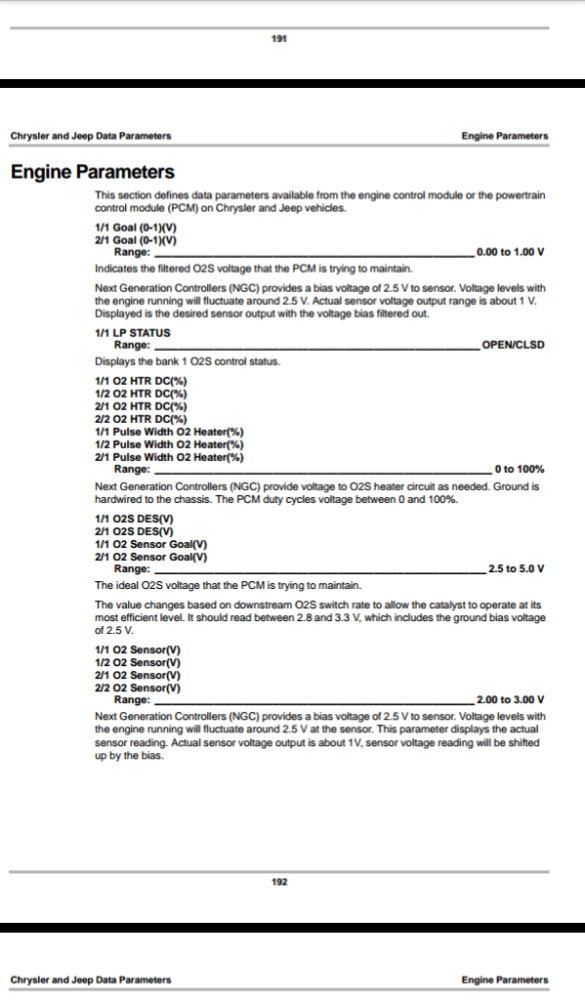

Do you know what the O2 Goal (0-1) (V) PIDs are reading on the manufacturer side? I suspect they're part of the downstream fuel control strategy. A large difference bank-to-bank might suggest an exhaust leak OR a cat that just isn't storing oxygen the way it should.
  • Chad's Avatar Topic Author
4 years 10 months ago - 4 years 10 months ago #52221 by Chad
Replied by Chad on topic Cam timing causing a P0420?
Good timing, Tyler. I was just about to cut the cat out, to eliminate it from the equation. Good call, too. I had not paid any attention to the Goal pid.
B1S1 goal is .750
B2S1 goal is .570
So...now, I need educated. Why would the Bank 1 goal be .750?
I know that the cat is bad. I have been tasked, by the muffler shop, to determine the cause of the failure. They just installed them (aftermarket), earlier this year in March.
The manufacturer is refusing to warranty, claiming there must be an underlying issue. At this point, I feel like I am chasing a ghost.  I am going to cut the cat out, and re-look at the exhaust waveforms. If the Bank-to-bank anomaly goes away with the Cat, I have to conclude that the Cat should be warrantied. The muffler shop will "eat it".

Yeah, me too. :silly: I nearly got my ass kicked by a Chrysler 300 about a year ago, and I've been watching O2 Goal on known good cars ever since. No training material or service info that I've found talks about it's usage. Just me making it up as I go.
From that '13 T+C I uploaded:
O2 Goal starts trending up around frame 200 when the downstream goes low, and the Short Term reacts around the same time. So, if your O2 Goal on B1 is high, then I'd say the PCM isn't happy with the downstream O2 behavior. Which makes sense - it's switching when it should be steady above .6-.7V. Meanwhile, the upstream O2 is trending rich. I'm surprised it hasn't set an O2 slow response code yet. :huh:

As mentioned  in the video chat the domestic vehicle pids list offers some information on the goal O2 parameter.

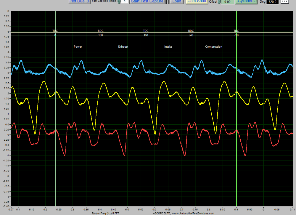

After finding nothing wrong, I cut the Cat out. The catalyst was clean and pristine. However, It was broken, not melted. There were no signs of damage, on the outside. The Cat has two sections of catalyst with the downstream O2 sensor installed in between. The upstream section of catalyst was broken. The dust from the broken upstream section was, partially, restricting the downstream section. I was surprised by this because of the Exhaust Back Pressure test. Holding at 3000 RPM, back back pressure was only 1.5 psi.  I will note that I would see it spike up to 5-7 psi, for just a fraction of a second, before it steadied at 1.5 psi. The spike was so brief that you could miss it, if you blinked. I didn't think much of it, until now. I called the muffler shop with my conclusion. They said that they would replace the Cat.  They later called me and said that they had, again, talked to the manufacturer. The manufacturer has decided to warranty the Cat. (This was the FIRST replacement Cat, installed earlier this year in March. I had speculated that it might be a second replacement, but I was wrong.)

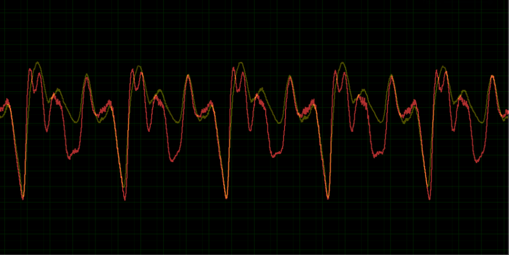

For anyone interested, here is a follow-up on the exhaust waveforms. First is waveform with a pulse sensor in each upstream bung hole, and one in the tail pipe.
Bank 1 (slightly restricted)      Bank 2
Here is a Bank 1  offset, and over-layed atop Bank 2.
The following user(s) said Thank You: Tyler, juergen.scholl

4 years 10 months ago #52334 by juergen.scholl
Replied by juergen.scholl on topic Cam timing causing a P0420?
Thank you for the update Chad.
Just to make sure I understand this correctly:
The exhaust pressure waveforms were taken with the damaged cat still in place and during cranking, at around 700 ms for the complete cycle, right?
I'd call this a VERY tough one and wouldn't dare to point at the catalytic converter just based on the back pressure waveforms...
Is there any chance you can get exhaust pressure readings once the new converter is in place? (I know, most probably not...)
Yes. Those waveforms were while cranking, with the bad cat, still, installed.
I asked the owner to bring it back, after the new cat has been installed, so that I could look at some "AFTER" data, pro bono. He said he would. I hope he does.

I'm not sure but, It is my understanding/belief that the rich condition/Goal of .750  was caused by the down stream O2 sensor cycling lean, due to the bad cat?   A Downstream fueling strategy?
That's my understanding, anyway. :silly: I think O2 Goal represents the PCM's modification of the fuel calculation to make the downstream O2 behave correctly. Values above .45V represent adding fuel, less represents subtracting. I could be off about the .45V value? But that's what I usually see. Why didn't they just call it 'downstream fuel control' or 'post-catalyst fuel trim'? Because Chrysler, that's why. ;)
IMO, part of the issue is that the PCM *assumes* a working catalyst when making changes to O2 Goal. Evidently, even when a P0420 is set, the PCM will still crank up O2 Goal to get what it wants.
