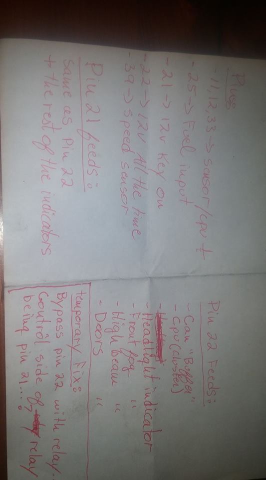

Cheked the way cluster recieves fuel level input: From ProDemand: Cluster receives fuel level directly from sender( Direct Line) I assume the cluster cpu varies the needle based on internal algorythme.... But one thing for shure it does not pass through the can line.... Speed input is not an issue on this case because Odometer works, trip meter also.... Here is a picture of a resumé of pins, as well as a temporary fix i thought of based on power distribution in the cluster.... Tell me what you think.... Thanks again!!!! Sorry for the angle of the picture! ;)

9 years 7 months ago #7519 by borntoroll
Replied by borntoroll on topic Toyota rav4 2008... Got me stumped!!!!
Should work. I wonder what is the cause 2 instrument clusters misbehave.
9 years 7 months ago - 9 years 7 months ago #7520 by borntoroll
I would also add a diode to minimize potential problems with flyback voltage.

Changed cluster again today... Redid all the tests... Asked the custommer to keep me personnally posted on the outcome.... Suggested her the by-pass fix if all else fails... Hope this time is the good one!!!! Thanks guys!

9 years 7 months ago #7725 by Noah
Replied by Noah on topic Toyota rav4 2008... Got me stumped!!!!
Man, what a job!
I was thinking along the lines as Tyler, although the diagram shows that the sender connects direct to the gauge, there must be some kind of built in slosh regulator to keep the needle from swaying around while driving. I couldn't find any info about that though....
The slosh regulator as you call it is built in the cluster ecu.... Like i said in one of my posts, ecu probably has an algorythm that takes a sample of the resistance of the gage every now and then.... and inputs it to the needle.... Same strategy as all cars today.... Granted voltage is more common....
