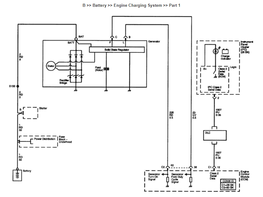

5 years 1 week ago - 5 years 1 week ago #52277 by Alex93
The engine size is 2.2L. The alternator has only 2 pins F and L. I have an schematic of the charging system I want to upload but for some reason it wont let me upload it for you.

  • juergen.scholl
  • juergen.scholl's Avatar
  • Active partschanger
5 years 1 week ago - 5 years 1 week ago #52302 by juergen.scholl
Replied by juergen.scholl on topic 2005 Saturn Ion 3, not charging while on drive
Is it this one?

5 years 1 week ago - 5 years 1 week ago #52303 by ksat22
Okay, right. The PCM supplies a 5Vdc PWM square wave to that "L" terminal. How long that 5V stays "on" as compared to "off" (duty cycle) controls how high the voltage of the alternator goes. The PCM determines what that duty cycle should be based on a bunch of factors including what that current clamp i mentioned to you earlier reads and what the "F" terminal is reporting back to it (F provides alternator feedback).
The following video (and the one that comes after it) provides comprehensive info on how the system works and how to diagnose.
I'm not sure what you're using to measure that 5V on the "L" terminal, but, as the video alludes to, a scope would give you the clearest picture of what's going on there. Using a regular volt meter probably isn't going to cut it. The same goes true for reading the return signal on the "F," The video does show how you how to use a multimeter's frequency setting to do a cursory test on the pin terminals if you don't have a scope, however.
Being able to read the PID data for the charging system would be a big help to you, as this system is rather complex and depends on inputs from a number of sources. Not having access to that info isn't much different than trying to diagnose an engine misfire without having use an OBD scanner. You're kind of flying blind.
In addition to watching the video, you may want to have your battery checked (conductance and/or drain test), clean its cable connections and one on the alternator. Checking the condition of the plug/wiring on the current clamp might help, too,
