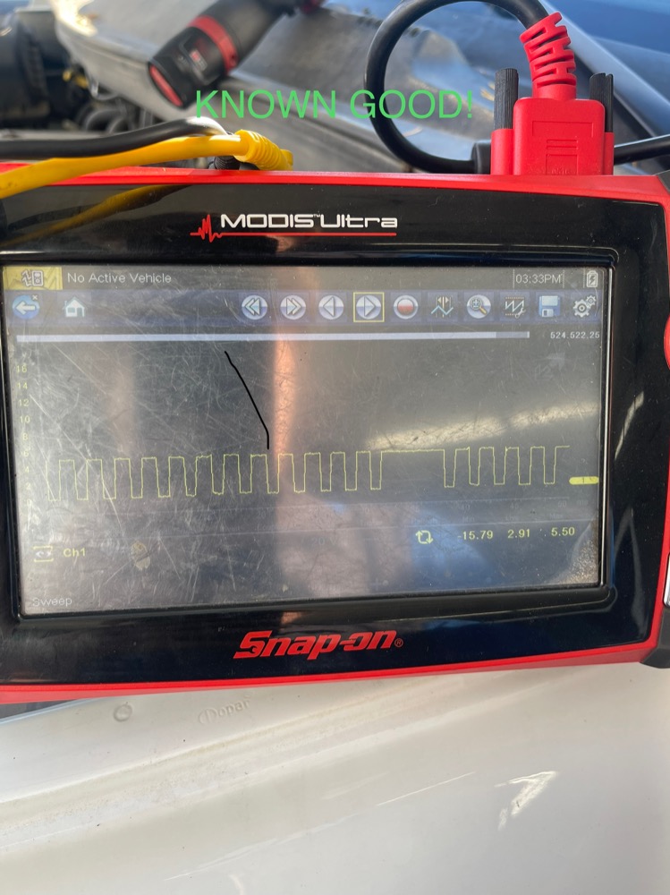

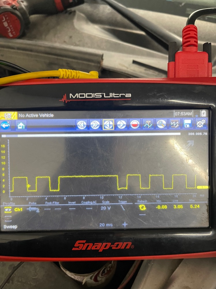

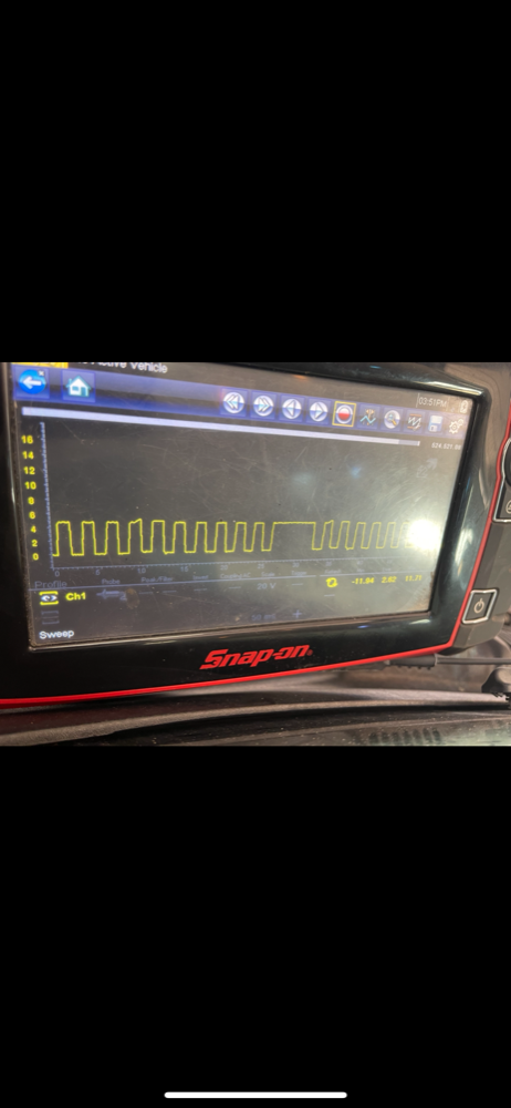

Hey y’all, got a 2001 Dodge Ram 2500 with the 24v 5.9 Cummins, keeps throwing a p0341. ECM CMP RPM on the scan tool is erratic and will fall out 200 RPMS or less below the ECM Inj Pump RPM. New to using a lab scope, trying to learn a thing or two. I have scope results from the CMP signal at the ECM on this truck, and a known good one from another 01 24v in our lot. Can anyone give me some insight on what’s going on, it looks like the some of the waves are not as sharp and smooth as the known good. Is this an acceptable scope result? Thanks in advance.

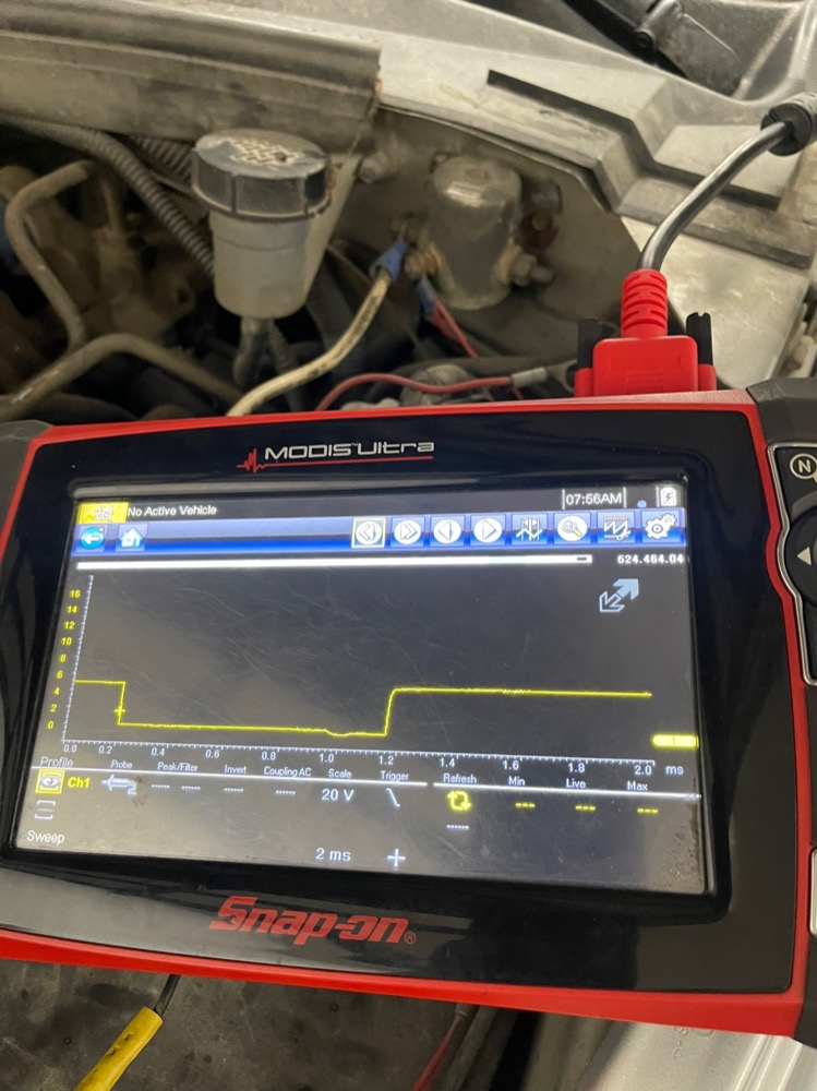

They don't look too bad as long as they don't drop below a certain level. Sometimes you have to scope it at a very high frequency to see if there is something like magnetic interference present - that would show if there are spots where the pattern drops away far enough to cause issues. A low frequency scope is like a 1 megapixel camera, it gives an idea what the image looks like but you can't zoom in to see more details.

I can give that a shot tomorrow. This scope has the capability of higher frequency, these were just the settings I used that were recommended by some of the videos I saw

Agreed a "zoomed in" capture would be better. Unless my eyes deceive me, it look like the falling edge after the weird looking tooth does not get pulled quite to ground, but someone with more knowledge than me will have the comment on the cause and symptoms of this.
