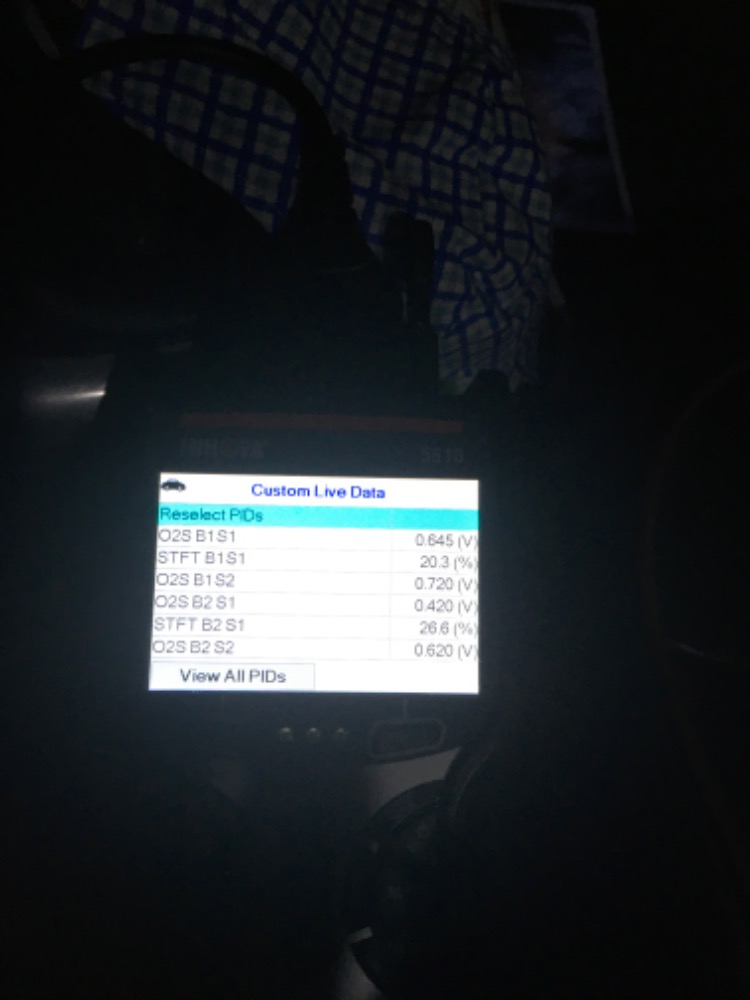

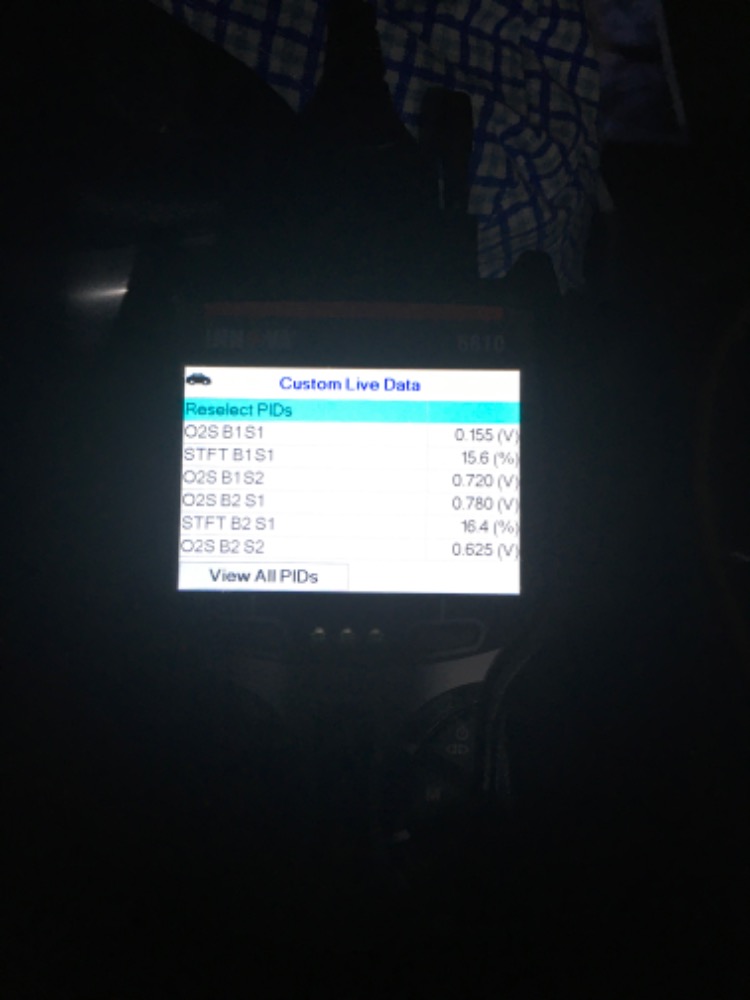

I have 2008 Hummer H3 alpha 5.3L engine
i have codes p0171 and P0174
see pics for fuel trim at idle and 2500 rpm. Just replaced injectors car has 172000 miles all new PCV hoses new MAF sensor. New O2 sensors. Can’t find any vacuum leaks or exhaust leaks. Any help would be appreciated

Is it flex fuel? What does the trims go to at 2500 rpm? What are oxygen sensors reading front and rear

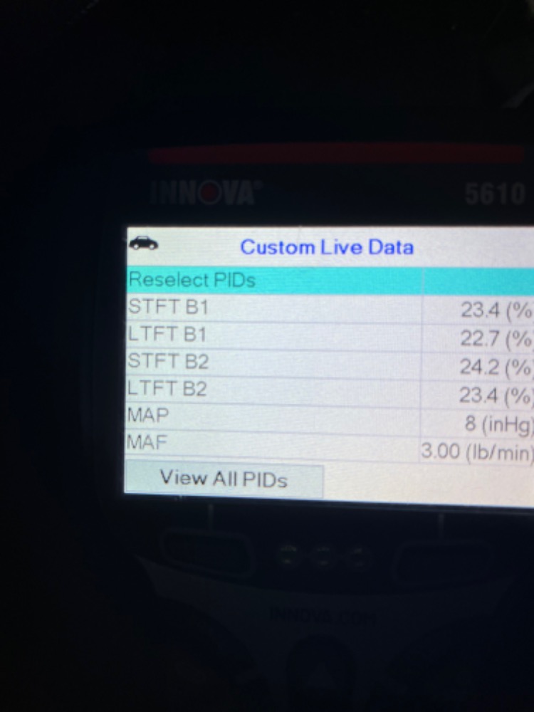

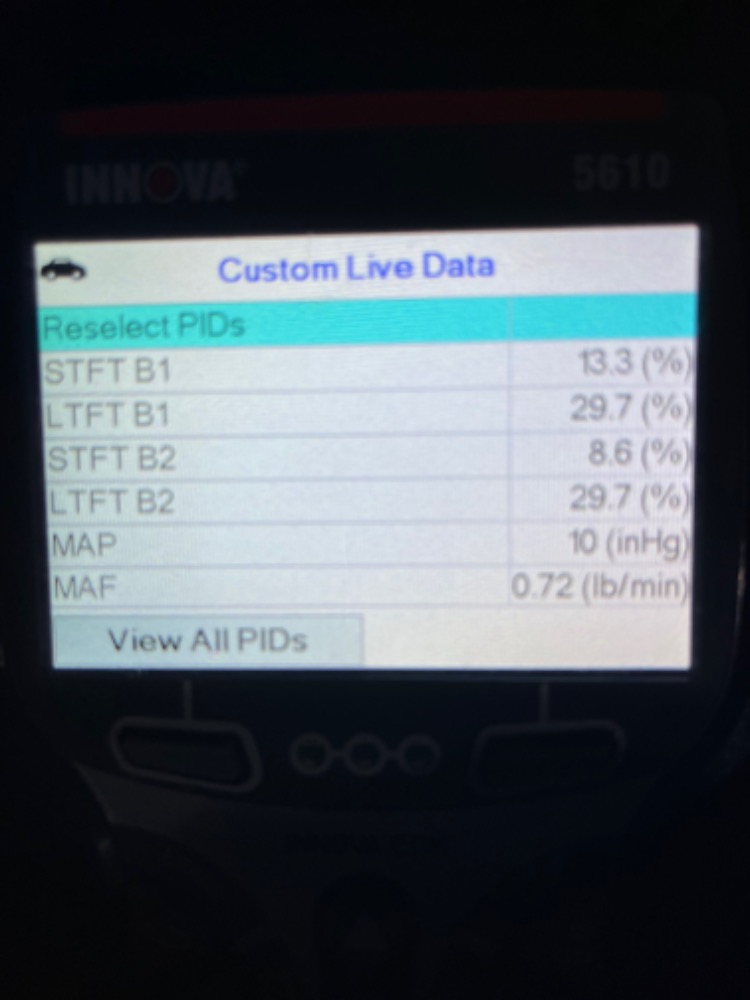

Long term fuel trim is missing in the 2500 rpm capture, for the greater picture it is important to see this as well....
Did you change the injectors because of this problem or did it show up AFTER replacing them? If the latter make sure they got the correct flow rate.
Did you check the fuel pressure and the fuel volume already?

Attached is 2500 rpm

A code for switch time refers to the O2's condition......If the lean condition evolved after the injectors were changed make sure they are the correct ones! AZ can be fatal!!!
And yes, test the fuel pressure and volume As well, as you do seem to experience a general fuel delivery problem.
