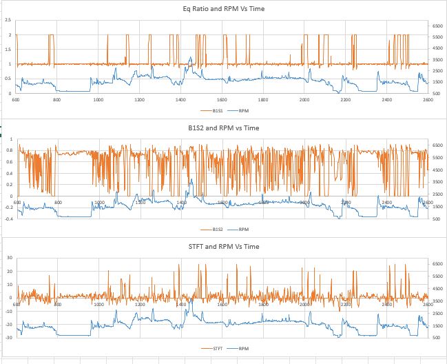

Anyway, I was wondering if the following charts of live data show an obvious issue. Is it obviously a timing issue or does it scream fuel delivery issue or something else. Thanks

Your captures seem to indicate good fuel control, but it's hard to say if there's a timing problem or not. We'd need to see the VVT PIDs for that.
Did you happen to check your Freeze Frame when P0301 or P0300 sets? If not, wait for the code(s) to set again, and see what the Freeze Frame has to say. That'll give you a much better idea of when the misfire is happening, which can help narrow our list of suspects.
Are you noticing any coolant loss?

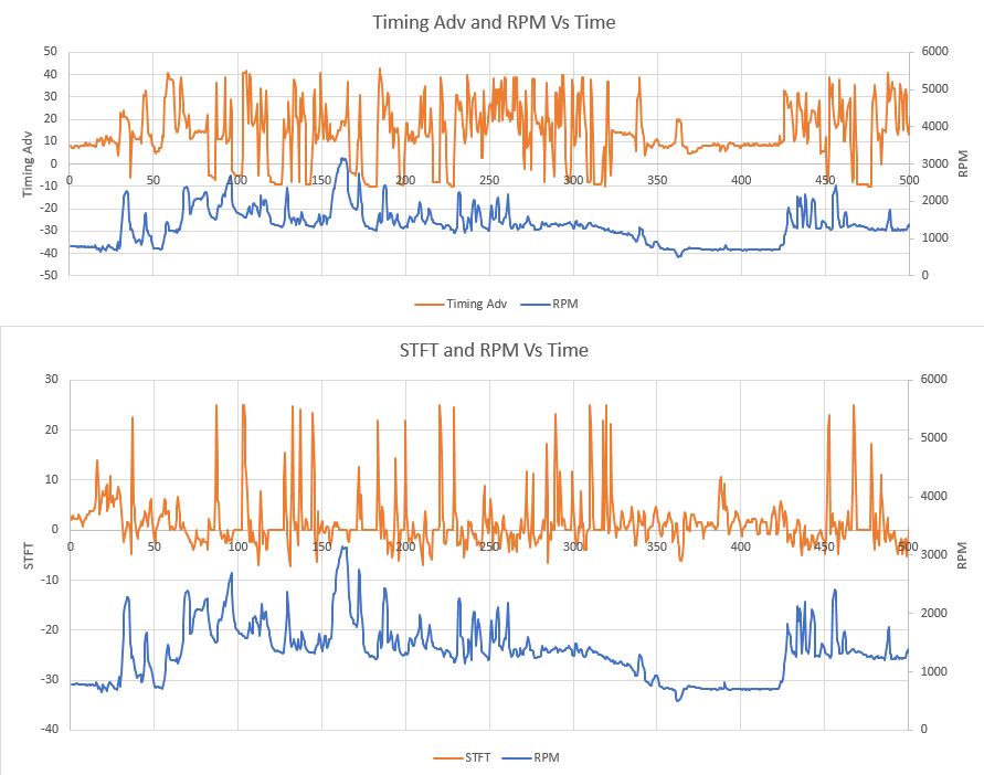

My mechanic told me the engine was “leaking coolant” but it looks full to me.Here’s live data for timing advance and stft from the same period:

Here's the timing data:

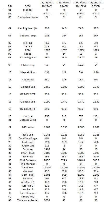

Here's some freeze frame data:

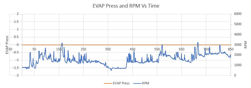

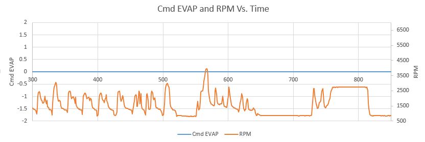

Replied by DIY JoeR on topic Altima Misfires
Here's live data on EVAP:

Is that timing PID for the camshaft timing, or is that the Global OBD spark advance PID? :huh: Spark advance would be my guess. That one won't tell us much about the actual mechanical timing.
If that is Global OBD, then the EVAP PIDs won't help us much, either. The Commanded EVAP doesn't look unusual, but the pressure PIDs are very unreliable, especially on Nissan. I wouldn't sweat an EVAP problem right now, especially since the trims are OK on the Freeze Frame data.
The good news is that the Freeze Frame data you posted (which is excellent, BTW B)) doesn't necessarily support a head gasket issue. All four are under some kind of load, off idle, at least partially warmed up, and several minutes into a key cycle.
Fuel quality comes to mind, BUT it appears you've refueled at least once between FF#3 and FF#4. If I were you, I'd be tempted to move the #1 coil and plug again. :silly: I know you already did, but ignition is still at the top of my suspect list.
