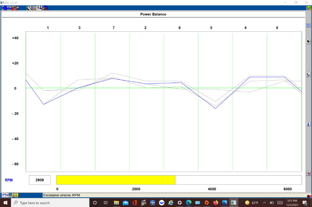

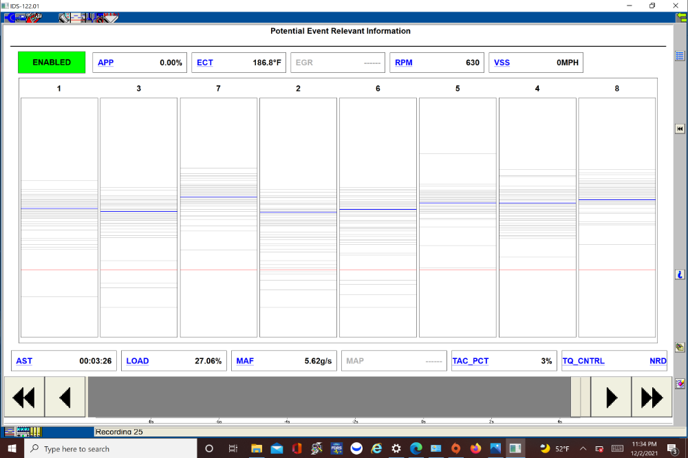

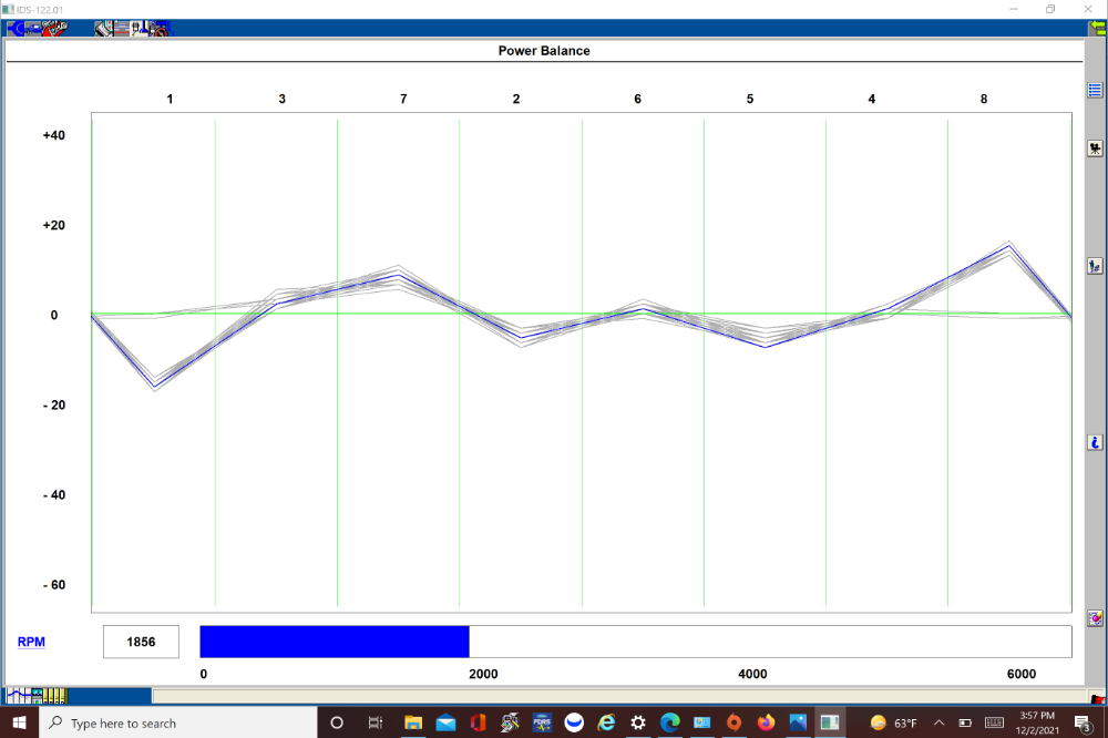

this truck is a Ford f350 5.4 2012 its a camper conversion the customer brought it in for a misfire concern she stated the misfire started when she returned from her trip 2 weeks ago I noticed the vehicle had new has tested gas for quality. and ethenol content its flex fuel. but all that seems okay while starting the vehicle I monitored power balance it seems all cylinders have misfires some more than others I perform a relative compression test all cylinders. are okay cylinder was a tad lower but within tolerance I took a couple of the plugs out found them to be white brownish and flaky I reset the gap to see if help but it did not. fuel pressure was at 60psi I performed an intake leak with smoke found nothing this vehicle on has 39000 miles when I also prezzurized the coolant system to see if internal coolant leak was found but none present . My only suspicions left are in the fuel system when i recovered fuel from the vehicle it seemed deluted clear almost any advice would be great these codes seem to always be a struggle for me I also realized that the misfires were still showing up once warmed up
the power balance images are at steedy crusing speed uphill or at load
the potential misfire chart was at idle and it did it all the way until it warmed up

Being a ford I’d put a coil and boot in clylinders 1 and 5. What are fuel trims reading??

Can the misfire be felt while you're running the Power Balance test?
I know the Power Balance says #1 is weak, but I'd still be interested in checking Mode $06 to make sure those counts agree. I've been lied to by Fords before. :silly:
Was your relative compression test run with IDS, or with a scope?
Speaking of IDS, does the Injector Balance test show an issue?
