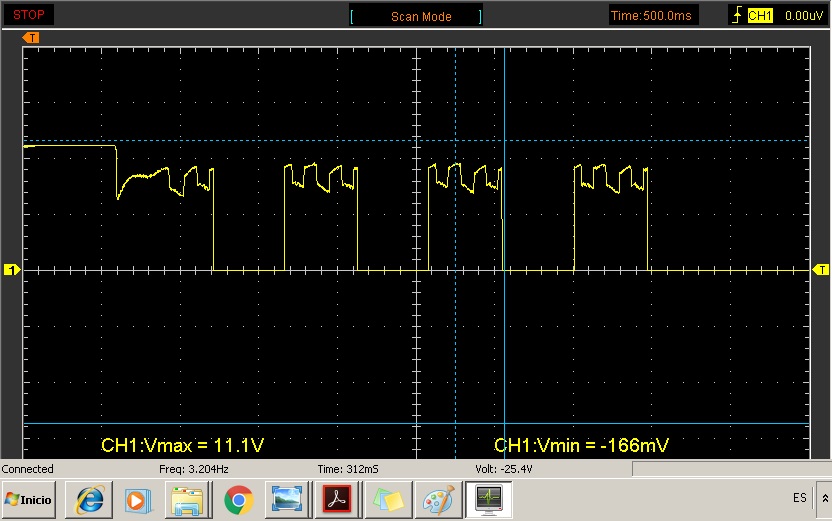

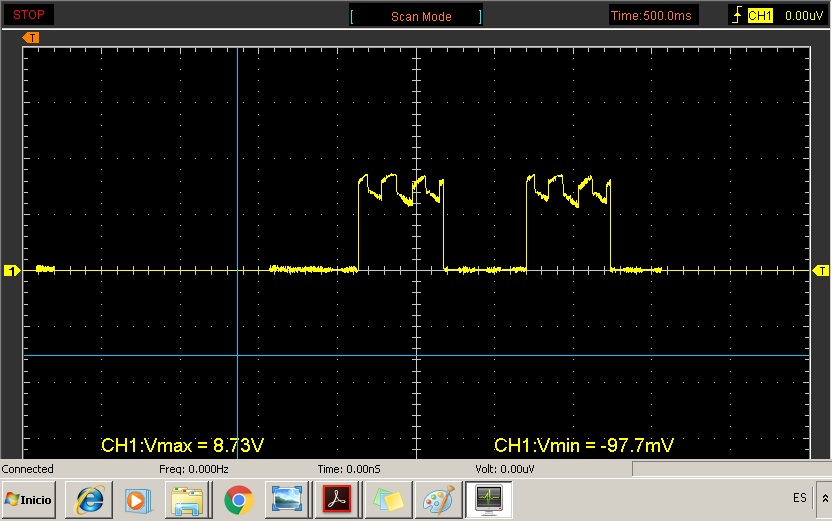

9 years 7 months ago #7580 by yhspeed
working in 99 blazer s10 . no start , it has spark and injector pulse is too short . when put my scope and check cam signal , i saw this .
what do you think guys ? it dosen`t look like a tipical cam signal

yhspeed wrote: working in 99 blazer s10 . no start , it has spark and injector pulse is too short . when put my scope and check cam signal , i saw this .
Can you capture it together with crank signal? Or disconnect crank position sensor and check this waveform again? Or check if it can run cam only or crank sensor only connected.
