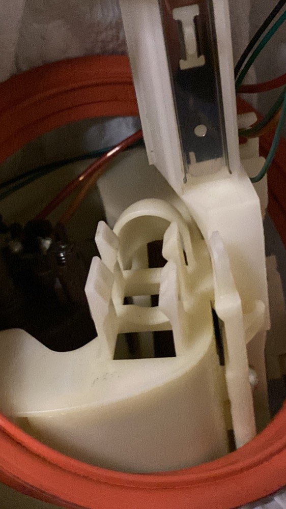

4 years 10 months ago #52992 by SamM
It is a Pierburg fuel pump I bought from FCPEuro. The hose is the straight black hose that goes into the white connector area on the pump. This pump picture is of my original pump. The pierburg has 3 white prongs instead of 2. I attached a picture showing the black hose when this was out of the car.
  • SamM
  • SamM's Avatar Topic Author
4 years 10 months ago #52993 by SamM
This is the straight black hose.
  • SamM
4 years 10 months ago #52994 by SamM
Looks like this.

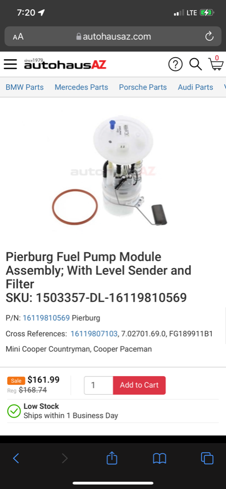

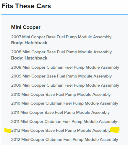

4 years 10 months ago #53016 by Tyler
I could be way off, but I think that's the wrong pump? :huh: Pierburg P/N 16119810569 would appear to be for S or John Cooper Works models.
According to FCPEuro, P/N 16112755083 is the one you want:
  • SamM
4 years 10 months ago #53021 by SamM
Yes I checked my order and my part number ends in 5083 and is for the base N16

4 years 10 months ago #53113 by Tyler
I guess I misunderstood, then. :unsure: Do 0569 and 5083 cross reference to each other?
