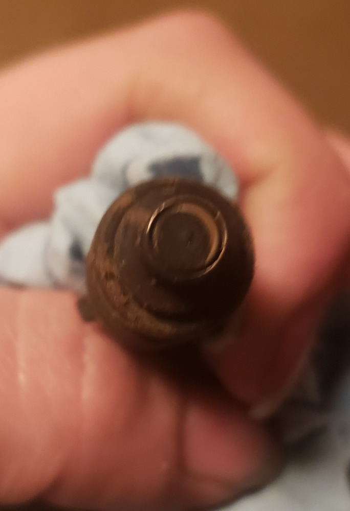

4 years 10 months ago - 4 years 10 months ago #53038
by Deth39
Replied by Deth39 on topic 2007 Dodge Dakota 3.7L P0201
Picture of injector one tip. Looks like burnt varnish or something. Minus one the rest are original from 07. And the one I am not sure of the manufacturer.
Have six new OEMs to put in, the price difference between my Napa for the Bosh which is the OEM maker and from the Chrysler dealership was small. For this year and model engine. Think I'm going to do the PCV valve as well. On the 07 Dakota 3.7 it's in a weird spot on the back left head bolted in.
Last edit: 4 years 10 months ago by Deth39. Reason: Added Picture I hope.
4 years 10 months ago #53115
Replied by Tyler on topic 2007 Dodge Dakota 3.7L P0201
Pretty! Did this truck sit for awhile? Any additives in the fuel?
Let us know how the injector replacement goes.
Careful with the PCV valve while you're in there. I seem to remember that the PCV hoses/pipes get super brittle and crack if you look at them the wrong way...

4 years 10 months ago - 4 years 10 months ago #53184
by Deth39
No jinx, no jinx on this. Fingers crossed.
Nope my daily driver. Fuel wise just gas from Sunoco regular 87. The hoses do seem pretty flexible for the age. Have some new injector clips coming in then back together and she should fire up no problem.Pretty! Did this truck sit for awhile?
