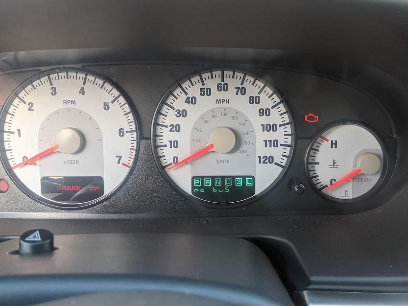

No Crank, No Comm....No bus code on dashboard....2006 Dodge Stratus 2.4 Automatic
Reportedly the car ran fine, although only used once or twice a week. Then the car started and stalled just after he last time it started...has been in crank , no communication state since....about 2 weeks....Good battery, and starter....all fuses checked and relays swapped here and there with same results...I checked for a 5v reference at the throttle position sensor, no 5v reference. I need to review some more SD videos before going further with unplugging sensors.....no wiring diagram as of yet, but I'll probably get one soon.... I've checked about for any obvious breaks in wires or corrosion , none that I saw.

I see that you measured a significant draw on the battery - 349mA. That's one problem, but not *the* problem. Stay focused on the no crank, no comm for now.
Speaking of, I wanted to clarify. You stated this Stratus is no crank at one point, and cranking at another. Not trying to nitpick, just wanted to be clear.
With the no comm and no 5V reference, I believe you're left with three possibilities. Shorted 5V reference, missing PCM power/ground, or failed PCM. Eliminating a shorted 5V would probably be the easiest first step, IMO. Find the violet/white wire at pin 29 of C2 at the PCM. That's the 5V feed for all the 5V reference sensors (CMP, CKP, MAP, TPS, A/C Pressure). Cut it close to the PCM, but not so close that you can't easily repair it later. ;) Recheck for the NO BUS message and communication with the PCM. This is the fastest and easiest way to eliminate all the sensors AND wiring as suspects.

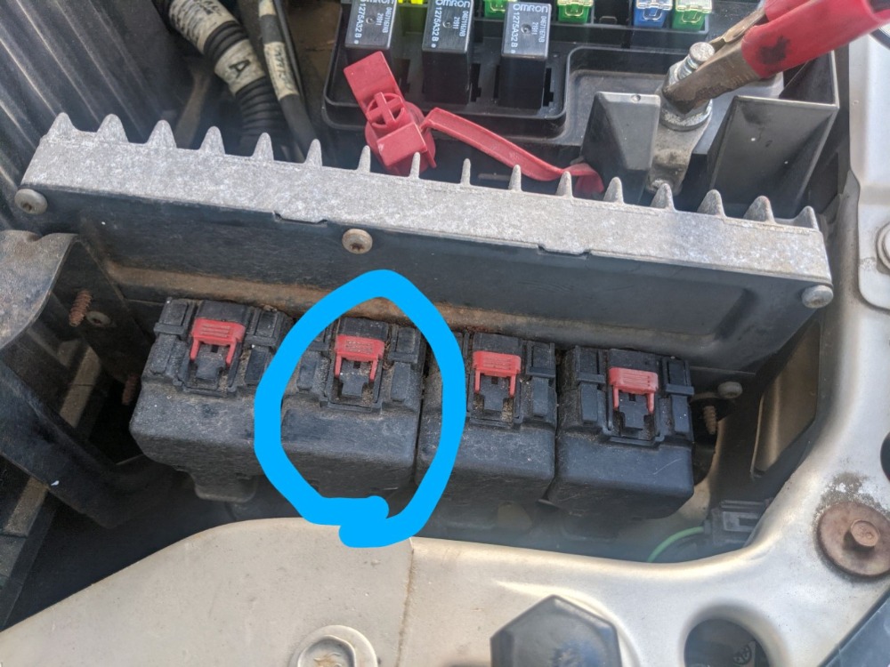

I appreciate your wealth of information, amazing. I'm struggling with ECM and PCM...In the picture is this the C2 of the PCM?...where is the ECM...
Dodge calls these PCM's because it's a Powertrain module. That (generally) means that this module controls the engine AND the transmission. There is no separate engine module and transmission module. It's all one brain box.
I believe that's C2? Service info indicates that C2 is orange in color. For reference, the sequence of connector colors should be black, orange, natural (white) and green. From there, pry that stupid wire cover off, YEET it, and find the violet/white wire. ;)

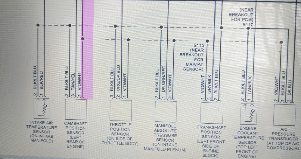

4 years 10 months ago - 4 years 10 months ago #53361 by Tyler
Replied by Tyler on topic No crank no communication Dodge Stratus
any how if someone can let me know how much of a diagram , if any I can share on this forum for discussion purposes...or do I simply say C2 pin 29 vio/wht is listed as the 5v ref..and refer to wires that way,.....
Referring to connectors and pin numbers is the best way for others to follow along, IMO. Screenshots or snips of diagrams definitely help. Like this:
Windows Snipping Tool makes grabbing and highlighting diagrams a breeze. :cheer:
support.microsoft.com/en-us/windows/use-...5f-f220-97299b865f6b
Last edit: 4 years 10 months ago by Tyler.

Thank you...I'm trying to avoid cutting the 5v reference, if I'm able to access the sensors without a major problem...I'm wondering if there are many more than the ones shown on this snip it....the crank shaft one is a little tricky to get to and I haven't researched the a/c sensor location yet...just wondering how many more there might be.
Not to worry, that's all of them! :cheer:
You can totally go for the individual sensors, too. Nothing wrong with that at all. I only made the wire cut suggestion because it provides a clear diagnostic yes/no path AND eliminates any possibility of a shorted 5V reference wire all at the same time. If you still have no 5V reference after disconnecting all those sensors, you'll still have to disconnect C2 of the PCM and ohm the 5V reference wire to ground to verify there is no wire short.
