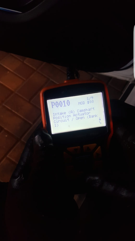

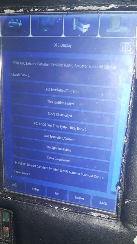

No I had someone else complete the scan, a mechanic but no one that is familiar with the wiring. Yes we rechecked the code since the check engine light came back on and still getting the same code. I will insert a few photos following this post. I'm not certain if the photos can assist you with determining the scanner. I did however received an additional two trouble codes both of which are no longer showing up when scanned after replacing an O2 sensor and both camshaft sensors.

Error Code

Error Code

They are all old photos before any work was done to the vehicle. The scan now shows error code P0172 Fuel Trim system rich as passed. The only other error code is now P0013.
