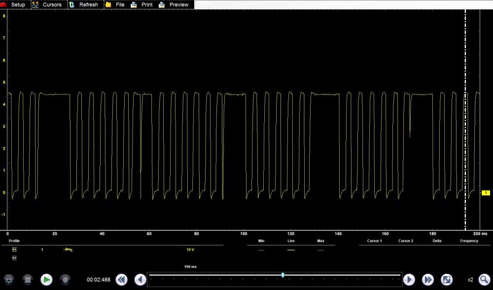

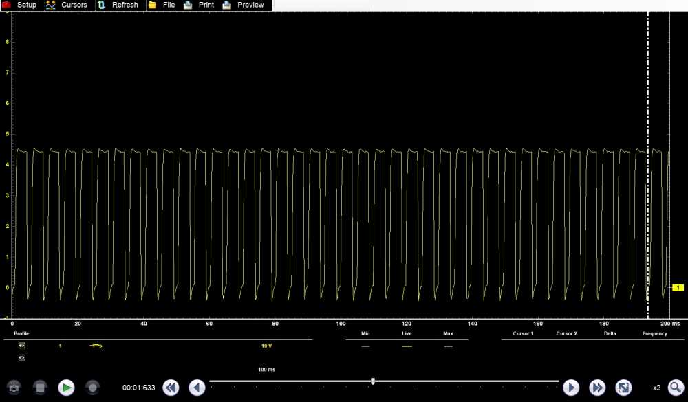

9 years 7 months ago #7737 by Tyler
Replied by Tyler on topic 2007 Scion TC Alternator
You're on the right track, it's a load monitor circuit for idle control. Reading into this signal is kinda weird. :unsure: For example, this is a shot of the M circuit on a 2009 Camry with a failed alternator:
This is the after with a functioning alternator:
I've played with this circuit a bit on my Scion xA. Shorted it to ground with a test light, zero codes, charging voltage steady, and no idle change. :dry: They spent the money to integrate the circuit into the car, but don't seem to care much when it's not working correctly. :lol:
The following user(s) said Thank You: SniperDan
