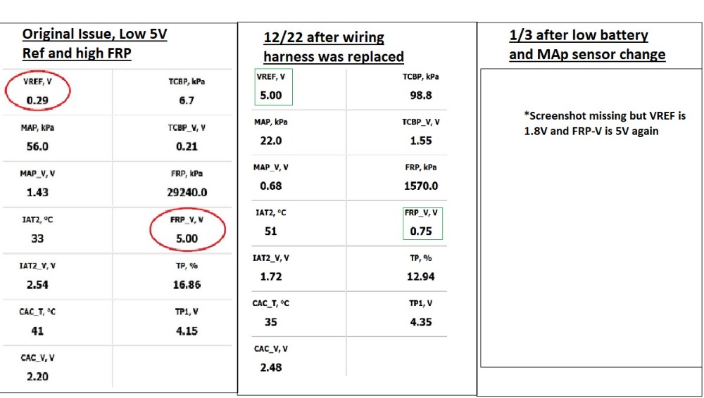

I could really use some guidance as I'm at my witts end...
I have a 2010 Ford Taurus SHO with a low 5V Reference Signal (P0642).
I first had this issue a couple months ago.
I ruled out the three sensors on this circuit as I still had <1V with all sensors unplugged.
I changed the computer but still had this issue (Doh!).
I then isolated the issue to the engine wiring harness but could not find the fault.
I took it to a shop to see if they could find the issue in the wiring but they couldnt and suggested to change the harness.
After the above, I sourced and replaced the top engine harness last week.
I turned the key on and hallelujah, the reference circuit was reading 5 volts again, it started but ran rough..
It was throwing a code for the MAP sensor and upon inspection I realized the shop replaced the MAP sensor with the wrong one (3bar vs 2bar)
I received the new MAP sensor and was disheartened to see the 5V circuit was reading low again (P6042)....about 1 volt and the fuel rail pressure sensor is showing 5 volts
Looking for some feedback or ideas.
For some reason, the fuel pressure sensor is pegged at 5 volts while the 5V Reference signal is low (1.8V) at KOEO.
I am sharing screenshots of the voltage readings before I replaced the harness, the good readings after replacing the harness, and again now.
Looking for any fresh ideas or if anyone can see the correlation between the pegged FP sensor voltage and the 5V Ref circuit.
Thanks for reading this and any suggestions!!

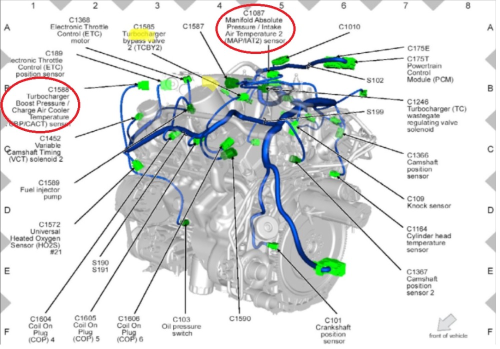

INFO:
Sensors connected to reference voltage A circuit:
Fuel Rail Pressure (FRP)
Manifold Absolute Pressure (MAP/IAT2)
Turbo Boost Pressure (TCBP/CACT)

4 years 10 months ago #53407 by Matt T
That FRP may be a substituted value. Wouldn't worry too much about it at this point.
First thing I'd do is unplug the N.E.W. MAP sensor to see if that brings the Vref back up.

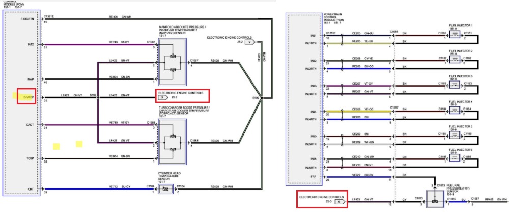

I visited the car again yesterday and am still at a loss...
The 5-VREF circuit is still showing around 1 volt....with all sensors unplugged....AND EVEN with the engine wiring harness unplugged from the ECM.
I even swapped the computer and no change in values!
So it seems I have the low reference voltage even with a different computer AND engine wiring harness.
What is really driving me nuts is why it was showing 5 volts the day I replaced the wiring harness but not anymore...even with it unplugged
I attached the wiring diagram. Can anyone see any reason why FRP sensor would be showing 5 volts (open?) at the same time I have the low voltage reference (even with wiring disconnected).
So frustrated :(
