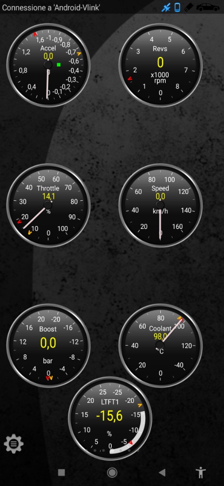

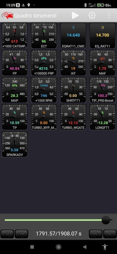

It seems all good but long term fuel trim shows from 10 up to 16 % negative at idle (short term near 0%) and as soon i hit the throttle it goes down to -5/-3 %..when i'm cruising or full throttle it stay around -4/-3 % negative meanwhile short term is close to 0% or a bit positive (no more than 3% positive).
What can i check?
Got several logs done with forscan, but unfortunately i can't post here, they are fsl files.
I can only post a screenshot of torque pro showing -15 ltft ai idle.
