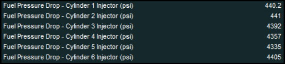

4 years 9 months ago #53492 by Tyler
It is possible. I'm hoping someone would know what the actual injector balance results would show. I can say that after running the 3M cleaner through the injectors, I saw no difference at all.
This is the injector balance test results from a 2011 GMC Acadia with a new set of ACDelco injectors:
www.scanshare.io/share/S-CTmsafCkWDHDfeHZwnFQ#0,1,2,3,4,5
ScanShare and Shopstream Connect like to drop decimal points. :silly: The actual results are 430-440 PSI, not 4300.
That said, I have never liked the automated injector balance test, and I wouldn't place ANY weight on it if I were you. I've had multiple vehicles pass the automated test over and over, only to get fixed with a set of injectors.

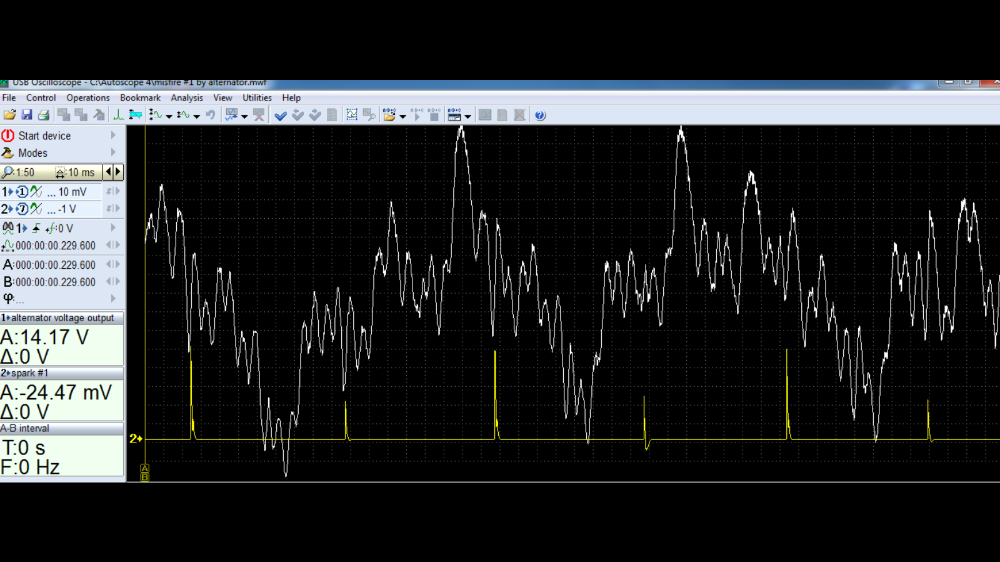

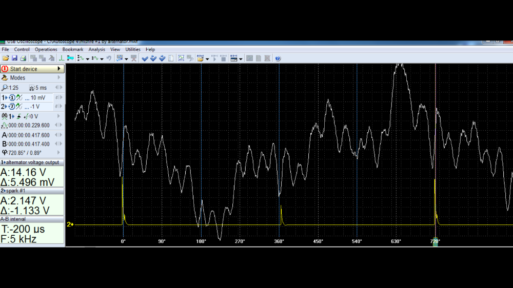

On the rpm/ alternator thing:
The crankshaft speed at a given rpm is not constant, each time a cylinder fires it (slightly) accelerates and then decelarates. These deviations from a constant, lineal speed are supposed to be even between cylinders. While misfiring the deviations caused by an offending cylinder will be more pronuonced.
The alternator´s voltage output allows for detecting these deviations of crankshaft speed with a scope; the voltage output depends (among other things ) on crankshaft speed and will reflect exactly the little changes in crankshaft speed. To make them visible with the modis try to AC-couple in peak detect mode. Don´t put to much time on the screen as you want to see detail, yet enough to see various complete crank turns, so it´s a combination of screentime and buffer .Use a second channel sync to a particular cylinder and apply the firnig order to identify all of them and their contributions to crankshaft speed.
I hope this clears things up a little bit.

4 years 9 months ago - 4 years 9 months ago #53520 by juergen.scholl
Replied by juergen.scholl on topic 2010 Traverse 3.6 - Misfire codes & flashing MIL
Matt, the attached pictures show the technique at work, there is a heavy filter, a good measure of horizontal and vertical zoom applied. This powerful scope will allow to detect the AC-voltage riding on top of the DC portion without further ado
I suspect the hantek simply is not up to that task, the modis is another league and capable.

4 years 9 months ago #53527 by ProAuto
That's helpful. Im only about 2 percent less then those numbers, so I wouldn't think that's a problem. Also, my fuel trim isn't going high and o2s aren't going lean before the codes set.

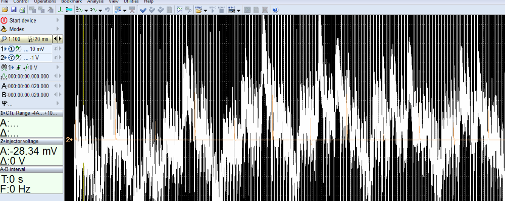

  • ProAuto's Avatar Topic Author
4 years 9 months ago #53529 by ProAuto
Got it, thank you. I'm gonna try it. But seeing as the ecm is picking up microsecond differences between crank pulses, and my alternator voltage is hashy, Im thinking I'm not gonna see anything there.
What do you think about these crank signals? The last one is during high misfire counts. The hash is always there on this car and I have no idea where it's coming from, or if it's causing a problem. Alternator disconnected, hash and misfire counts are still there.
