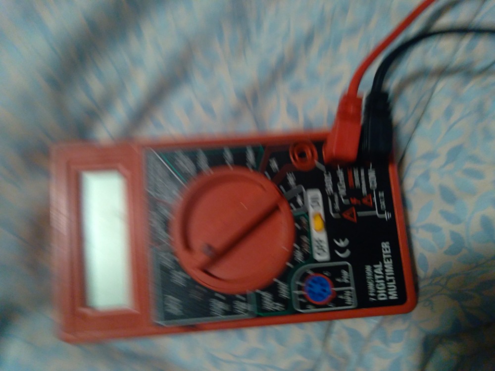

I'm trying to figure out where, on my 2002 trailblazer, is this monster of a draw is coming from. So I put my battery on the charger to make sure I had a good charge on it , I took off the neg battery cable. Now from what I read I'm supposed to put a multimeter in between the cable and the neg post and start pulling fuses 1 by 1 and watch the meter . Ok except for I'm not sure of the settings and readings. I have this kind of multimeter (pic included).
I have the black one in COM and the red one in V?mA is that right also?
Because I did all that and my multimeter died so I thought I fried it . So I took that apart and didn't see anything obvious so went ahead and changed the battery and it seems to be working again. Now was that just a coincidence to shake my confidence or did I cause that?
So then I was going to try pulling the fuse and touching the neg cable back to the post but got no response out of that either. When I get the right settings I can check my batteries voltage before I start right?
Another weird thing is the charger was on 1 and later was on 2 isn't that going the wrong way? I had a 6 mos old battery in it but got a new one anyway.
I'm not going to be able to fix my other problem until I get that one fixed right?

Draw tests are time consuming and must be performed properly to find the cause of the draw. You do want to set the the meter to the Amps (A) or Milliamps (mA) function. Connected between the negative terminal of the battery and the negative cable end. The general accepted key off draw is around 30mA, or 0.030A. This is after a period of 20 to 30 minutes. You need to allow all the modules time to go to sleep.
It's important to be ready before you hook up your meter. Doing things line opening doors will wake up modules, turn on lights and force you to possibly have to begin the wait period again or possibly even blow the fuse in your meter, making the amps function useless even though the meter still turns on and measures voltage.
Start around 7 minutes

Why couldn't I just put the battery charger on and pull fuses watching that needle
