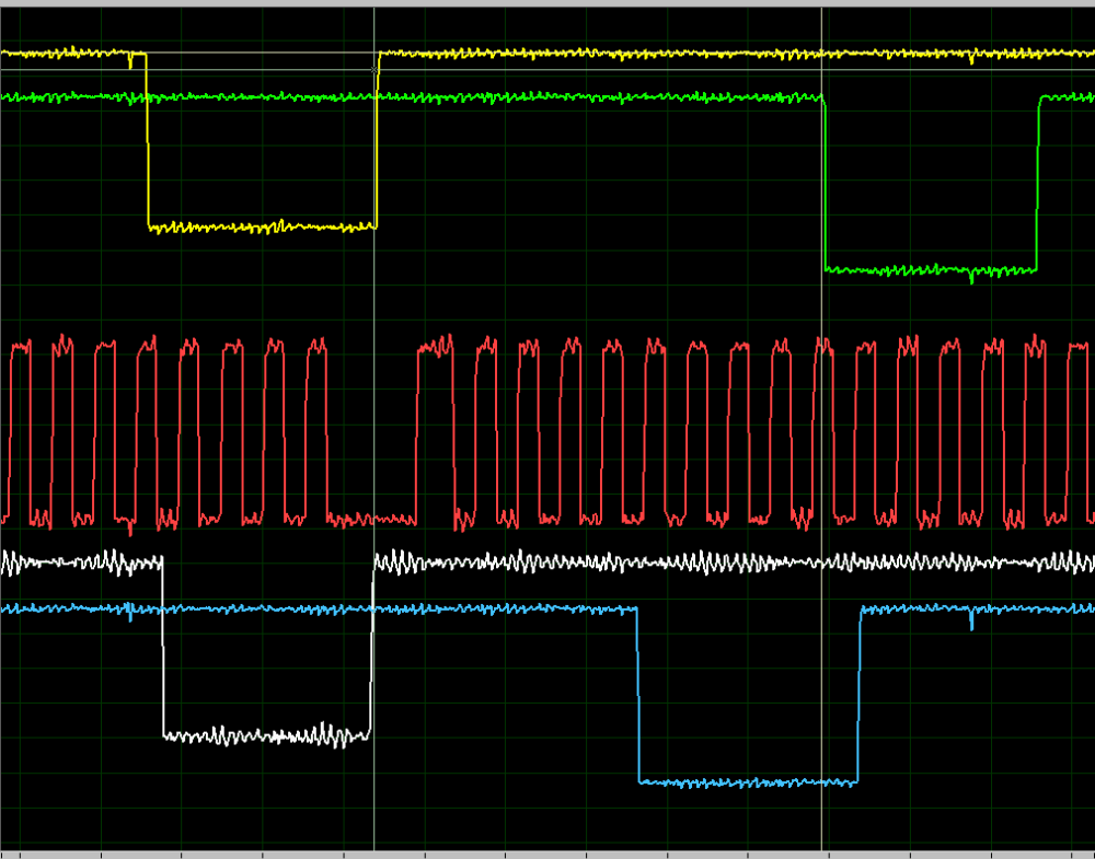

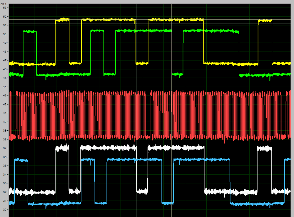

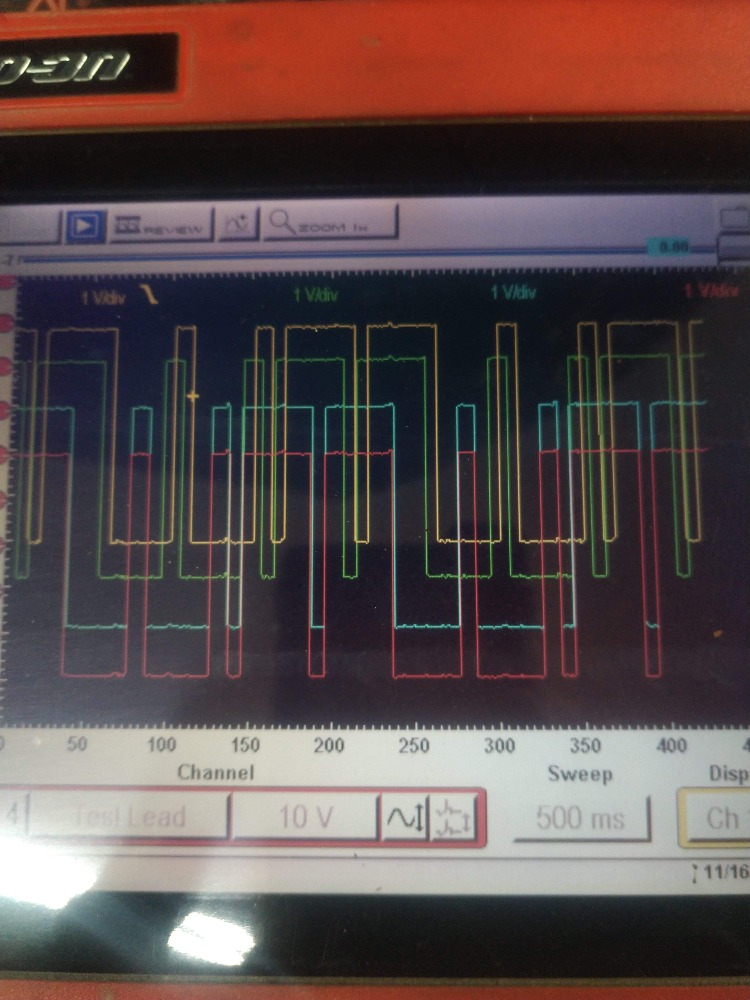

Does anyone have a crank to cam correlation for this engine? It’s a crank no start. I checked bank 2 and it’s a match to the known good waveform but can not find bank 1. Relative compression looks funny like not even every other cylinder

I have a known good of the 4 cams on a 2010 3.6 "v" motor and a 2010 3.6 "d" motor. My two are the same. Might be the same as yours. I'm getting an error message on the upload. Might not come up. Can I email it to you?

I think I can work with the cams. My bank 2 looks close to yours. Do you have each bank with the crank so I can count the teeth or cam to crank.

Thank you chad the b1 is off about 4 crank notches
