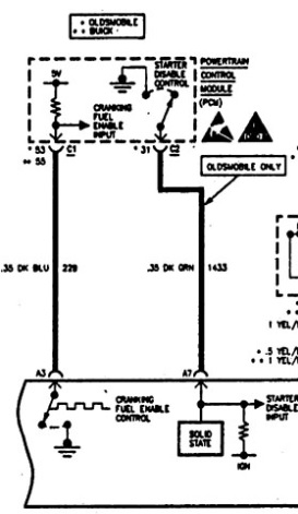

9 years 7 months ago #7866 by Tyler
Replied by Tyler on topic 1996 Riviera Cranks, No Start
So I dug up the diagram for the anti theft system on the Riviera, came up with this:
The pin assignment for the VATS fuel enable signal changes between makes... Wondering if the PCM is looking now looking for that signal on the wrong pin now? :huh: This is the only way I can think of to explain how the car would start before the programming change.
Just a thought I had!

Did some testing this weekend and i dont think it is a VATS issue. Yes the Aurora and the Riviera have slightly different pinouts. I have a FSM for the 97 riv and should be mostly the same for the 96. Was just missing the pinout for the bonneville since that is the program the car is trying to run with.
So i have 2 PCMs, 1 with a riviera file flashed, and the other with the bonneville file flashed.
With the bonny pcm in, i installed the fuel enable bypass and the car works as it did before. Swapped pcms and the car wont crank. Swapped back and cut the VATS wire and the car will start and immediately die on the bonny tune as expected because the pcm isnt getting a vats signal.
This tells me that my VATS is working as it should.
