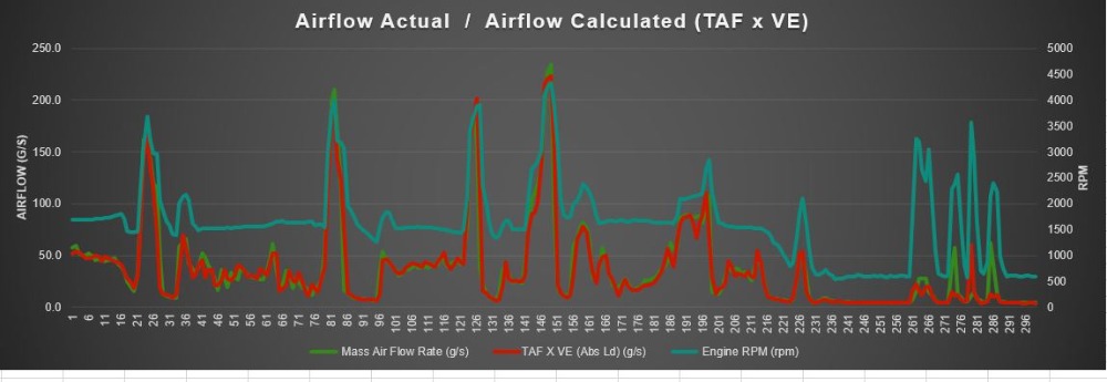

I don’t necessarily feel anything “slip” it’s just noticeably different and progressively getting worse… I did record some live data as was suggested in one of the comments above. And also after revving the engine while in park I noticed a smell that was almost like a sweet smell coming from the a/c. Couldn’t tell if it was coolant or gas though…
  • rscar26
  • rscar26's Avatar Topic Author
4 years 9 months ago #53849 by rscar26
File Attachment:
File Name: Livedata2.pdf
File Size:1,129 KB

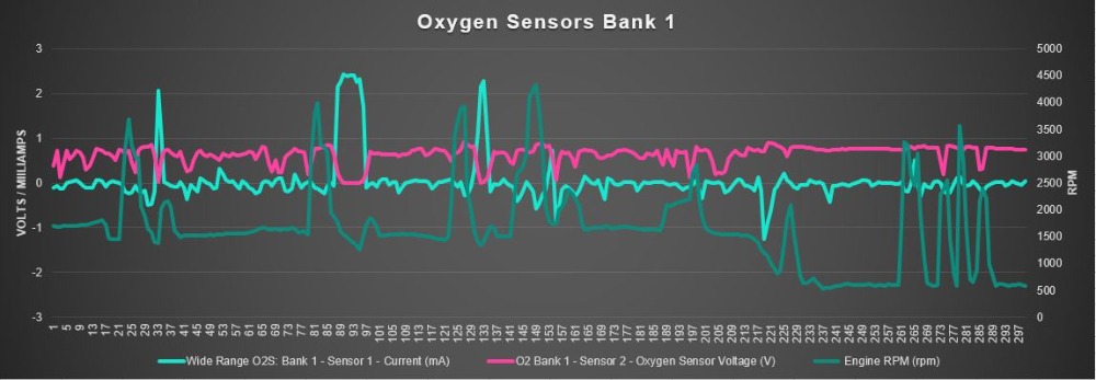

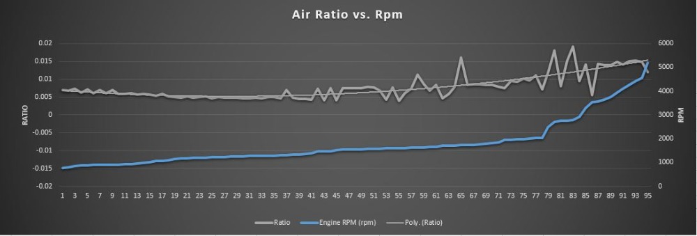

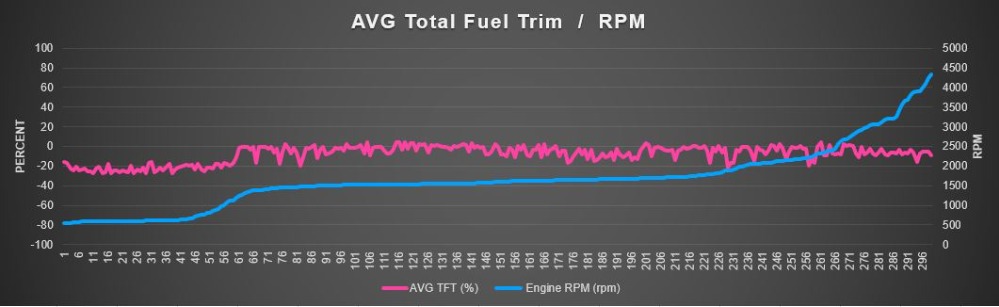

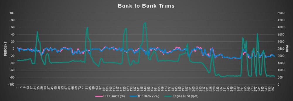

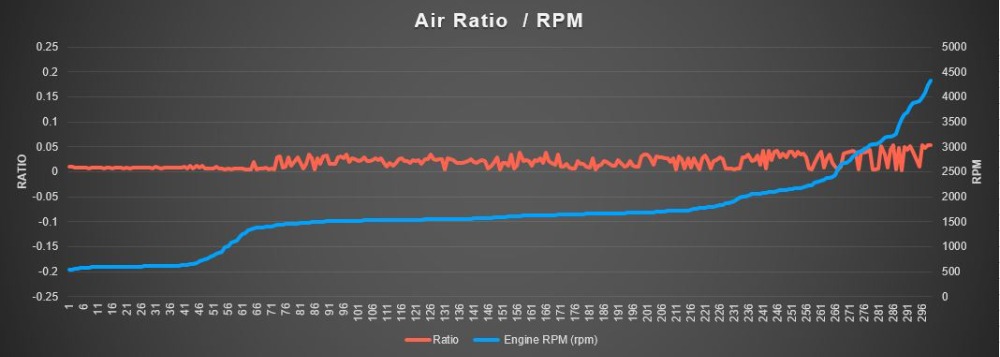

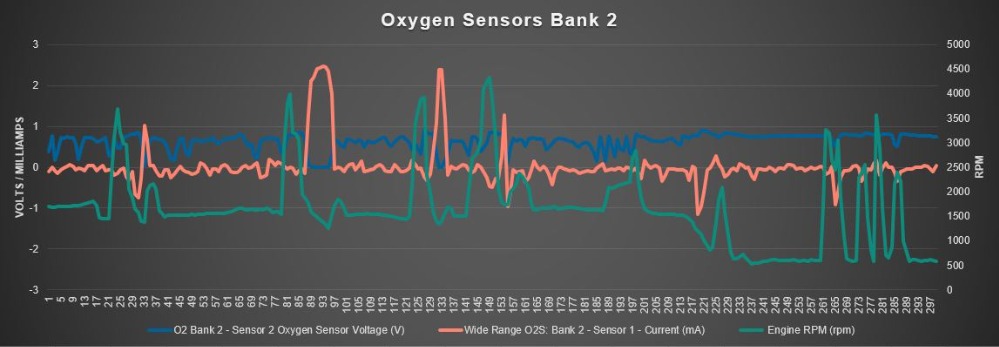

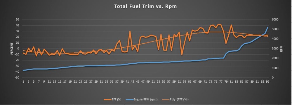

4 years 9 months ago - 4 years 9 months ago #53864 by Paul P.
The Air Ratio is the Actual MAF reading divided by the RPM. We know that the air an engine inhales is proportional to its RPM. This ratio line should be perfectly straight across the entire RPM range of the engine. In the case of this Ford, it is.
Below is an example of a dirty MAF, It Over-reported at low RPM and Under-reported at high RPM. Notice the curve trend.
So far we know the Air was read properly by the MAF from this one graph, but in the graph below this engine has fuel trim at all RPM ranges. If the air was measured correctly, this would leave the problem on the fuel side! We can see the trims are very negative before that throttle plate opens up, but remain negative throughout the entire Rpm range. What can cause this? Leaky Injectors, Fuel Pressure too High, Open Purge Valve with a saturated canister? In further graphs we will see Bank to Bank trims near identical, this would rule out leaky injectors, although possible, they would have to be leaking perfectly balanced between both banks to go unnoticed with this data set. A faulty purge valve would have provided better trims at higher rpm, with or without a saturated canister. These trims are linear, Fuel Pressure becomes the number one suspect. Also in this graph, we can see the PCM still has fuel control.
It should be mentioned that the data in the above graphs has been manipulated by MS Excel to display all the recorded data based on Engine RPM from Low to High. Products like the E-Scan Elite will have you to take a test drive from ZERO to WOT. With this method, you can just drive around and safely get the engine through its paces.
The above graph further solidifies the Air measurement was correct. What the engine can theoretically ingest matches what the MAF is reporting. This Theoretical airflow is calculated from engine rpm and size and multiplied by the Absolute Load (which is the Volumetric Efficiency). I have yet to use complicated airflow calculators that take into account Barometric Pressure and Temperatures; that's not to say they will never be required!
These Oxygen sensor graphs show the sensors are telling the truth. We can see some nice fuel cuts, and near the end of this test drive a few snaps and we can see a couple of short high oxygen storage capacity from the Catalysts. These Cats are in danger of raw fuelling, which makes Oxygen Storage Capacity testing not a good idea until the fuelling issue is addressed.
Sorry took so long!
Never stop Learning.
Last edit: 4 years 9 months ago by Paul P.. Reason: Pictures, Pictures, Pictures
4 years 9 months ago #53902 by Noah
Thank you for reformatting your post!
Impressive as always Paul. The second MAF example is probably the clearest representation of a misreporting MAF I have seen with scan data.
4 years 9 months ago - 4 years 9 months ago #53903 by Paul P.
Thank-you Noah. I should have attached the graph with the Fuel Trims that went with the "Dirty MAF"
Seeing the trims puts the nail in the coffin here...
This "Air Ratio" is absolutely not my idea, I have to credit Mr. Justin Miller, he can be found on Youtube.
This is his video where I learned this method:
What I did was read Bernie Thompson's Patent for the E-scan and figured, I'm gonna try this myself with MS Excel. So once I found Justin's method, adding in Bernie's Total Fuel Trim was a piece of cake!
This makes it pretty cut and dry whether the problem is air side or fuel side.
Not only are we limited to a MAF engine to calculate Theoretical Airflow, but we can also do it on a speed density system as well!
