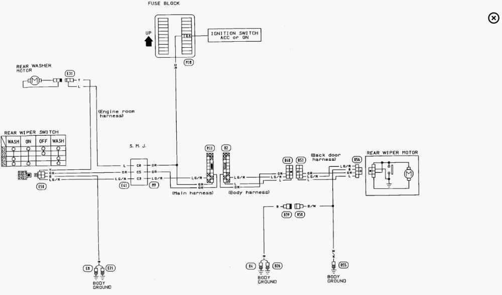

Hi all.
I am after a rear wiper wiring diagram for a customers 93-97 Nissan 100NX Iam not sure on the exact year as it is an import. I know it looses it's ground intermittently and the switch controls the ground (pull down design) The wire in question is a light green with a red trace. The customer has already replaced the switch and the fault is still present. I have checked all of my recourses for a diagram and had no luck. If any one has access to this wiring diagram and could email it or post it on here it would be much appreciated. Many thanks Rich
9 years 7 months ago #7838 by Ephratah
Replied by Ephratah on topic Request for 93 - 97 100NX wiring diagram
hope this is what you need

Thank you very much for your time it is much appreciated
