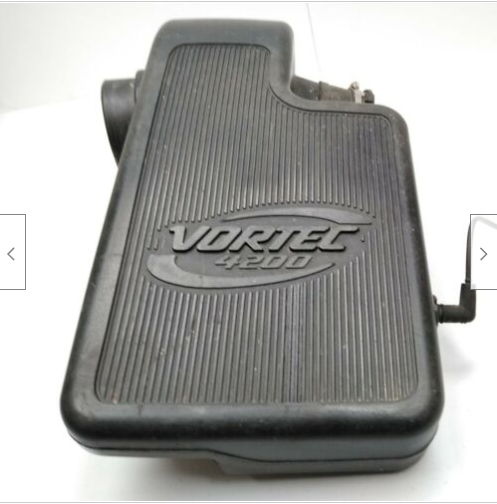

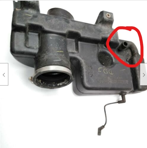

ok so I took the cover thats by the throttle body off. Should that thing have oil in it? I don't feel real confident enuff to take the t.body off. You think its ok to clean it with it on PLUS I cannot get the damm plugs off. What say you?
4 years 9 months ago #53804
Replied by Tyler on topic 2002 trailblazer throttle body clean
You mean the intake resonator has oil in it?
Not unusual, IMO. The fresh air side of the PCV system runs through that box. That's the rubber hose on the bottom side:
Make sure that hose goes back on the valve cover when you put it all back together.
It's easy to miss.

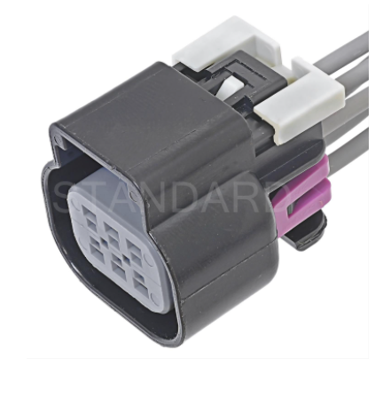

I'm still on that main plug lol . Is there some kind of gasket deal I have to worry about?
4 years 9 months ago #53809
You mean the main connector for the throttle body? There's a weatherpack seal inside that you may be fighting. Are you sure you got the CPA disengaged? That's the white part of the connector:
The CPA needs to be as pictured above to get the connector to unlatch.
