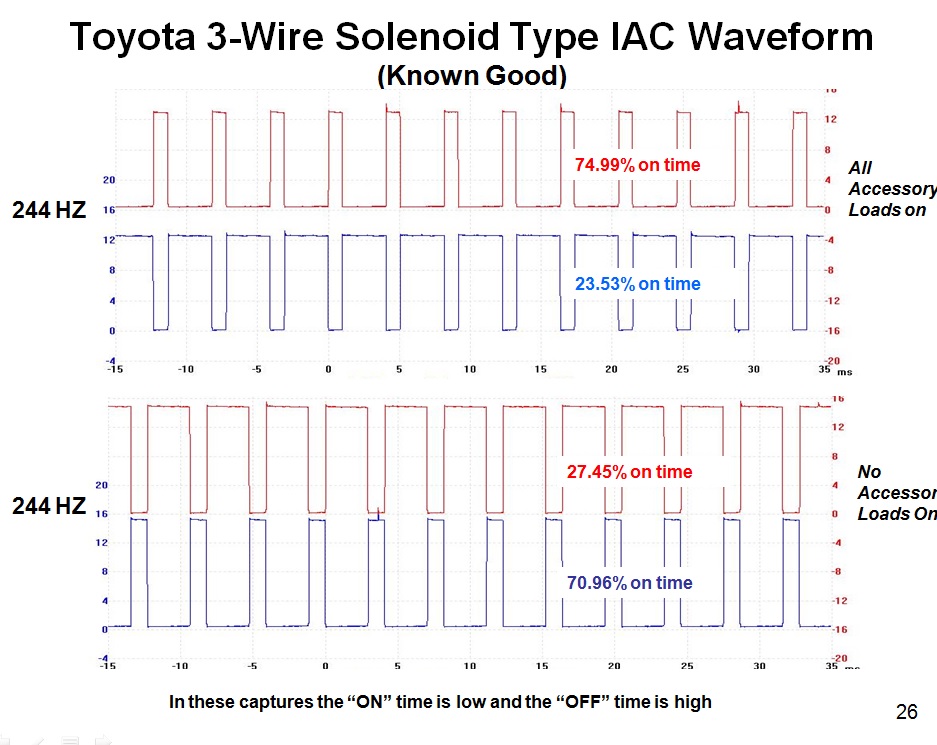

I suggest watching a ScannerDanner video named "Toyota 3-wire solenoid type IAC Waveform." The two control wires should add up to 100% in regards to duty cycle. Since, one was at 40%, the other control wire should have been very close to 60%.

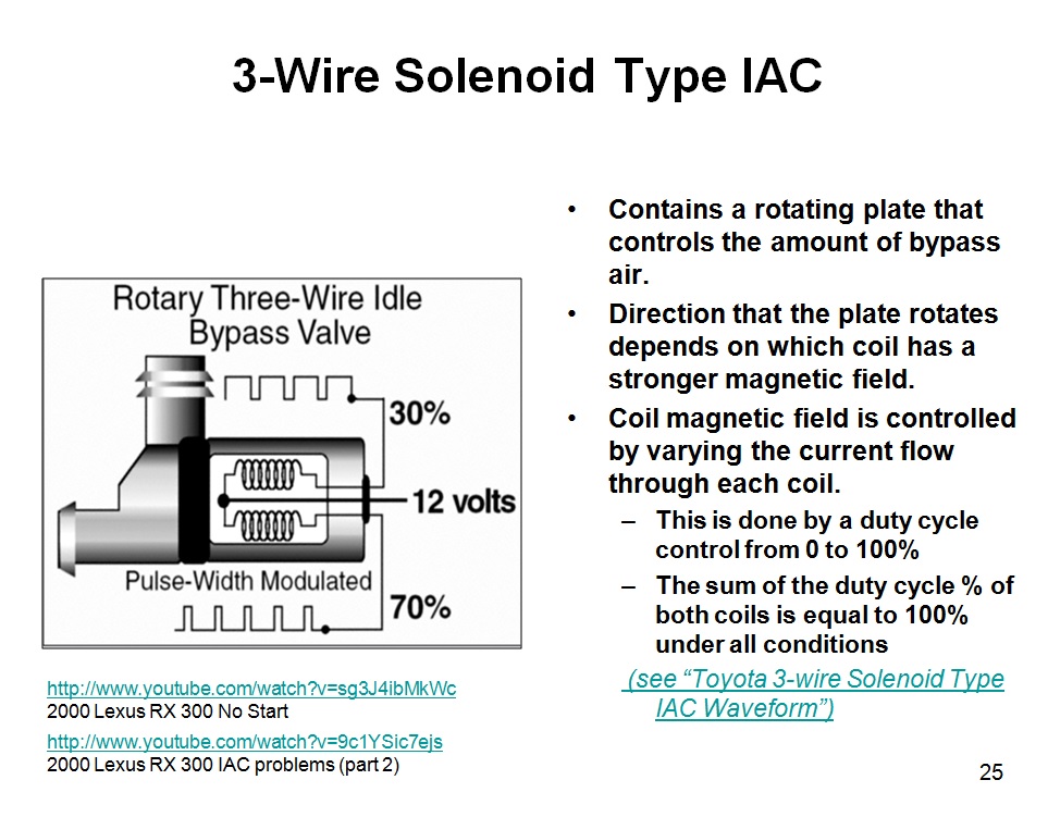

So to be clear. The wiring on this IAC.
1. constant battery feed
2. IAC control (ground side switched)
3. IAC control (ground side switched)
These two controls should mirror each other. When one is high the other is low.
Here are two pictures from my book Chapter 20 "Idle Speed Controls"
If this is what you are dealing with, what voltage does your scope show you on the no control circuit? Is it fixed at 12 or 0 volts?

You are correct about the wiring on this idle air control valve and it is identical to page 25 in your book.
