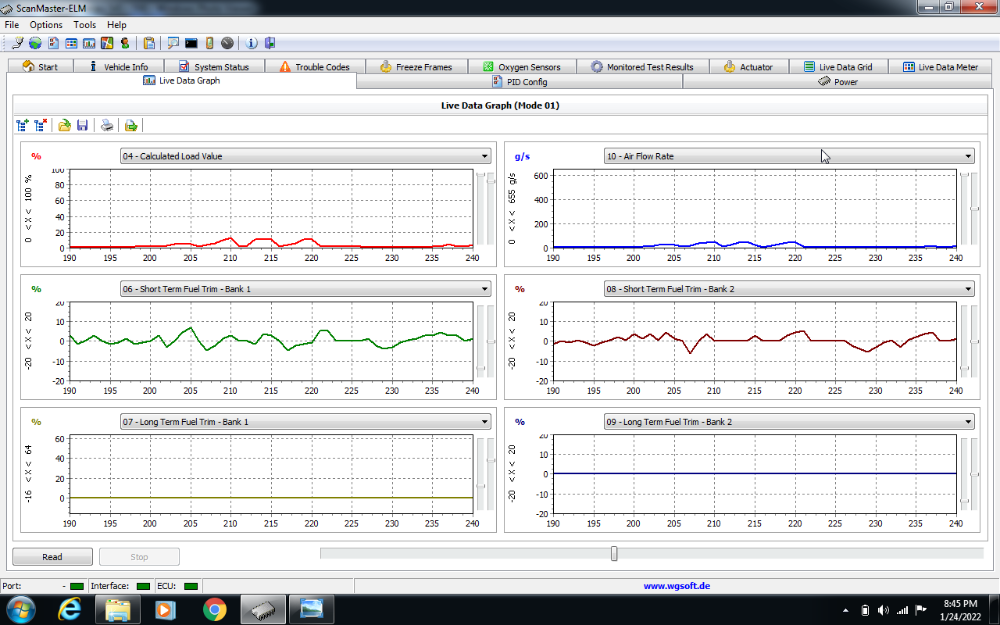

Relevant snapshots from the scantool:
- please remember, the catalytic converter is hot from me test driving the car and I am now back at the shop in the bay grabbing this snapshot (composed of the 3 attached pics from frames 502 to 640)

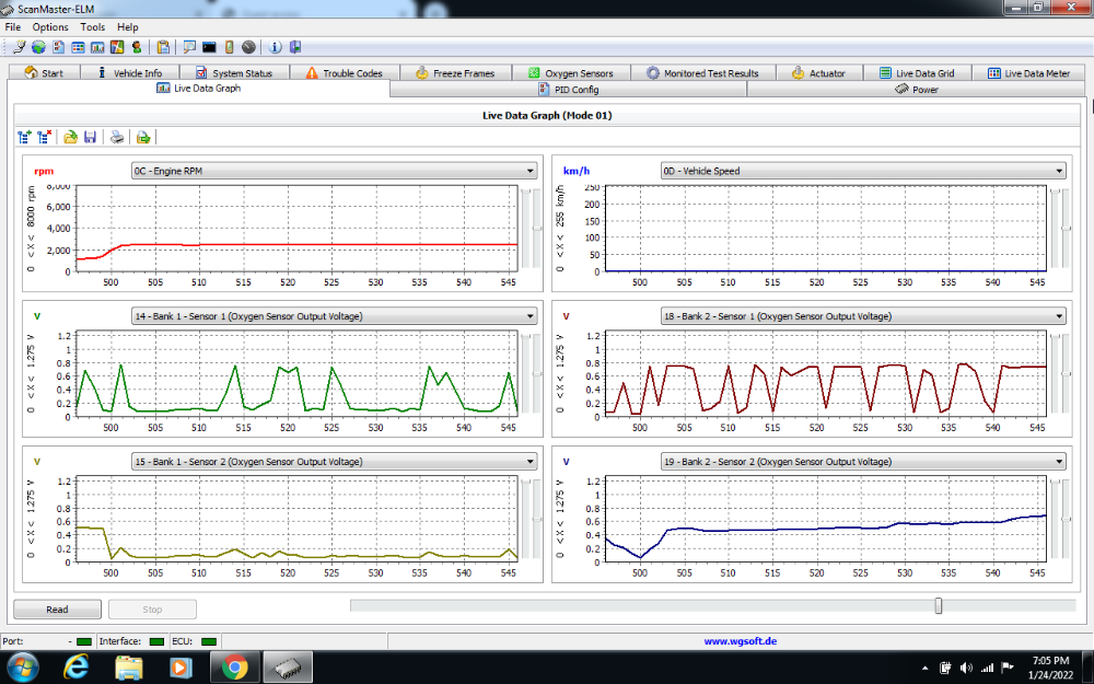

- (1) pic "993_1of 3" - you can see I am bring the rpm's up to 2500 rpm (i.e. frame 502 ish)
- in frame 503 ish of pic "993_1 of 3" you can see B1S2 go lean and stays lean all the way to frame 545
- at the same time, you can see B2S2 climb in voltage from frames 503 ish to 545

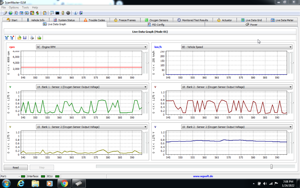

- (2) in pic "993_Pic 2 of 3" - you can see B1S2 keeps staying lean while B2S2's voltage steady's out around 0.7V

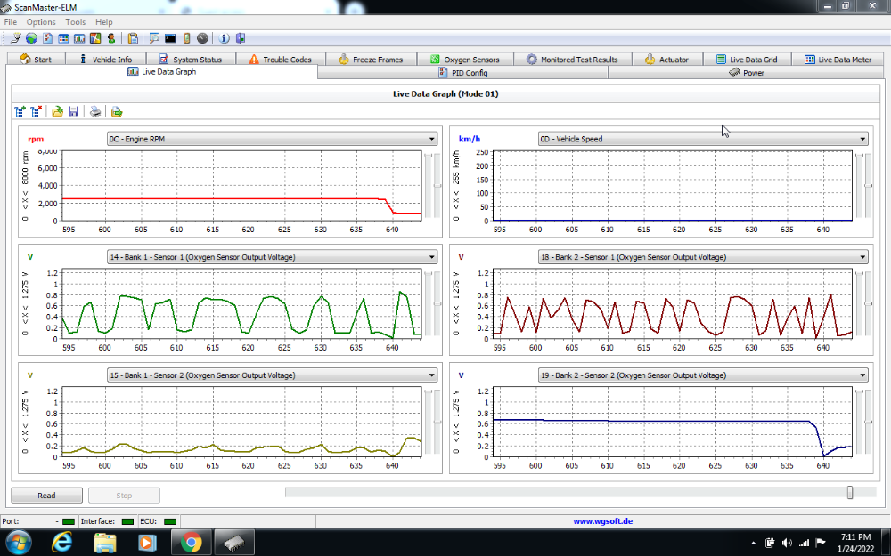

- (3) again, in pic "993_Pic 3 of 3" - you can see B1S2 staying lean till frame 640 (where I throttle back to idle) while B2S2 stays at about 0.7V till frame 640
- (4) pic "993_fuel trims at idle" - provided this snapshot to show that fuel trims are single digits and good at idle and slightly off idle (note - you can determine where I am throttling based on MAF g/s reading); STFT for both banks fluctuates between -6% to 8% while the LTFT is a steady 0.8%
