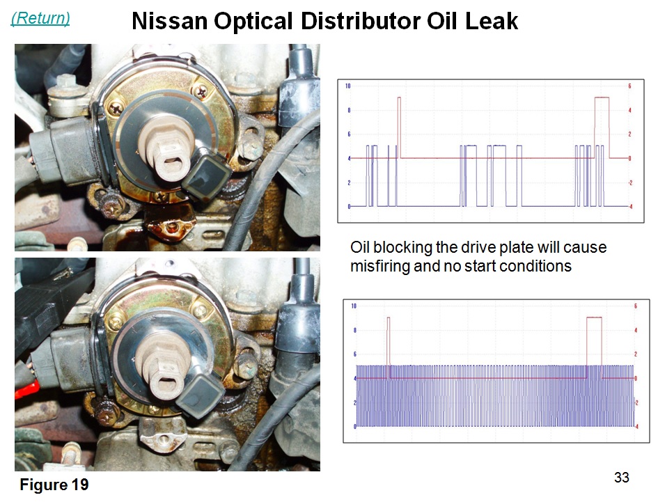

Is this the optical distributor? Mounted horizontally on the side of the cylinder head?
This is from chapter 21 in my book and is what I am thinking about for your situation.
Don't be a parts changer!
9 years 7 months ago #7917 by Tyler
Replied by Tyler on topic 1994 Sentra Lean Condition, Stumble/Stall
Definitely check the distributor for an oil leak like Paul pointed out. ;) If you come up empty there, then I'd suggest installing a spark tester in-line with one of the plug wires and watching the spark during idle and acceleration. If the spark is weak, sporadic or disappears on acceleration, then I'd say we should stay with an ignition problem.

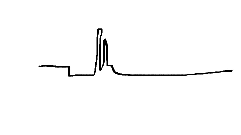

I have not verified it with a timing light. I did however have to move the distributor to the full advanced position to get it to run. Tomorrow I will have real timing numbers for you. I will also do a compression test. I have installed a spark tester, and it will jump a 1.5 inch gap easily from the coil, and at least an inch at the wires. I have scoped the injectors using both current ramping and voltage. The current ramp from looked normal with a nice ramp and a long saturation period. With the fuel trim so hi, it makes sense to have an extended saturation because of the longer pulse width. I did however see a strange looking voltage pattern. I apologize for not having a snap shot of it, but I attempted to draw it in paint. Please see the attachment. All the data points to a fuel problem for me.

Also, I keep looking at your injector pattern drawing, and I still don't have a good answer. :( Is that same pattern present after the ignition repair? If you can get a screenshot or photo of that pattern, I'd be interested to see it.

It's fixed for sure. Where I went wrong was dwelling on the increased fuel trim and the 02 reading 0 volts when accelerating. False lean due to engine acting as an oxygen pump because of incomplete burn under load. As for the injector waveform, I will put the Pico on it sometime this week and take a movie. Not sure if it is still like that or not.
