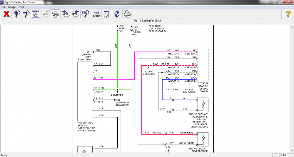

Customer brought his 2011 Mazda 3 with a 2.5 engine because his fans are on all the time (it has a module type fan with 3 wires) and has had it in several shops, and now its my turn at it. ;)

Do you happen to have a diagram for the fan circuit?

9 years 7 months ago #7971 by GeorG
Replied by GeorG on topic 5v Reference Circuit problem (maybe)
Noah wrote: Hi georG, I moved your post to the repair questions section.
I'd pull one for you, but I'm mobile at the moment...
here it is

Unfortunately, I have little service info for this car. The diagram you posted blows away anything All Data has to say. :angry:
