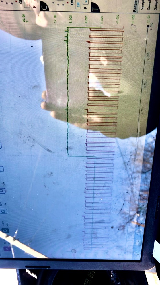

2002. Suburban 5.3. No spark no injector pulse. No. Signal. From the ecm to the. Fuel pump relay. I got. Waveform. From the. Crank. Sensor. And. Cam sensor. I do t have any security light flashing. Or. On. It come on when i open the door. But. Then after close. Goes off. Im lost. Any help please. I was thinking. The ignition. Switch. How do i test. The. 3 wires on top of the ignition. Switch ? Or. Any. Idea. ? Thank you. This is. The way form. From the crank.

Check powers and grounds first at the ignition coils while cranking to load test them

I got power and groundS

Very hard to understand but it very well could be the switch. I don't have access to a schematic at the moment. If someone could post it maybe we can help.

Thank you for responding. Well if you see. The picture of the waveform I got good Signal from cam and crak sensors. And they synchronized.
I know sometimes. The theft system activated and wont let you truck starts. Like no pulse at the injectors . And. No spark. But this time i dont see That light. Flashlight. Or stay on. Its. Just. Come on for. 3 seconds then goes off.
