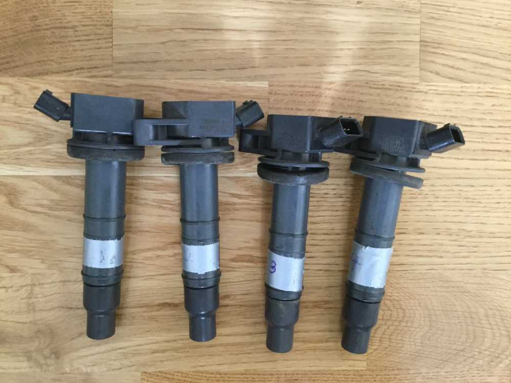

I did the spark test on the ignition coils and only thing I heard was spark or tapping sound and I couldn't see with my naked eyes any sparks on the 4 coils.
How I performed the test. I unplugged the ignition coil but still connected to the wire harness and put a spark plug in it and then I started the engine. At first I saw spark coming out on the first coil but the spark was not coming from the tip of the plug rather from the side, then other attempts no spark anywhere just the tapping of spark sound. More like you can hear but you can't see.
The ignition coil are so expensive so how do I make sure 100% the fault is from the coils and not the wire harnesses or voltage source to the coils, what other things do I need to troubleshoot for in a complete ignition system.

You should have also connected spark plug (the part with the thread) to a ground point (but not battery negative) so the spark have somewhere to go

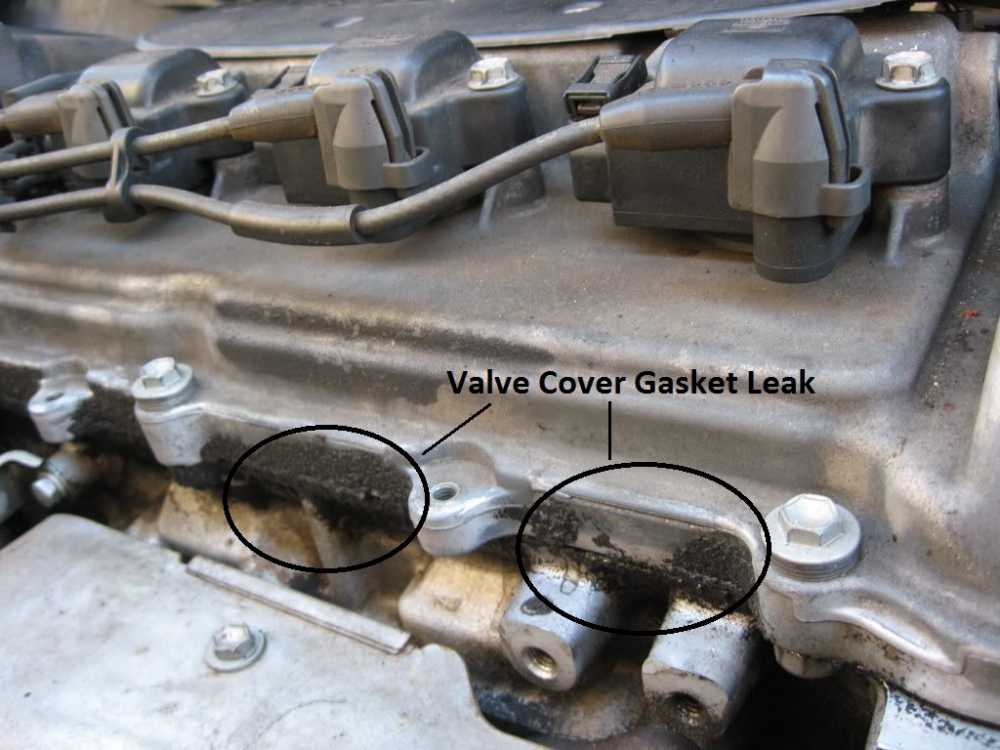

9 years 6 months ago - 9 years 6 months ago #8404 by babajis2010
Replied by babajis2010 on topic Oxygen sensor wire harness test

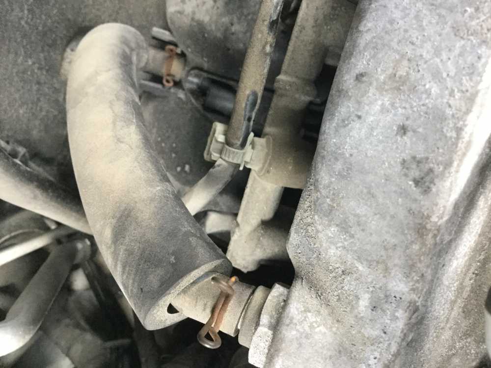

Also I have oil leakages on my valve cover gasket. The front leakages are like these two pixs on google combined.
I cant see the other side where you have the manifold, it's so tight to see clearly.
Can this cause loss of engine fire power and do I really need a new valve cover gasket.
A friend that was with me when I started the engine and it's not warm asked me if this is a Diesel engine because of the sound, but I guess the car's RPM is usually high at cold start around 1600-1800RPM and that's when it sounds like a Diesel engine, but when it's warmed up it becomes normal petrol engine sound.
What could this mean
Last edit: 9 years 6 months ago by babajis2010.
9 years 6 months ago #8415 by Tyler
Replied by Tyler on topic Oxygen sensor wire harness test
babajis2010 wrote: By the way my valve cover gasket is leaking oil and also I have so much sticky oil all around the engine oil cover ( the hole you pour oil into the engine). Can my engine have loss of fire power due to this also.
Negative, no loss of power due to the valve cover leaking. That kind of a PCV system leak would need to be huge to cause any kind of fuel trim issue, and it'd mostly be at idle. I mean, you should fix it. ;) But you'll never notice a driveability issue because of it.

I followed one of your YouTube videos again on checking my ignition coils and they all seem to be good.
I took off the wire harness connected to the coil and started the engine and then engine was shaky and almost went off, I did same thing for all the 4 coils and they came back the same. So I'm assuming all my coils are still intact.
I got DTCs for doing that which is normal and I just erased the codes when I was finished and they never came back.

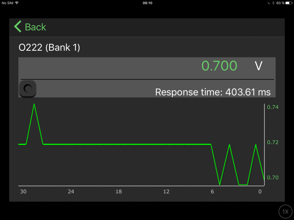

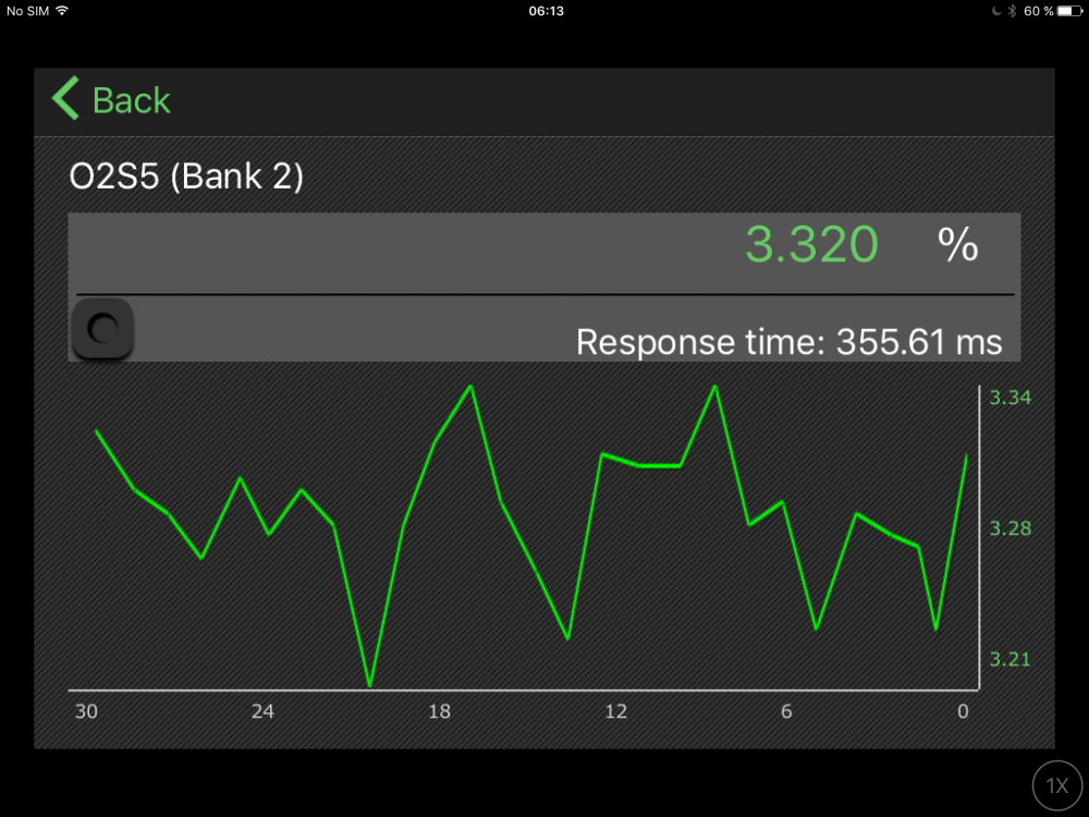

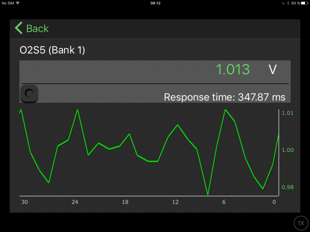

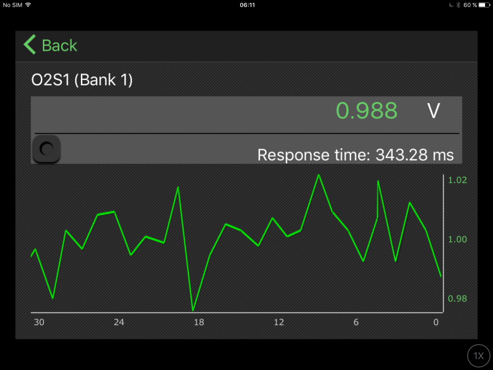

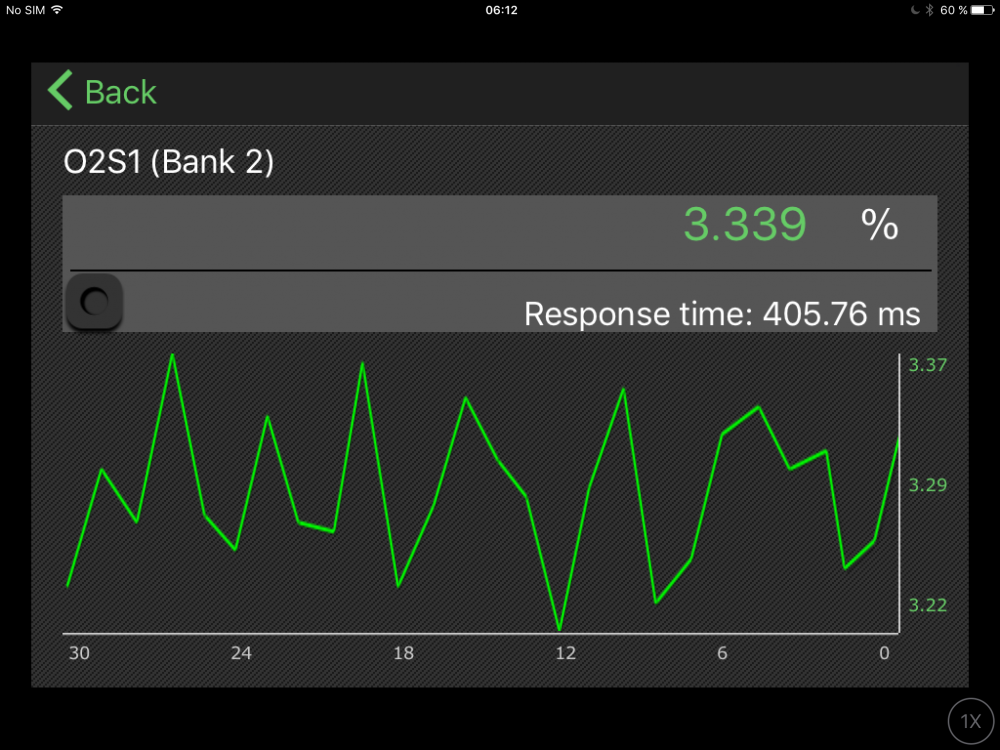

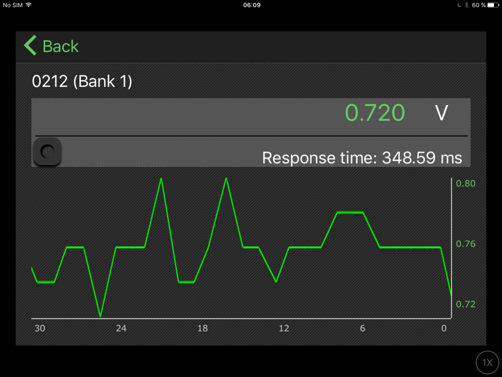

My next worry now are my oxygen sensors. I have watched your videos on your Versux scanner and I saw your upstream sensors are moving from 0.01v to 0.9v. I want to understand more the language this my cheap wifi OBD2 scanner is talking on my sensors. I want to see my upstream moving as yours and my downstream moving slightly also.
Help me arrange the pixs and put what sensor in each pix.
Under the section where you have NOT USED, you said those are downstream sensors that are not responsible for fuel trims so there PIDs are not displayed, so if that is the case then the other two should then be my upstream sensors and they should therefore move between 0.01v to 0,9v, but they are behaving like downstream sensors by moving between 0.72v to 0.9v (0212 bank1), and 0.7v to 0.9v (0222 bank1), and (0212 bank2 in % not used), (0222 bank2 in % not used).
The other section you have two sensors showing in voltage and two others showing in percentages.
(02S1 bank1) 0.98v to 1.02v
(02S1 bank2) 3.22% to 3.339%
(02S5 bank1) 0.98v to 1.02v
(02S5 bank2) 3.21% to 3.34%
Pixs attached

9 years 6 months ago - 9 years 6 months ago #8486 by Tyler
babajis2010 wrote: My next worry now are my oxygen sensors. I have watched your videos on your Versux scanner and I saw your upstream sensors are moving from 0.01v to 0.9v. I want to understand more the language this my cheap wifi OBD2 scanner is talking on my sensors. I want to see my upstream moving as yours and my downstream moving slightly also.
We can help with that! It's easy to see why you're confused about the O2 performance, this data is... weird. :angry:
For one, your upstream O2's are a wideband design, and not a conventional zirconia O2. Your sensors will never 'switch' in the way a conventional sensor will. It's signal output is usually pretty linear, unlike a conventional sensor that'll be constantly going from .1 to .9V. Check out the air/fuel ratio sensor testing thread for more info . Your upstream sensors are of the Toyota four wire design. ;)
This is a little guesswork, but here goes. :silly: The O2S1 Bank 1 and O2S5 Bank 2 voltage PIDs probably aren't voltages, but actually Equivalence Ratio. It's a way of translating the upstream air/fuel ratio sensor signal into terms of lambda. 1.00 represents a stoichiometric mixture, lower indicates rich, and higher indicates lean. The fact that your readings are moving right around 1.00 is a good thing.
The percentage PIDs for both banks are also probably not percentages, but actually the same sensor signal you'd see on the manufacturer data. Toyota sensors use 3.3V to represent stoichiometric, with lower voltages representing rich, and higher representing lean. Here's a sample of data I got off another Toyota. Keep your eyes on the AFS B1S1 and AFS B2S1 PIDs.
Did that make sense? :lol: I think your scanner is throwing you for a loop by mislabeling the data PIDs. Percentages that are actually voltages, voltages that aren't voltages. :angry: Do you have access to another scanner, or different scanner software? It'd be cool to look at the same vehicle with a different scanner, and see those same PIDs with the correct labeling.

I believe I can do a vacuum leak smoke test using this hose in the attached pixs once am done with the throttle body.
The hose is coming from the engine valve cover to the manifold, if I remove the hose from the valve cover end and put smoke in it that should work I guess.

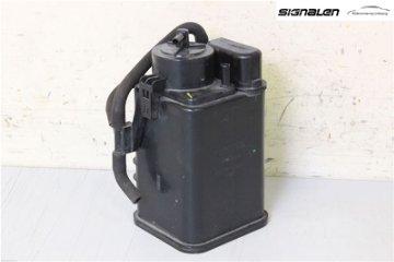

Can anyone tell me what this thing in the pix and it's purpose, and there are 2 hoses sticking out that are not connected to anything.
I want to also clean my EGR valve but I can't locate it in the engine bay, any help would be appreciated.
The picture I am trying to upload is not working but I just found out it's the charcoal canister.

Hi guys please I need an expert opinion on my fuel trims.
My car is not moving as it should for a 2.0L engine and it jerks, and after I changed my CAT and drove on the highway I got P0420 and P0430, and I suspect it's unburnt fuel in the combustion chamber that has got into the CAT, so I deleted the codes like 2 times and it has not returned since.
One thing I noticed though I unbolted my throttle cable from the throttle body because I wanted to check if it retracts as I saw on YouTube, but my mechanic and Toyota guys said it doesn't retract on its own, retraction is done by the lever on the throttle body. So I asked my mechanic to put back the cable for me and immediately after that surprisingly the car was moving so smart and fast as it should but still jerking, then I bought injector cleaner and put in the gas tank and the jerking went away like 60-70% within 30mins or so, and some days later like 90-95% no jerking.
I looked at my other Toyota car and it's correct the cable is designed not to retract, but the only difference I noticed on my other Toyota is that in the drivers side gas pedal you could drag out the accelerator cable little like 2-3mm or so and when you depress the gas pedal it doesn't catch the throttle lever immediately and that car runs like a champ, very fast best gas mileage, infact the gas pedal and accelerator cable respond to perfectly to how much you depress the gas pedal. Now back to the Avensis I need help on, I don't have that kind of 2-3mm play in the acccelerator cable inside the car. I can't drag out the cable at all like I did in my old Toyota, the gas pedal when depressed has no free play, it controls the lever on the throttle body immediately, pls is this accelerator cable adjustment normal.
Now to the fuel trims. I wanted to buy fuel filter from Toyota company but they told me I don't need it, I don't understand why. I looked at my factory service manual and it only talked about fuel filter assy for a Diesel engine 1CD-FTV, please does it mean my Avensis petrol 1AZ-FE does not use fuel filter, I'm so confused because I'm suspecting my problem is fuel system since I have changed to new ignition coils as part of my comprehensive service on this car. Why did the jerking stop within minutes of applying injector cleaner if I don't have a clogged fuel filter and injector. My car idles fine, and after I changed CAT I passed emission CO 0.1 max is 0.5, HC 2 max is 100, why is my HC so low because my other car that works very fine has HC between 18-25
My fuel trims below
Cold start at idle
STFT Bank1 (1.56 to 7.81)
STFT Bank 2 (2.34 to 6.25)
LTFT Bank 1 (-0.78)
LTFT Bank 2 (-1.56)
Warmed engine at idle
STFT Bank 1 (-0.78 to +1.56)
STFT Bank 2 (-0.78 to +1.56)
LTFT Bank 1 (+0.78)
LTFT Bank 2 (-1.56)
Warmed engine at 3500RPM
STFT Bank 1 (-3.91 to -8.59)
STFT Bank 2 (-4.69 to -8.59)
LTFT Bank 1 (-1.56)
LTFT Bank 2 (-3.12)
Please your help is needed my car is not responding well in movement compared to how much I depress my gas pedal. Can a professional scan tool identify the problem with my car considering my fuel trims are not looking all that bad except the increase in STFT at 3500RPM and it consumes fuel. It looks like I will be losing around 100km - 200km for every 60L full tank. Is my STFT negative 8.59 lean or rich condition. My spark plug electrode is spotless white after almost 2000km driven
