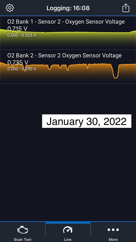

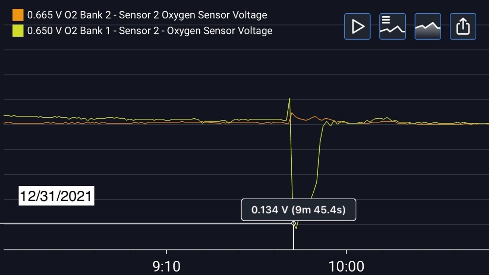

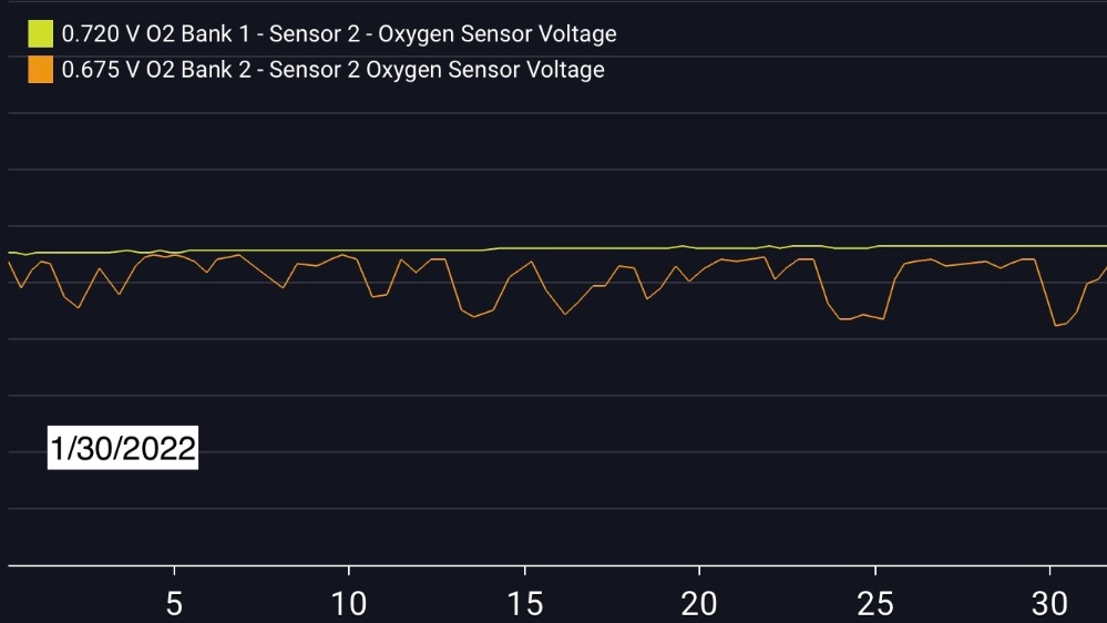

4 years 9 months ago #54110 by gimmick1
I'll post a couple pictures/screenshots from my code reader.
When the misfires were on bank 1, I noticed the B1 downstream o2 sensor voltage would drop low on a fairly regular basis. Then when I had trouble with misfires on bank 2, it seemed only the bank 2 downstream o2 sensor voltage would drop low in the same manner. other days both bank 1 and bank 2 downstream sensor voltages would be relatively flat.
I'm not an expert with fuel trims and proper o2 sensor behavior so I don't know if these readings are anything to be concerned about.

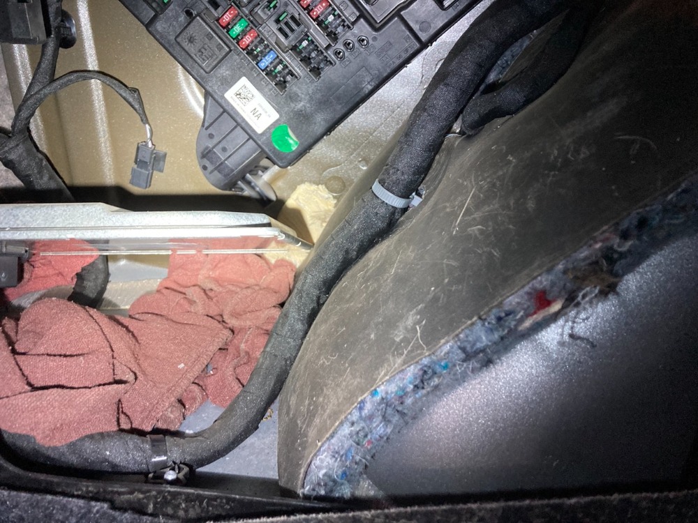

4 years 9 months ago #54148 by gimmick1
I had time today to inspect the harnesses and connectors under the hood including: engine to body harness connector, fuel injector harness, front body harness, power distribution connectors, ABS connector, ECM connectors (all 3) and cleaned all ground studs/ring terminals under the hood. I have some Stabilant 22 contact enhancer and applied that to each connector & ground location.

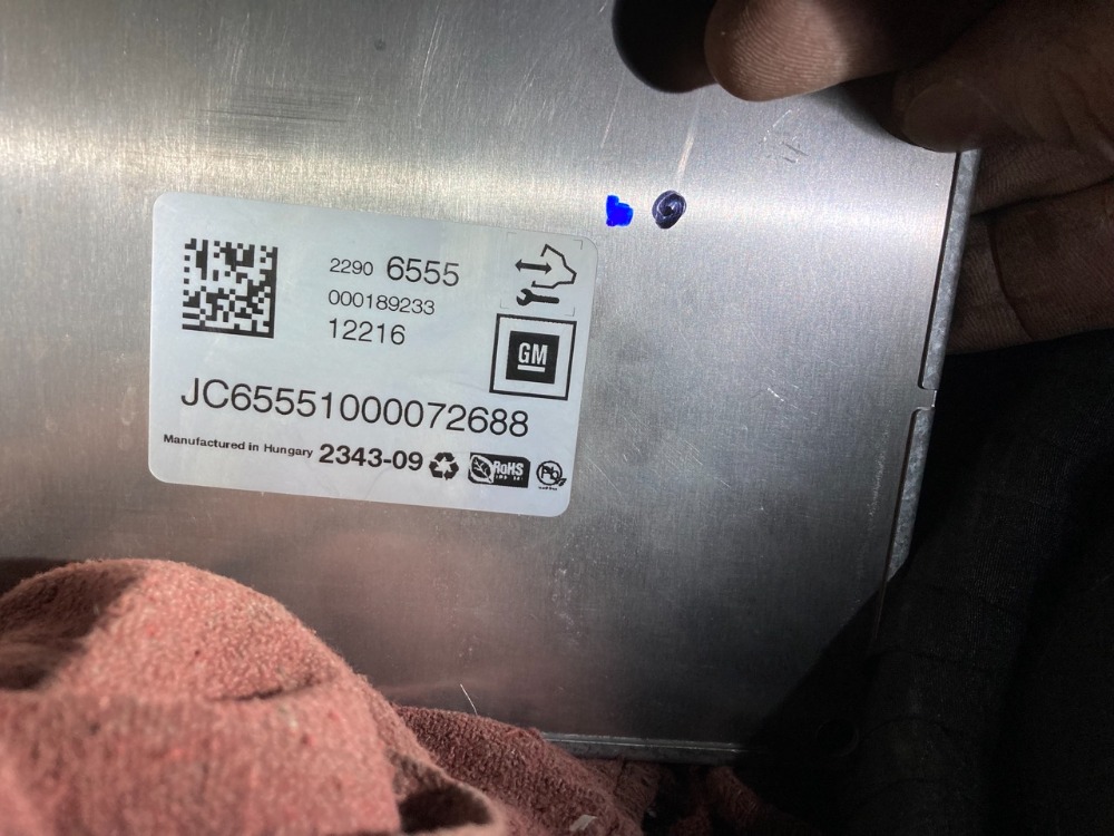

When inspecting the harness connector inside the trunk I noticed the electronic suspension control module (see pictures) is just laying inside the access panel on a couple red shop towels. That's interesting, looks like somebody didn't mount the module and left the towels there to prevent a rattle.
Behind the battery tray/enclosure the body harness was pinched. I opened up the loom, looked at each wire and tugged each wire to see if there was a break in the copper. Everything appeared fine in that location.
I think all I can do is continue to gather data as it happens and inspect the remaining harness as I have time.

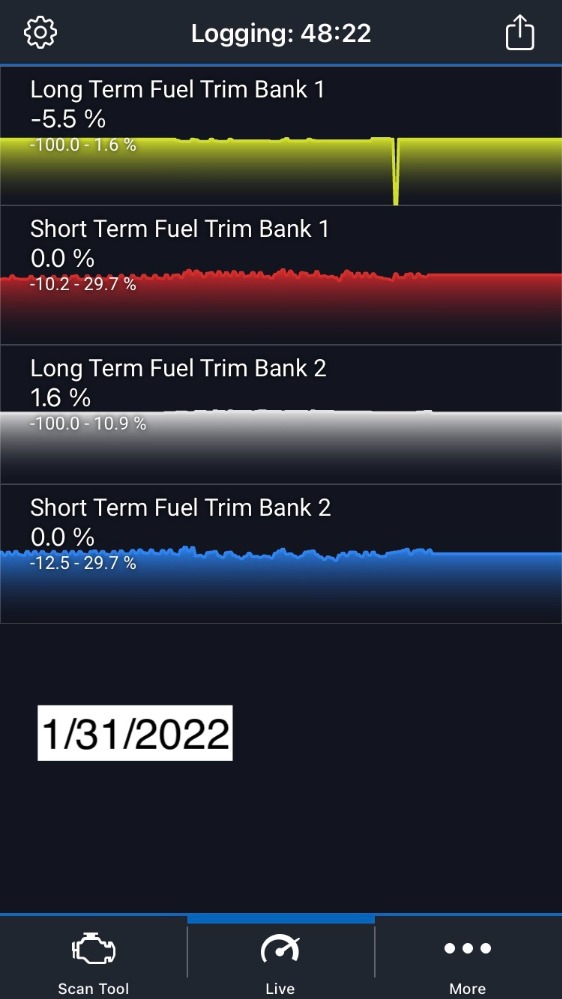

4 years 8 months ago #54237 by 70monte
Your fuel trims look okay. What do your both pre-cat O2 sensor readings look like?

4 years 8 months ago #54307 by gimmick1
Did you look at your wiring diagrams to see if your loss of communication codes are all on the same CAN BUS line?
Have you checked your fuel pressure to verify whether it's in spec? I see one of your trouble codes is indicating fuel rail pressure too low, engine cranking. It might be too low as well when running which could give you misfire codes.
Have you checked power and grounds at the ECM?
Do you have power all of the time at the connectors to the injectors of the misfiring cylinders?
I've been checking the fuel rail pressures and although sometimes it's in the 300-400 PSI range at idle, most of the time it is in the 1,600 PSI range while driving. I think these are good numbers for fuel pressure.
The main PCM ground on the engine is clean and tight with a good crimp on it's wire. I have checked most of the grounds and connectors under the hood but today looking at schematics I can see I missed one ground location.
I'm looking at the All Data schematics today to see if the codes are all on the same Bus.
I haven't been able to catch the misfire happening while at home or work and by the time I arrive, the problem goes away. Except for one day I had misfires on cylinder 2 and I was able to put my (new) spare coil on. The misfire persisted for a little while but cleared up while I walked away to grab my Uscope.

Tyler, I just found a freeze frame report from the December 31 problems. I'll attach it to this reply. The problems that evening were the worst I have experienced so far with this car.
Good stuff, thank you! B)
-Bank 1, sensor 2 is showing 99.2% fuel trim
-Control module voltage is 15.2 volts
-Timing advance for cylinder 1 is 42.5 degrees
All of these are pretty normal, for a variety of reasons. The fuel trim values you see for downstream O2 sensors (O2 Bank 1 - Sensor 2 - Short Term Fuel Trim and O2 Bank 2 - Sensor 2 Short Term Fuel Trim) are completely irrelevant and should be ignored. ;) The value of 99.2% the scanner is reporting is a placeholder value, not an actual indication of fuel correction.
Newer GM's will sometimes charge up to 15.5V if the BCM thinks it's appropriate.
That much spark timing advance on a hot restart with a raised idle isn't unusual.

I noticed the same thing in the Freeze Frame data you posted. Sticking purge valves are very common on this engine, and can definitely cause misfiring on startup after refueling. The Commanded EVAP Purge and the EVAP Vapor System Pressure don't suggest an issue, BUT I've learned from experience that the Vapor Pressure PID in Mode $02 usually doesn't work correctly.
How full is your tank right now? If it's less than half, I'd suggest refueling and going for a test drive. If you immediately start having problems, we're onto something. If not, hey, at least you've got a full tank. ;)

ProAuto,
I'll take your advice and order a used ECM tonight. I've reached that point.
I spent a few more hours on it today checking a couple grounds I had missed last time and also checking the contacts in the 3 ECM connectors. Took it for a drive and had 3 new pending codes show up (MAP sensor, IAT sensor and barometric sensor).
The misfires codes have moved cylinders a lot and the one time I was home while it happened I swapped for a new coil with no improvement. I don't have a borescope and HF is sold out. I'll borrow one from our NAPA store this time and see how things look. It is something I should do from time to time to keep an eye on the carbon problem these engines have.
Thank you for your help.
