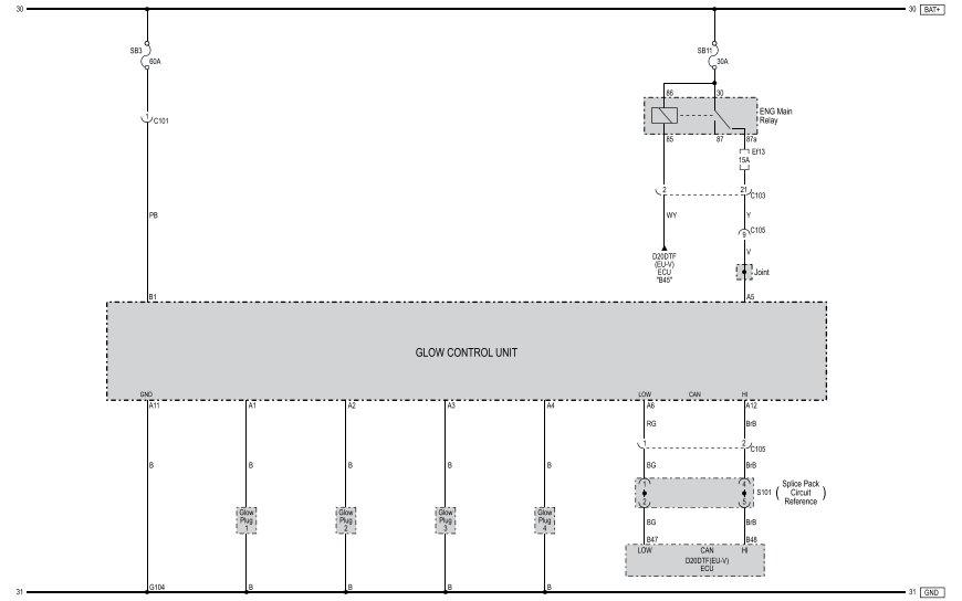

Hello guys, Thanks in advance for your comments.
This SUV came to my shop three days ago and battery has discharged twice. I have issues to interpret wiring diagram.

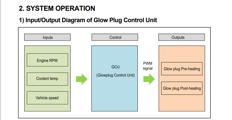

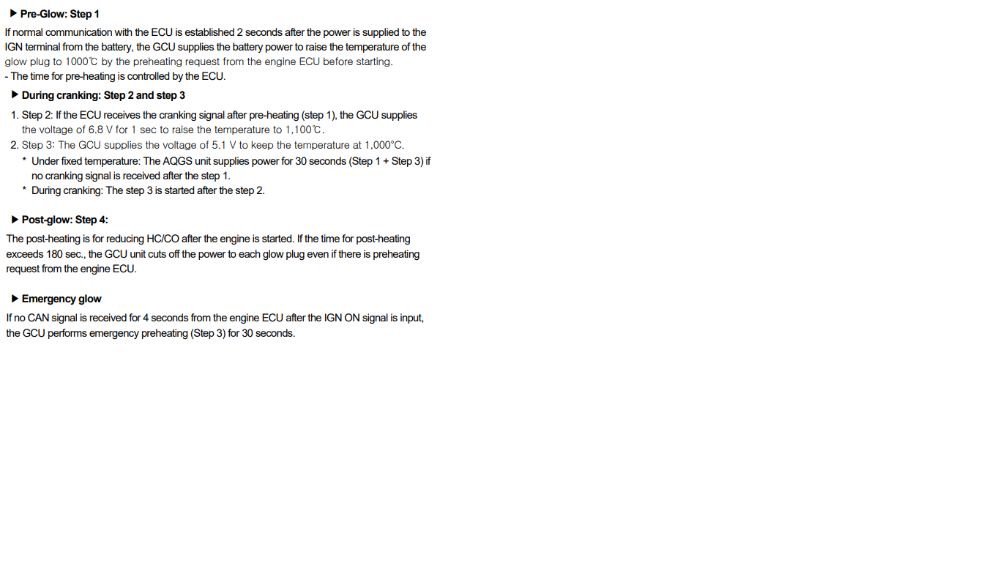

It has a glow plug controller unit (CGU) which is able to comunicate with ECU through CAN protocol. According to description and operation in service manual, they both share information (vehicle speed, coolant temp and engine RPM (see CGU system operation file) to set glow plug voltage and time in three different stages (preheating, cranking and postheating). CGU "knows" when to preheat glow plugs by an ignition signal (see CGU steps file) with a huge amount or current (20 amps) for 2 seconds and then about 10 amps average (PWM) for about 30 seconds.
The fact that is blowing my mind is ignition signal is staying alive all the time and i have evidenced preheating process is happening ramdomly (sometimes is not preheating and heating while cranking and sometimes is preheating with ignition switch off). wiring diagram is telling me ignition signal is "hot all time" (pin 30 and 87a on engine main relay)(contrary to CGU steps which says ignition signal is not alive all time)
There is a connection i don´t understand (please see CGU wiring diagram file, ECU pins B1, B3 and B5) which can be clue in order to know whether ignition signal is "alive all time"
I am guessing the battery is draining that bad because CGU unit is activating ramdomly even with ignition switch off. Any comment would be apreciated.

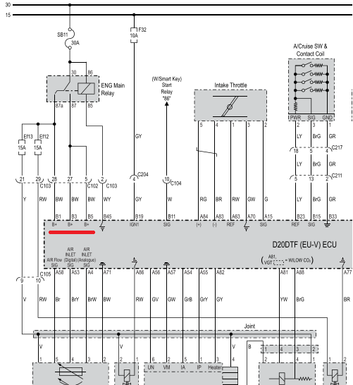

My mistake,
I forgot to post the picture which i´m struggling with (ECU pins B1,B3 and B5)

Hey guys,
A little update. I just took ECU cover off to realize that there is a jumper between pins B1,B3 and B5. So fuse Ef13 (which feeds CGU ingnition signal and other sensor), is always alive (battery voltage) no matter relay is energized (please see ECU wiring diagram).
The second fact is there is no point of having a engine main relay if you have a jumper on pins B1,B3 and B5. I mean fuse Ef13 is hot through relay contacts when relay coil is OFF and also is hot through ECU jumper (pins B1, B3 and B5) when relay coil is ON.
This is so confusing!!

Replied by Matt T on topic 2012 SsangYong Korando C (diesel) draining battery, starting issues and stall
Agree it makes no sense whatsoever as drawn. I'm wondering if the vehicle is maybe supposed to have a non standard main relay which isn't N.C. on 87A. Someone could've installed the problem playing swaptronics........

Thanks Matt for your comment,
Do you mean like "5 pin normally open relay between pins 30 and 87a" or a 4 pin relay (with no 87a pin)?
I confirm you that with a 4 pin relay, GCU ignition signal disapears when ignition switch is OFF.

by Matt T
I meant a 5 pin with 87A N.O. I've done a little digging and found a wiring diagram which seems to confirm it. Guessing you've either got a bad relay which has welded itself closed or someone has installed a regular relay in place of the OEM one.
neon.lofis.net/SsangYong/Service_Manuals/C200/C200_WML_302.pdf

Replied by guafa on topic 2012 SsangYong Korando C (diesel) draining battery, starting issues and stall
Wow i didn´t know that kind of relay (5 pin with no 87a but double N.O. 87). thanks Matt
That makes more sense in order to drain much current. Meanwhile i installed a 4 pin relay and battery voltage has stayed at the same voltage level.
Thanks again.
Thanks again.
