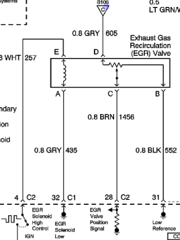

Hey patricktoday! For our reference, this is the EGR circuit on your Park Avenue:
You'll want to take three measurements. All measurements should be taken with the key on but engine off, EGR connector plugged in and backprobed, with the multimeter ground on the batter negative post.
1.) Voltage on the grey wire, pin D.
2.) Voltage on the brown wire, pin C.
3.) Voltage on the black wire, pin B.
Let us know what your results are and we'll discuss the next step.

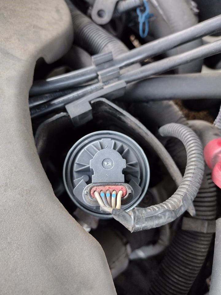

I placed three light blue dots on the wires that were back probed (see picture below)
From left to right the voltages are as follows:
Pin B Black 48.4 mV
Pin C Brown .744 V
Pin D Grey 5.07 V (when I had put everything away and went back into the house I noticed there are 2 grey wires. Did I measure the correct one?)
4 years 9 months ago #54114 by Tyler
Yep, you got the right wires. No worries there.
.74V on the EGR position signal is fine with the valve closed. The signal ground and the 5V reference are good, too. :unsure: How often, and under what conditions, does this code reset? This is the code set criteria for P1404:

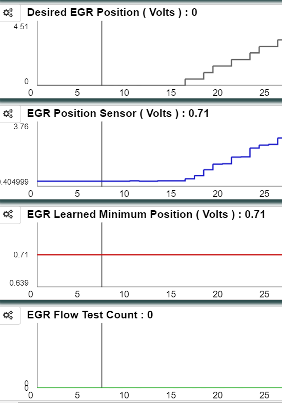

4 years 8 months ago #54247 by Tyler
I now have the BlueDriver module in hand. What are the next steps? What are we looking for with this scanner exactly?
I borrowed this scan data capture from ScanShare as an example of the PIDs you're looking for:
www.scanshare.io/share/0j1mOqdUXEGHqd60-dzlbA#3,4,5,6,7,8,9
We're specifically interested in the EGR Position Sensor volts, and the EGR Learned Minimum Position volts. In the above capture, at the cursor, both values agree when the EGR valve is not commanded open:
Hopefully, the scan data will show a clear difference between the two. ;) Remember that the PCM is looking for a difference of .2 volts or more.
