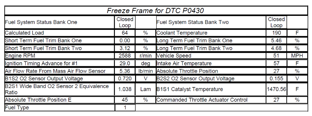

Customer states that the engine cranks extremely long before starting when cold or will not start if quite cold. I don't have ambient temp range but it's not subzero. He also states that it has progressively gotten worse, not an instant onset. It was about 55 F in the shop this morning and upon initial attempt to start it fired, stuttered and died. I immediately cranked again and it fired up almost instantly. I have the following codes:

My initial thought given the symptoms and codes is catalytic converter but it doesn't dog out when I stomp on it, but it doesn't seem overly snappy either. When it is warm it starts up fine. At low idle it has a slight stutter to it. I have freeze frame data for P0430 and some live data snapshots I will try to attach, low idle no load, 3000 rpm, cruising at about 2000 rpm, full load. It's a manual transmission so my "full load" file is with me skipping a couple gears and holding it to the floor.

P0430 Catalyst System Efficiency Below Threshold (Bank 2)
P0300 Random/Multiple Cylinder Misfire Detected
P1604 Startability Malfunction
