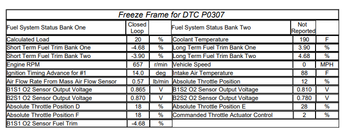

4 years 8 months ago - 4 years 8 months ago #54376 by fixn_junk
Replied by fixn_junk on topic 2008 F250 5.4 misfire codes
Freeze frame data for P0307 last occurrence.
