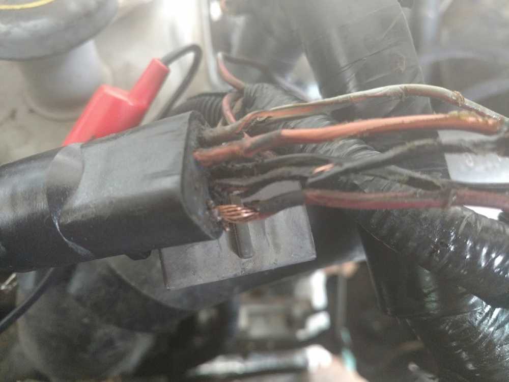

i am believing more and more a short in these wires is very highly likely what TOOK OUT THE FUEL PUMP DRIVER out of my PCM WHERE THE UNCOATED WIRE WAS WRAPPED ROUND THE OTHER WIRE HAD BARED THE OTHER WIRES IN SPOTS AFTER I GOT IT ALL UNCOVERED

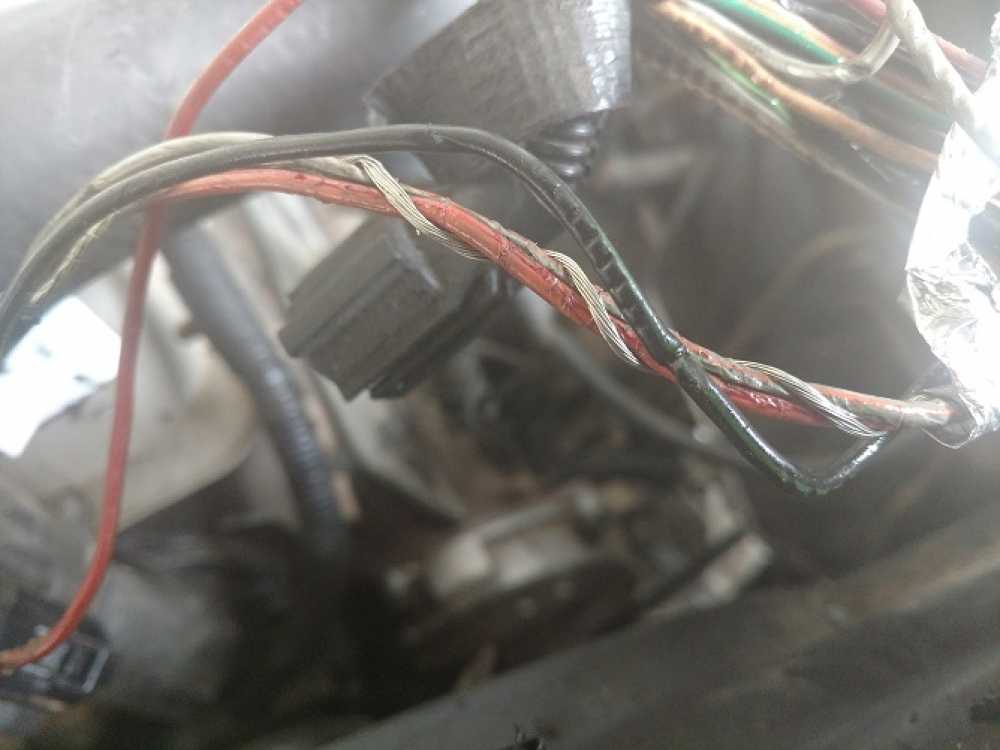

9 years 7 months ago - 9 years 7 months ago #8107 by toadyboy1957
Replied by toadyboy1957 on topic 1996 Ford F 150 4.9 L6
Heres some pictures
Last edit: 9 years 7 months ago by toadyboy1957.
  • toadyboy1957
  • toadyboy1957's Avatar Topic Author
9 years 7 months ago #8143 by toadyboy1957
because these wires were so tightlky bound and the 1 wire had no coating it cut through the other 2 wires it was wrapped around and literally rubbed baren spots in the coated wires IM ALMOST POSOTIVE that is what took out the relay which in turn took out the fuel pump driver in the pcm i have redone all wires and rewrapped all wires in all the harnesses

9 years 7 months ago #8168 by ScannerDanner
Replied by ScannerDanner on topic 1996 Ford F 150 4.9 L6
toadyboy1957 wrote: because these wires were so tightlky bound and the 1 wire had no coating it cut through the other 2 wires it was wrapped around and literally rubbed baren spots in the coated wires IM ALMOST POSOTIVE that is what took out the relay which in turn took out the fuel pump driver in the pcm i have redone all wires and rewrapped all wires in all the harnesses
That looks like some type of shield wire which would be a ground.
Your fuel pump driver is ground side switched. If that wire was shorted to ground it would NOT hurt the driver. Only a short to power would have done that in this case

9 years 7 months ago #8169 by Ben
Replied by Ben on topic Re:RE: 1996 Ford F 150 4.9 L6
I agree that is a shield wire. and from what I remember your relay was drawing 2 amps which would be what took out the driver

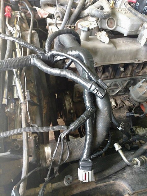

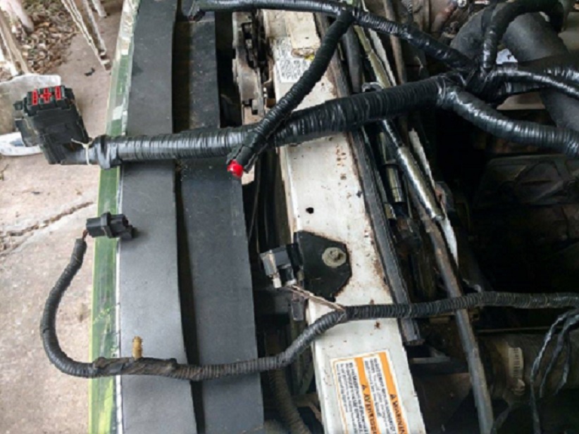

  • toadyboy1957
9 years 7 months ago #8263 by toadyboy1957
The relay was drawing 3 amps b4 i switched relays with the trailer brake relay then was a 300 milliamp draw so i replaced that relay with new 1 and with those wires being drenched in oil led me to deeper search which i uncovered and found quite a few wires minus coating so i got an old harness from and old junker 93 f 150 all same wiring dissassembled that harness and cleaned each wire made sure each wire was good and reassembled my connectors with the good wire and sheathed each section then wrapped each sheath with 10 mill vinyl tape and then wrapped again with black electrical tape // allk of this wiring is like factory now and completely sealed from dirt oil and any moisture // here is a couple of pictures of the finished ptroduct//
THIS IS A FIX
