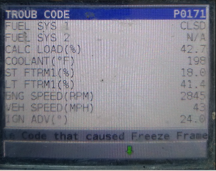

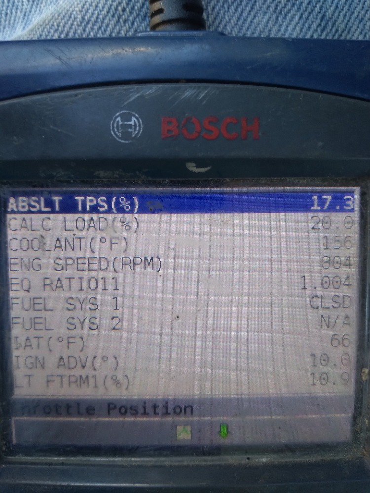

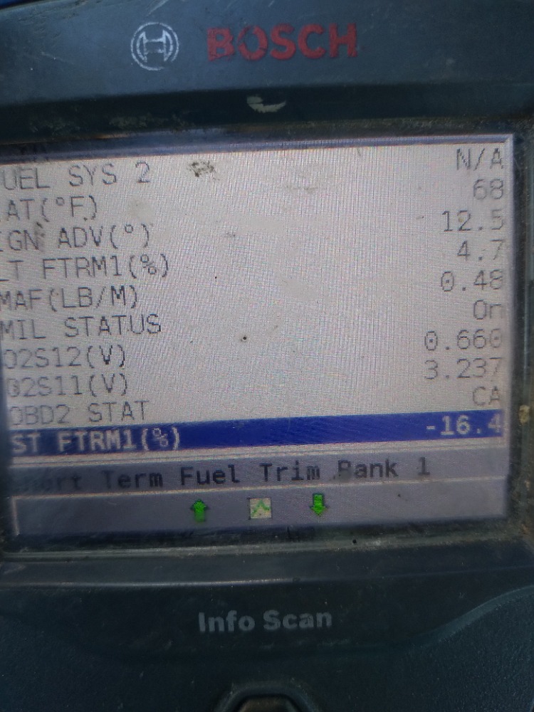

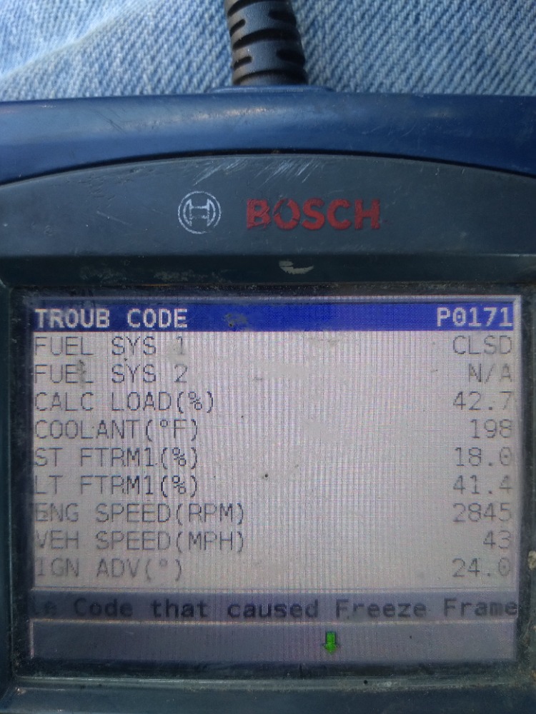

Hey guys I have a 2006 scion tc with a p0171 code for a lean condition but the thing is my stft is between -11 and increases up to -18 at idle but my Ltft is at +8 .when I raise the rpm short term moves closer to 0 as does long term here are pics of freeze frame data and live data

thanks for the response I have checked it and took pictures of both freeze frame and live data at idle will attach them now

Got 'em, thanks. B) The Freeze Frame really stood out to me:
Nearly 60% correction at 43 MPH? :blink: This definitely suggests an under load, fuel delivery issue. If you go for a test drive with the scan tool installed and watching data, can you reproduce this condition?
As Tyler says, fuel delivery problem. At 43mph you're running a total 60% total positive trims. The anomaly of neg STFT at idle could be the intermittent failure of the fuel pump or regulator as examples or the ecm attempting to make a correction. Do some fuel pressure tests. Snap throttle test will show a lot. Any decrease in pressure is what to look for. Is it taking longer cranking time to start.
