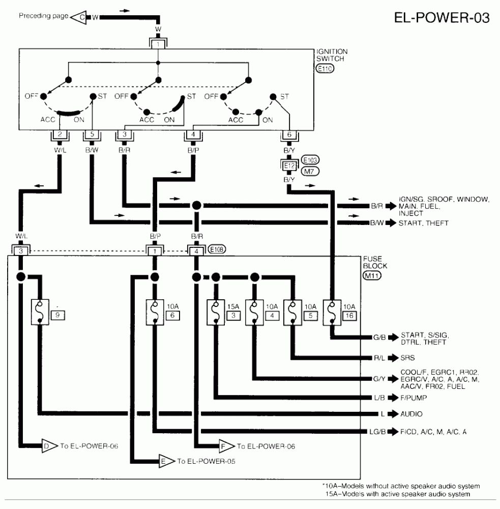

I have a 1999 Nissan Altima GXE that will crank, but not start. However, it will start with starting fluid for a couple seconds, then die. Initial checks performed:
* Fuses checked with multimeter in car and under hood
* no trouble codes
* Compression checked and have spark per above
* Fuel pump, fuel relay, fuel filter, fuel pressure all good
* Fuel injectors ohm out to expected value
* Fuel injector feed wires have expected +12v with ignition on
* Noid light does not come on when engine is cranked
At this point my thought was that it was most likely a computer issue. I did an ohm test between the ground control pin on the fuel injector connector and the car ground. While cranking the engine, the ohm test indicated that the ECM pulse was being sent to each fuel injector connector.
So why wouldn't the noid light work?? Something had to be happening to the +12v fuel injector feed when the engine is cranked. I did a voltage test during engine crank and found that the voltage dropped to a steady +9v reading. To me, this explains why the noid light didn't light up.
I also found that with the ignition off, I had -12v between the fuel injector feed wires and the positive 12v battery terminal. This indicates that when the ignition is switched off, the fuel injector feed wires short to ground. However, the ignition wiring diagram (see diagram at end) shows that the wire that feeds the +12v to the fuel injectors is simply disengaged from +12v positive, and not shorted to ground, in the off position.
My thinking at this point is that the ignition switch itself is the prime candidate for the culprit. I'm basing this on the fact that it shorts to ground in the off position and the voltage drops during crank. The short in the off position isn't 100%. Maybe that's why I just get partial voltage during crank.
I'm seeking advice or insight as to whether I should do additional troubleshooting steps or if you think the ignition switch is the culprit. This is my first post. While not an auto technician, I have attempted to perform every test I could think of before I posted. I also searched here and on Google to make sure I wasn't posting a question that had an easy answer. Please let me know if I haven't followed forum rules or if I left out pertinent information.

9 years 7 months ago #8146 by Ben
I would bet that your voltage dropping while cranking is nothing more than a weak battery and your starter drawing more current than your battery has to give its normal to see 10 volts while cranking what kind of noid light are you using led or incandescent?

9 years 7 months ago #8151 by Andy.MacFadyen
Replied by Andy.MacFadyen on topic 1999 Nissan Altima GXE - Crank, no start
Firstly you have done some very sensible testing
The reason why the injector +12 feed wire appears to drop to groumd is that other loads will be fed from the same supply.
I would also agree 12 volts dropping to 9 volts sounds like a battery in need of charge. A fully charged battery should read 12.5 to 12.8 volts and drop to no less than 10.1 volts or so when cranking.

9 years 7 months ago - 9 years 7 months ago #8160 by borntoroll
Replied by borntoroll on topic Re:1999 Nissan Altima GXE - Crank, no start
What is the current consumtion at fuse 21 (10A) in the dash (that powers fuel injectors) when you turn ignition on but not cranking?
Do you still have ground at injector feed if you remove fuse 21?

9 years 7 months ago #8167 by ScannerDanner
Replied by ScannerDanner on topic Re:1999 Nissan Altima GXE - Crank, no start
I don't think this was done.
Disconnect one injector, test light to battery positive and touch on control wire during cranking. Does it pulse the test light? If it does not. Forget about the low voltage you are seeing on the supply. If it does pulse the test light,
It absolutely could be a supply side issue. The voltmeter is not going to be the tool to use here because of how fast the injectors fire and you may have a larger drop in the feed than what you are seeing with the voltmeter. The alternate fuel source is allowing the engine to start and charging voltage is providing enough increase in voltage to overcome the drop allowing the injectors to fire.
Maybe a better test, backprobed the feed wire, test light to ground (incandescent), crank it, what does test light do?
