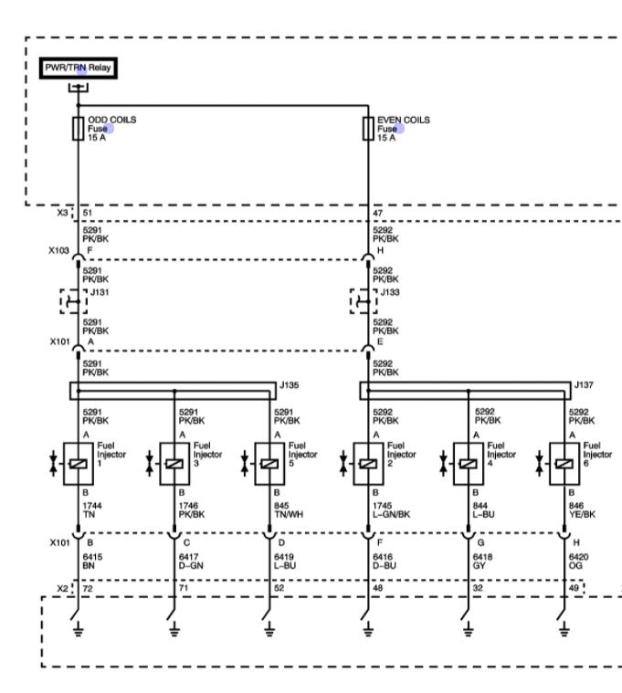

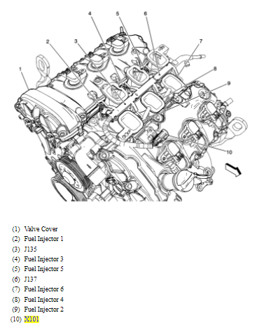

When you do, I'd be interested to monitor the injector power feed when the misfire shows up. The power feeds for the injectors are broken up between two fuses. One for bank one, the other for bank two:
Since the injectors are beneath the intake, you can't monitor the voltage directly. BUT, X101 is out in the open and easy to access. B) See below:

Prior to seeing your last post, I was able to get the customer to drop the car off. I pulled it in the shop and it was running and idling just fine. I let it sit for about 10 minutes and then I grabbed the wiring harness next to the fuse box under the hood and pulled up on it and was able to get the engine to start missing. So the wiggle test proved there’s something wrong with the integrity of the wiring or a connection. I’m glad you pointed out X101 for me. That helps out a lot. I will try and hook up to both banks and get a voltage reading and compare the two when it starts to misfire. The customer purchased this car used two years ago. I did notice the bracket under the fuse box was broken and the wiring harness is not routed correctly. It was kind of just laying all over the place. I was able to repair the bracket but I still suggested to the customer to try and get a used fuse box and engine wiring harness if he can. My gut tells me there was somebody in here trying to diagnose this previously. I also noticed wire ties holding the connections to the computer. A real hack job. Thank you very much for your quick response.
