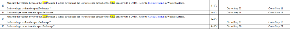

That's interesting. :blink: I got curious about the variance in voltage on the sensor signal wires and dug around in service info. I found this in Crankshaft Position Sensor System Diagnosis:
All your readings fall within the 4-8V range specified. So, IMO, your different signal voltages might be *A* problem but not *THE* problem.

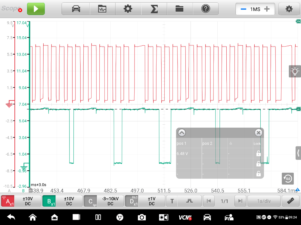

Found this 3.8L waveform in my saved files. It's not 'known good' - the 18X signal has a problem. But the voltage readings are correct. Both signals show 6-6.5V when not pulled to ground by the sensor:

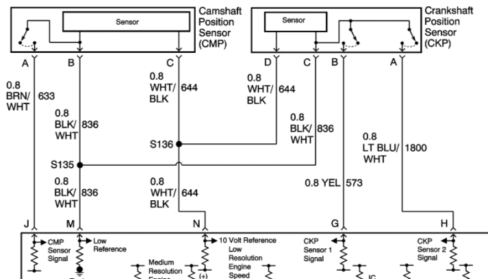

Teach me something here. If the ckp has 6v going in and 6v each going out on each signal wire unplugged and low voltage on each wire plugged in then the ground must be bad as it's constant? Looking at the schematic the ground also goes to the cmp so wouldn't the cmp be effected as well?
Learning from those with knowledge and wisdom. Thanks.
I interpreted his opening post as having 6V on each signal wire, with no readings on the sensor power or ground. But I could have misinterpreted.
That's why I wanted to do some voltage checks - to make sure we're all on the same page, verify the sensor power/ground, AND check for other shenanigans (resistive shorts, replacement pigtails, like that).
If there is a ground problem, then definitely. We may circle back around to a CMP problem? For now, I'm focused on the CKP issue.

The signal wires from the ecm most likely have a bias voltage from the ecm through a resistor. When grounded via the ckp their going to give the square wave signal 6v to 0v. If the power to the sensor is 10v, you must have resistance somewhere along that feed as you said you have 6v with sensor unplugged.
I dislike generic diagrams. The ground switches shown for the cmp and ckp cannot work as shown. Has to have a coil to create a magnetic field to close the switches or transistors. I just have loads of problems with the design shown. I understand the hall effect design. Your engine has cam and crank sensors and reluctor rings to that end but the diagram to me is not representative of that design.

For reference, I'm reposting the CKP wiring diagram:
If we're gonna make a call on this, we need to be clear. What are you voltage readings on each pin at the CKP, sensor plugged in, key on and backprobed? A, B, C, D. Pin position and wire color matter.
If you truly have 6V on A and B, 10V on D and 4.5mV on C, then I'd argue that your latest sensor has failed. Electrically, it has everything it needs to work, and isn't. Pull the balancer and check carefully for coolant intrusion, physical damage, mounting, and reluctor issues like Noah mentioned.
