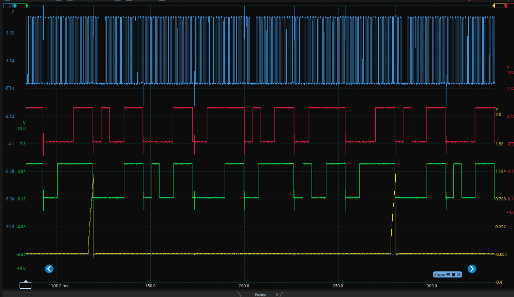

grand cherokee 2014 3.6 laredo cam/crank waveform need it?
- Electricsanti22
- Posts: 14
4 years 8 months ago #54525
by Electricsanti22
grand cherokee 2014 3.6 laredo cam/crank waveform need it? was created by Electricsanti22
if somebody could get it please
- Posts: 2223
4 years 8 months ago #54526

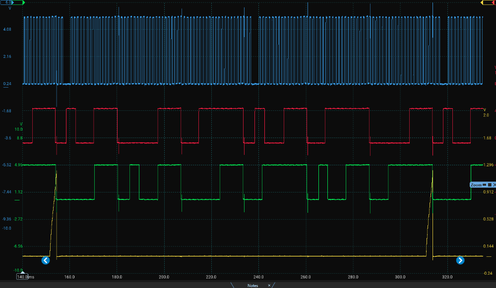

Replied by Chad on topic grand cherokee 2014 3.6 laredo cam/crank waveform need it?
2011 Dodge Journey 3.6L
Bank 1
Bank 2
Files:
Bank 1
Bank 2
Files:
- Electricsanti22
- Posts: 14
4 years 8 months ago #54552
by Electricsanti22
Replied by Electricsanti22 on topic grand cherokee 2014 3.6 laredo cam/crank waveform need it?
thanks my friend iam getting a p0017 code with no symptoms i can tell but code is ramdomly coming, you think tha i should disregard timing or my aproach now should be an electrical issue, cam phaser, wiring
- Posts: 2223
4 years 8 months ago - 4 years 8 months ago #54561
Have you Checked your Oil Level? Can you post the .psdata file of your cam/crank?
Last edit: 4 years 8 months ago by Chad.
- Electricsanti22
- Posts: 14
4 years 8 months ago #54724
by Electricsanti22
thanks brother the problem was one of of the phaser connector was connected backward and bad spliced really dont know why it was cut to start with, but tha is a parts changer lifestyle.
