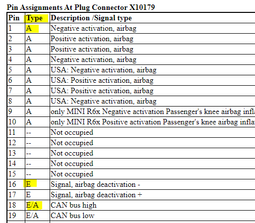

Hi, just signed up to Mitchell DIY for information on my Mini Cooper, while the organization of the information is not great it sure beats having no information. Alldata looks nicer but their DIY service does not include BMW/Mini for some reason. Anyhow, when looking at the connector pin assignments page on Mitchell I noticed there is a column labeled 'Type' with designations such as 'A', 'E', etc. I would guess that this indicates what type of signal that is, i.e. a switched ground source, a sensor input, etc. but I can find no table that explains these codes.
I have been able to infer what some signals are, for example when testing the aux coolant pump yesterday it was obvious from the wiring diagram that there was a share +12V feed to several devices so the ground supplied by the computer must be a switched ground. For the feedback line form the pump I can't tell what sort of signal I should see there so I'm hoping that these 'type' codes will provide more information. In this case it was not important as the pump was open circuit internally and I was getting an open circuit code (and powers/grounds at the pump were good).
I did send Mitchell a question about this but thought I would ask the pros here who might use Mitchell too in case it takes an age for Mitchell to respond.

No idea so I googled "bmw type wiring a or e or m" lol.
www.bimmerforums.com/forum/showthread.ph...signal-type-question
google to the rescue

Well now I feel silly. I had 'assumed' this was a Mitchell convention not a BMW one.
