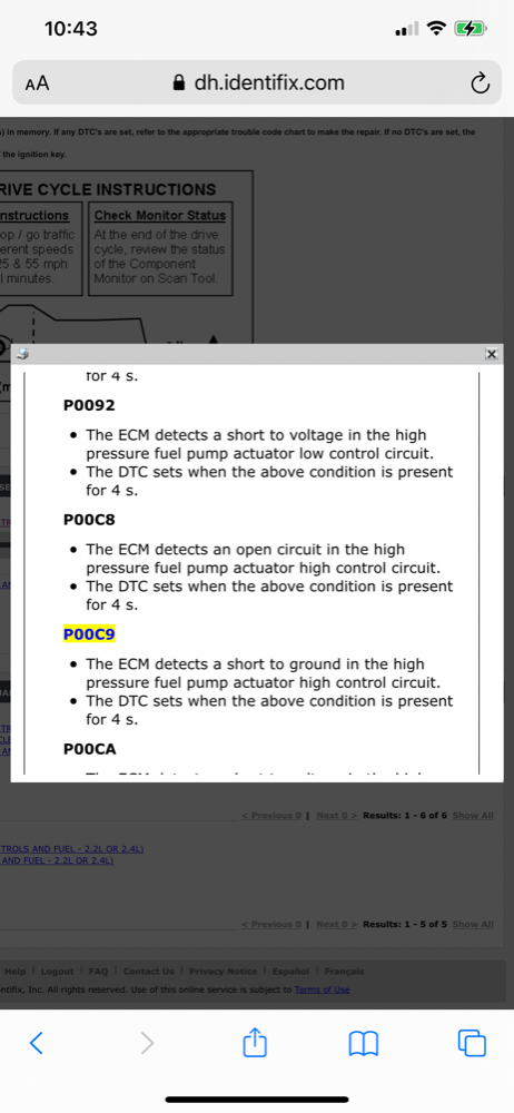

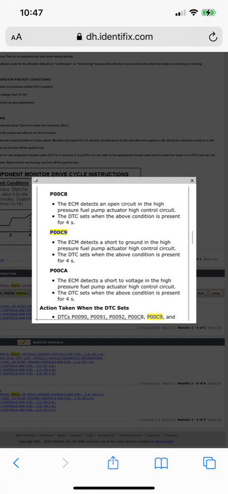

Vehicle is 2010 equinox, 2.4l
Codes are p0092 and p00c9
Fuel Pressure Regulator 1 Control Circuit High and Fuel Pressure Regulator High Control Circuit Low Voltage
Have tried multiple high pressure pumps and a new pcm. It’s a 2 wire system power supplied by pcm and ground is pwm also pcm controlled. Where would you guys go next?

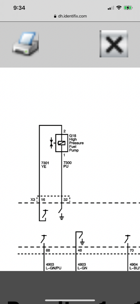

Thanks for the quick response, above I attached the wiring diagram, the codes are circuit codes unless I’m looking at it wrong the low pressure side should not effect this, if anyone has any ideas I would entertain anything!

Diagram did not attach... I was thinking you were posting a new diagram
I really dislike those generic diagrams.
The fuel pressure sensor sends it's signal to the pcm which controls the high pressure fuel pump circuit on and off.
