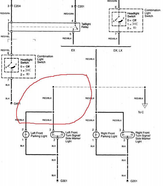

Here's a link to the courtesy lights diagram, from BBB Industries . Let me know if this works.
drive.google.com/file/d/0BwIz-f3J815JWXp...Zlk/view?usp=sharing
IMO, the rear lights are the most suspect, so I'd suggest going there first. Keep your eyes open for melted connectors and wiring. Everything up and to the bulbs themselves is suspect. Also, check out the top of the second page, C554. That's the power feed to all the rear courtesy lights. If we can ID and unplug that connector, and the short goes away, then we can be pretty confident the short is in the rear.

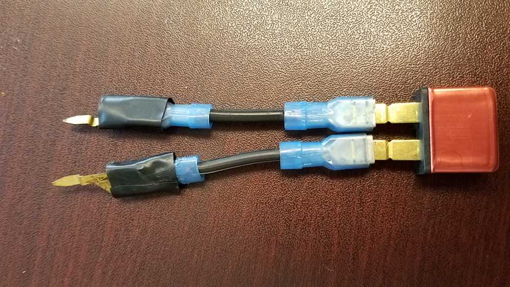

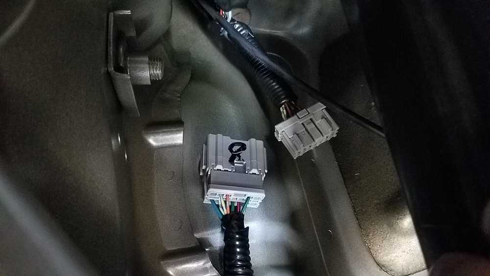

Is this the C554 connector? I unplugged it and fuse still blows (I actually made a jumper)
  • jjgarcia
  • jjgarcia's Avatar Topic Author
9 years 7 months ago #8226 by jjgarcia
Is this the C554 connector? I did unplug it and fuse still blows (my jumper)

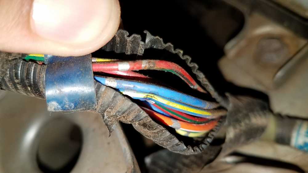

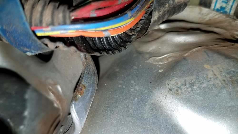

I found the culprit!!! A wire harness (red wire) under the air filter box was pinched and touching metal.
Thanks Everyone for ideas and input.

I ended up picking the right diagram for fuse #10, and I believe you were looking at C554. That the breaker kept popping after you disconnected it makes sense since you found the short up front. Nice job on the breaker, by the way. ;)
Is that the red/black wire burned through? Since you found it under the air filter box, I'd suspect that wire is actually in this area on the diagram:
