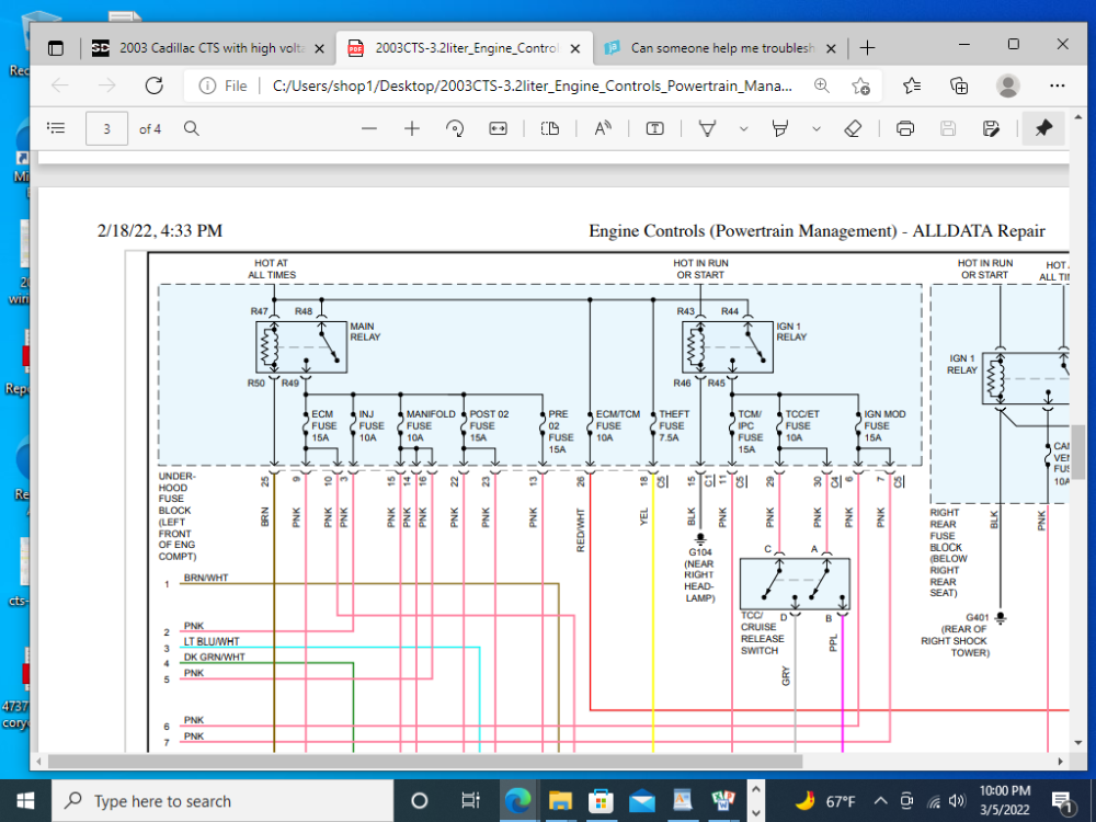

since the ground lines voltage is about 8.5 v at each of the sensors: MAF, ECT, and CMP, and I had the bad wires that were shorting just below the MAF, I assume there is a short to power on the 12 v (line 2 on the MAF). So I found the supply line for this power feed, and disconnected it at the fuse box (under hood), I also disconnected the other end of this red line at the MAF --and then I bypassed the red MAF wire (line 2 on the MAF) with a 12 volt feed to the MAF. I still get high v on the ground lines all around (rats!). When I pull the 12 v supply line off the MAF, then the ground lines (mostly tan lines) drop from about 8.5 v to about 5 volts. The screenshot shows the fuse box and where the power feed originates (ECM fuse pink at 10 )

CMP also has a 12v feed... pink wire from fuse block that's pin 10... MAF is pin 16 of the fuse block. That's the under hood fuse block shown in the picture not the ECM.

Yes, my bad on mixing up the fuse numbers. You are correct, the MAF pin 2 red line is power from pin 16, called Manifold -10 amp on my fuse box. I tried taking this Manifold fuse out and the three ground lines (ECT, CMP and MAF) still had high volts, about 8 v. So i used an ohm meter and determined which line from the fusebox connector went to the MAF. When I found this i bypassed that line by disconnecting it (depinned it) from the connector and ran a new power feed line to the MAF pin 2. I thought that would eliminate my short to power, but I still saw high volts on those ground lines.
