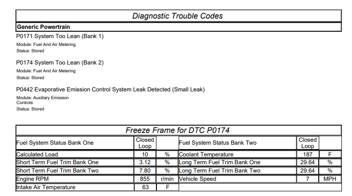

4 years 8 months ago #54653 by fixn_junk
2004 Toyota 4Runner 4.0 Running Lean was created by fixn_junk
This thing is running way lean. At idle long term trims on both banks are running at 29.64 and short term around 5 on bank 1 and around 8 on bank 2. At 2000 rpm the short term trims go to around 0 with the long term just beginning to come down. At 3000 rpm the short term trims go slightly negative to around -2 or so and the long term trims come down to around 22. At 4000 rpm the short term trims stay around -2, -3 and the long term trims come down to around 11. Under full power brake the short term trims go to 0 and long term to 2 or 3. Both banks stay pretty well balanced. Mass air sensor is new and seems to be functioning properly. Everything I have read suggests a vacuum leak but I cannot find one. I have smoked this thing and have found nothing. I hosed it down with brake cleaner with absolutely no change in the short term trims. It runs fine and does not seem to lack power, It responds well to a throttle snap and the trims all usually go to 0. I don't pick up any misfires on any cylinders at all. The fuel pressure holds at 42 and does not drop. I'd appreciate any thoughts on this as I am not very good at diagnosing this sort of thing yet. It's also only the second Toyota I've worked on.

I am unable to attach documents for some reason. Here is some of the data I pulled:
Key On Engine Off
Calculated Load: 0%
MAF: 0.65 g/sec
STFT B1: 0
LTFT B: 29.64
STFT B2: 0
LTFT B2: 29.64
B1S1: 3.303V
B1S1 Equivalence Ratio: 1.001 Lam
B2S1: 3.305V
B2S1 Equivalence Ratio: 1.002 Lam
B1S2: 0.035V
B1S2 Fuel Trim: 99.06
B2S2: 0.015V
B2S2 Fuel Trim: 99.06
Low Idle
Calculated Load: 12%
MAF: 3.00 g/sec
STFT B1: 3.9
LTFT B1: 29.64
STFT B2: 7.02
LTFT B2: 29.64
B1S1: 3.319V
B1S1 Equivalence Ratio: 1.008 Lam
B2S1: 3.344V
B2S1 Equivalence Ratio: 1.008 Lam
B1S2: 0.115V
B2S2: 0.075V
Wide Open Throttle 1st Gear
Calculated Load: 78%
MAF: 164.35 g/sec
STFT B1: 0
LTFT B1: 2.34
STFT B2: 0
LTFT B2: 3.90
B1S1: 4.997V
B1S1: Equivalence Ratio: 1.117 Lam
B2S1: 4.997
B2S1: Equivalence Ratio: 1.234 Lam
B1S2: 0.015V
B1S2: Fuel Trim: 99.06
B2S2: 0.00V
60 MPH
RPM: 1853
Calculated Load: 22%
MAF: 17.46 g/sec
STFT B1: -2.34
LTFT B1: 22.62
STFT B2: -1.56
LTFT B2: 23.40
B1S1: 3.308V
B1S1 Equivalence Ratio: 0.994 Lam
B2S1: 3.270V
B2S1 Equivalence Ratio: 0.998 Lam
B1S2: 0.585V
B2S2: 0.465V
I realize this isn't the ideal way to show data but as I said, it won't let me upload attachments right now and I haven't figured out how to get recorded data to a graph in Auto Enginuity.
4 years 7 months ago #55017 by Cheryl
Replied by Cheryl on topic 2004 Toyota 4Runner 4.0 Running Lean
Can you get us engine rpm at wot we need iat engine rpm maf g/s it looks way lean with the front O2 sensors going over 4 volts in first gear w.o.t.

4 years 7 months ago #55021 by Cheryl
Dead head to see what your fuel pump can put out max pressure. Toyota is known for injector problems becoming restricted
4 years 7 months ago #55022 by Cheryl
That first gear pull you did caught my attention. All 4 O2 sensors are lean. Rears are near 0 mv fronts over 4 volts.
