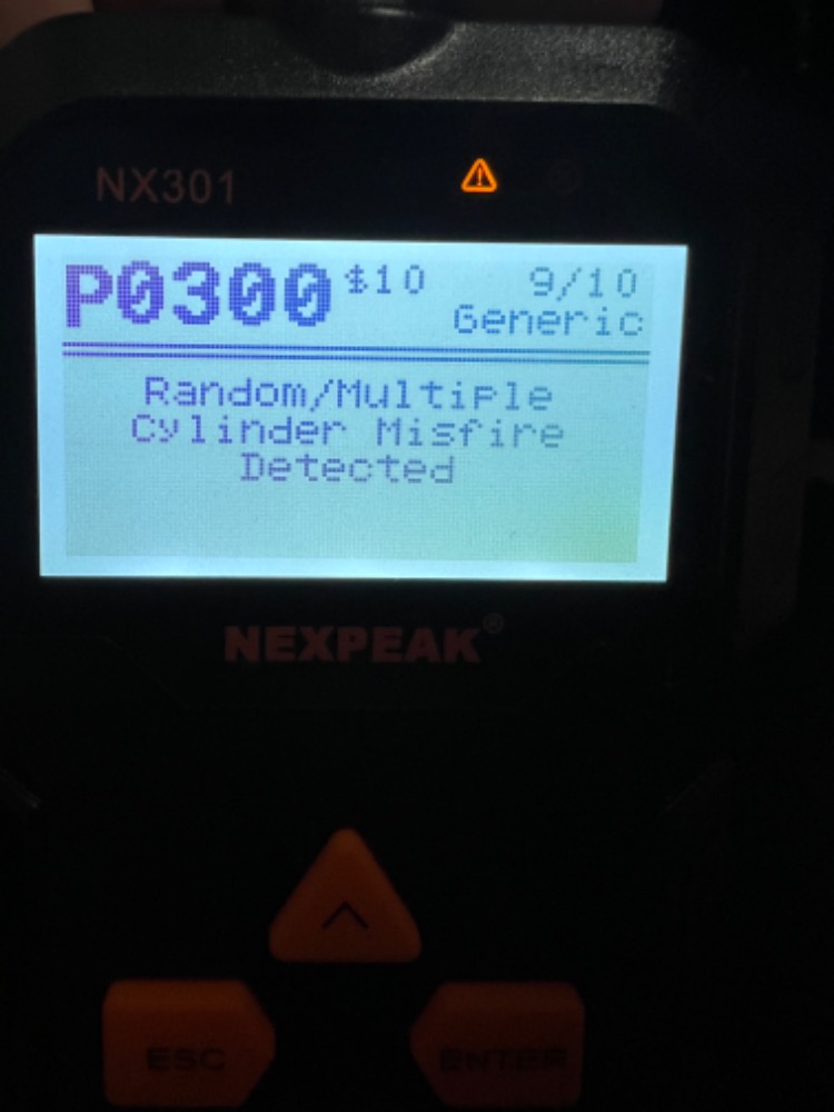

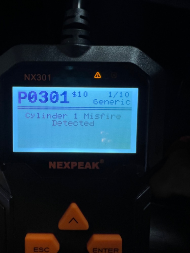

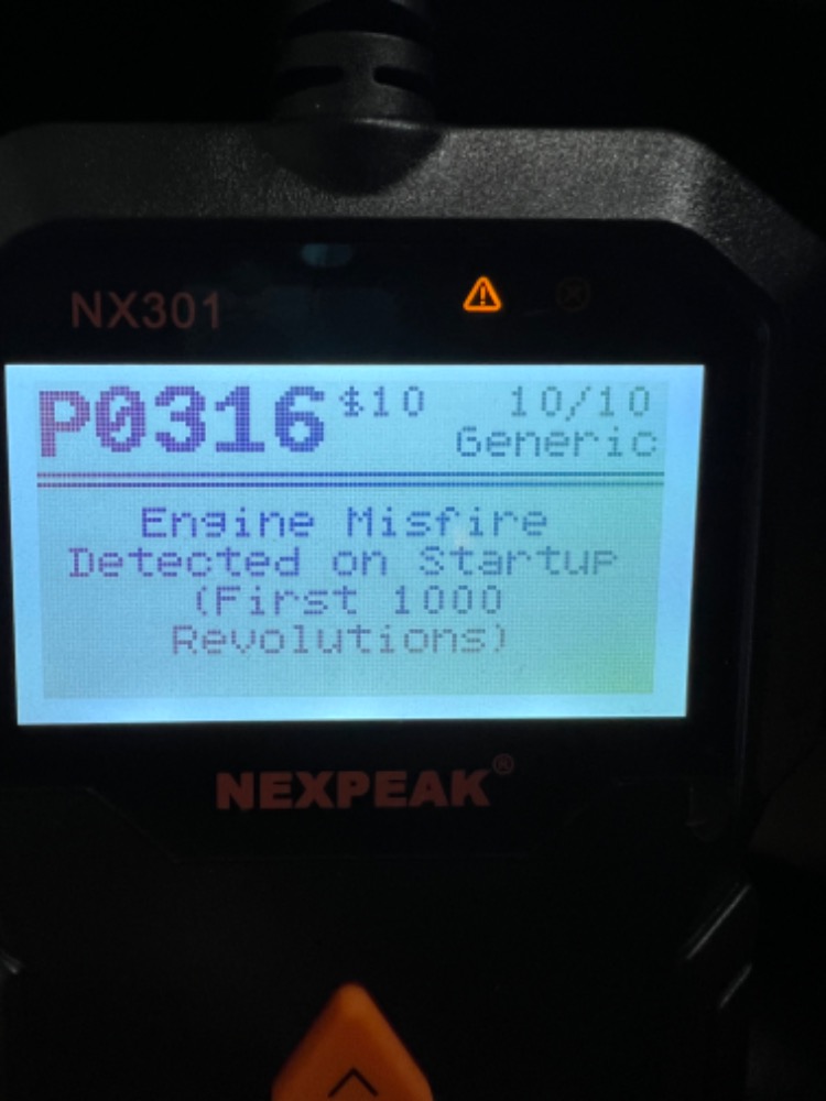

An update. My mechanic friend had me jump it to make sure it wasn’t the battery. Next we sprayed carb cleaner into the intake prior to the throttle body and it fired, ran horribly and would stay running without me stepping on the gas. Dies without it.
Next he suggested that maybe when I lifted the manifold it allowed water/coolant into the cylinders, fowling the plugs.
Suggested that I pull the plugs, crank it and blow everything out of the cylinders. The put new plugs in. I did that and it ran slightly better but still misfires constantly.
I attached pictures of the codes.
Misfires in all 8 cylinders.
My friend says the next step is to remove the manifold and see where it’s leaking into the cylinders.
Thoughts?

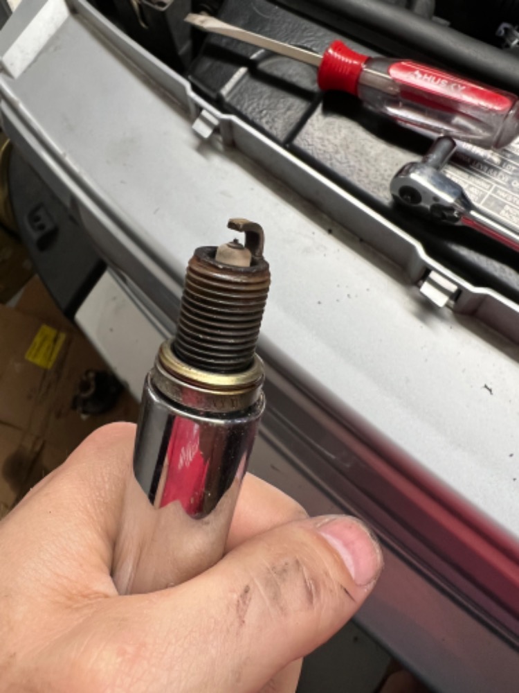

4 years 7 months ago #54869
Replied by Andy.MacFadyen on topic LR3 Crank No Start
Misfire at idle that smooths out at higher rpm makes me always want to do a compression test,
Although you have now changed the spark plugs the old spark plug in the picture had a massive gap this could have damaged the coil secondary insulation
You also really need to use a scantool that will read live data, particularly the short and longterm fuel trims for both banks.
