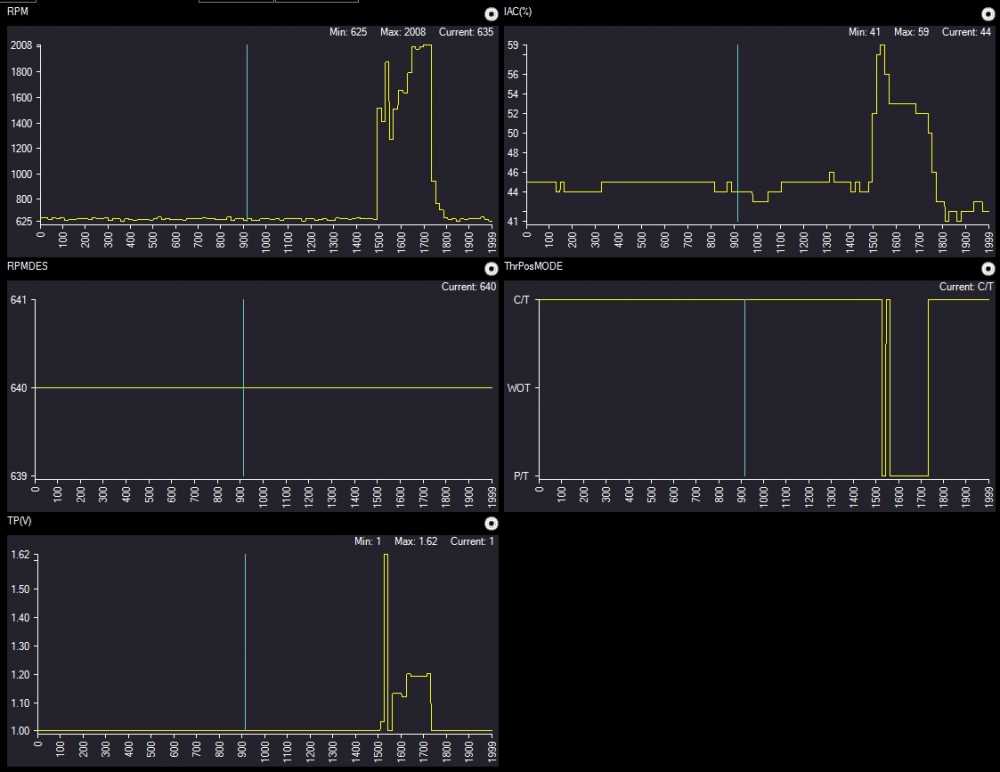

9 years 7 months ago - 9 years 7 months ago #8247 by Tyler
Replied by Tyler on topic tps voltage
ScannerDanner wrote: Disconnect the IAC electrical connector and set your min idle speed first, then recheck TPS closed position. You also may want to do a battery disconnect when your done.
As I said in that YouTube comment, Ford TPS closed throttle voltage is usually around 1 volt.
Sage advice right here. Ford uses a 'ThrPosMODE' PID, which is based entirely on the TPS reading when the key is turned on. If you change the idle speed OR the TPS without relearning this PID, the PCM will think you're off idle at all times, and never idle right.
